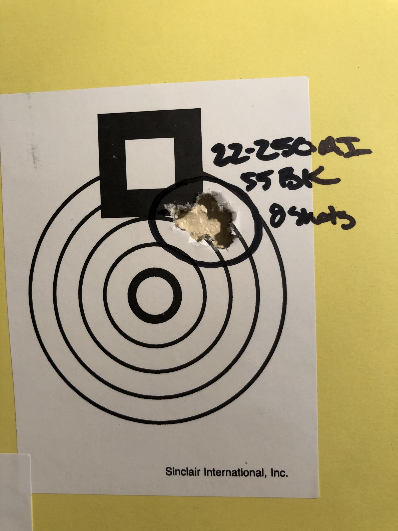

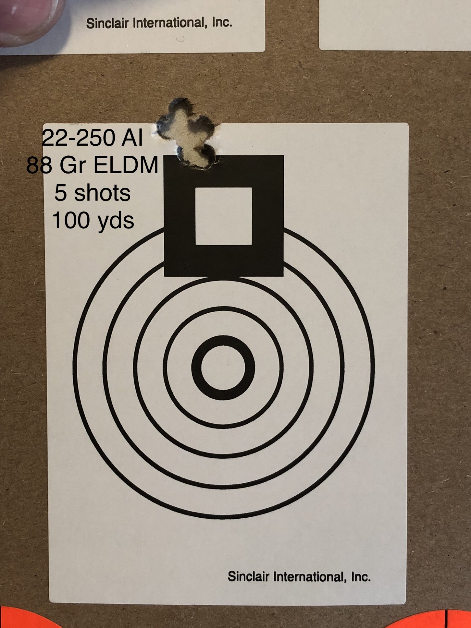

I’ve got one as well - 22-250 AI. No complaints here and would definitely consider another one.

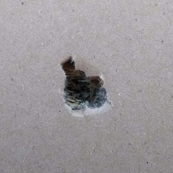

3 shots mulched a 1/2" sticker at 100 yards. Well worth the money. 100% will buy again.

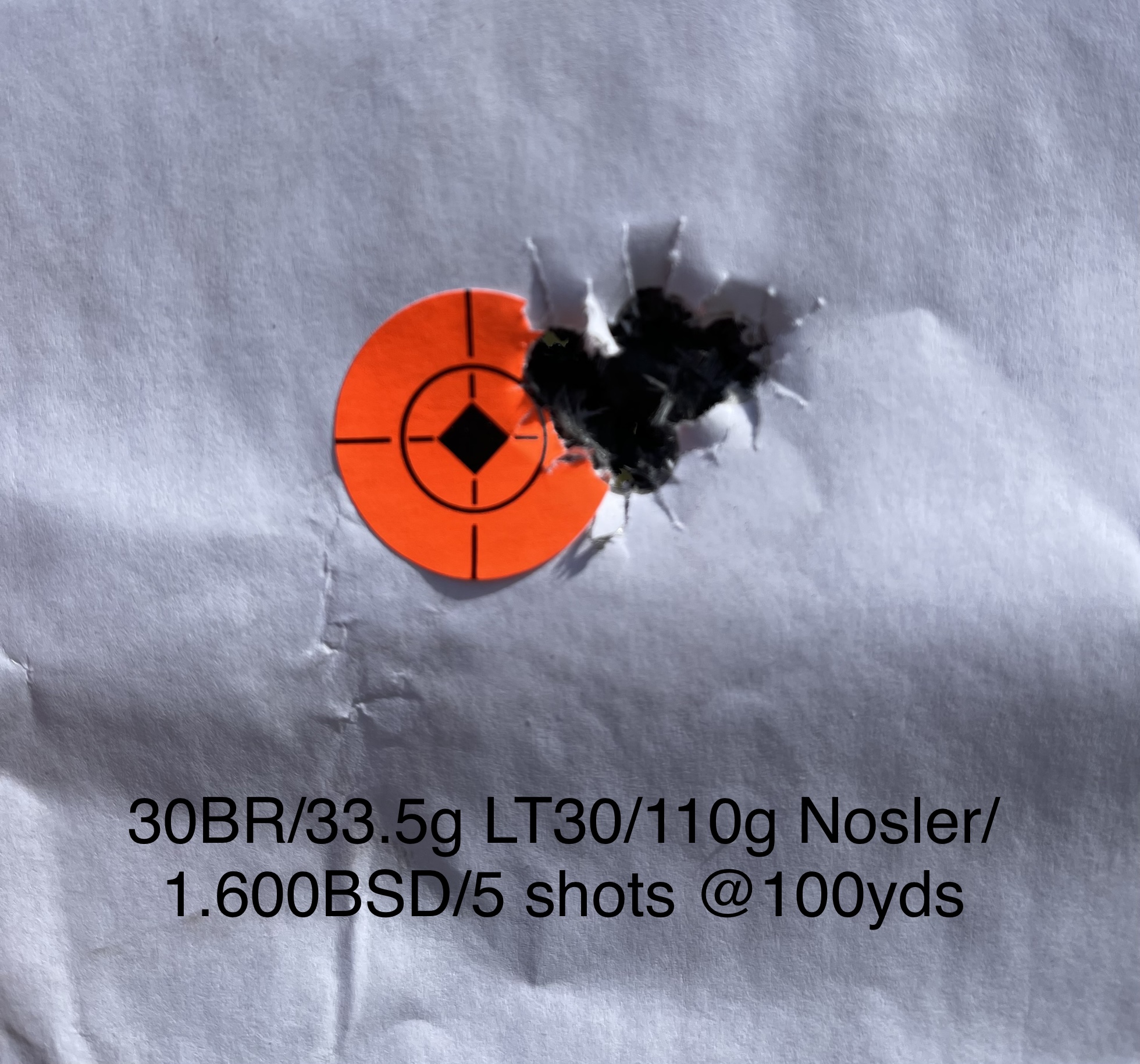

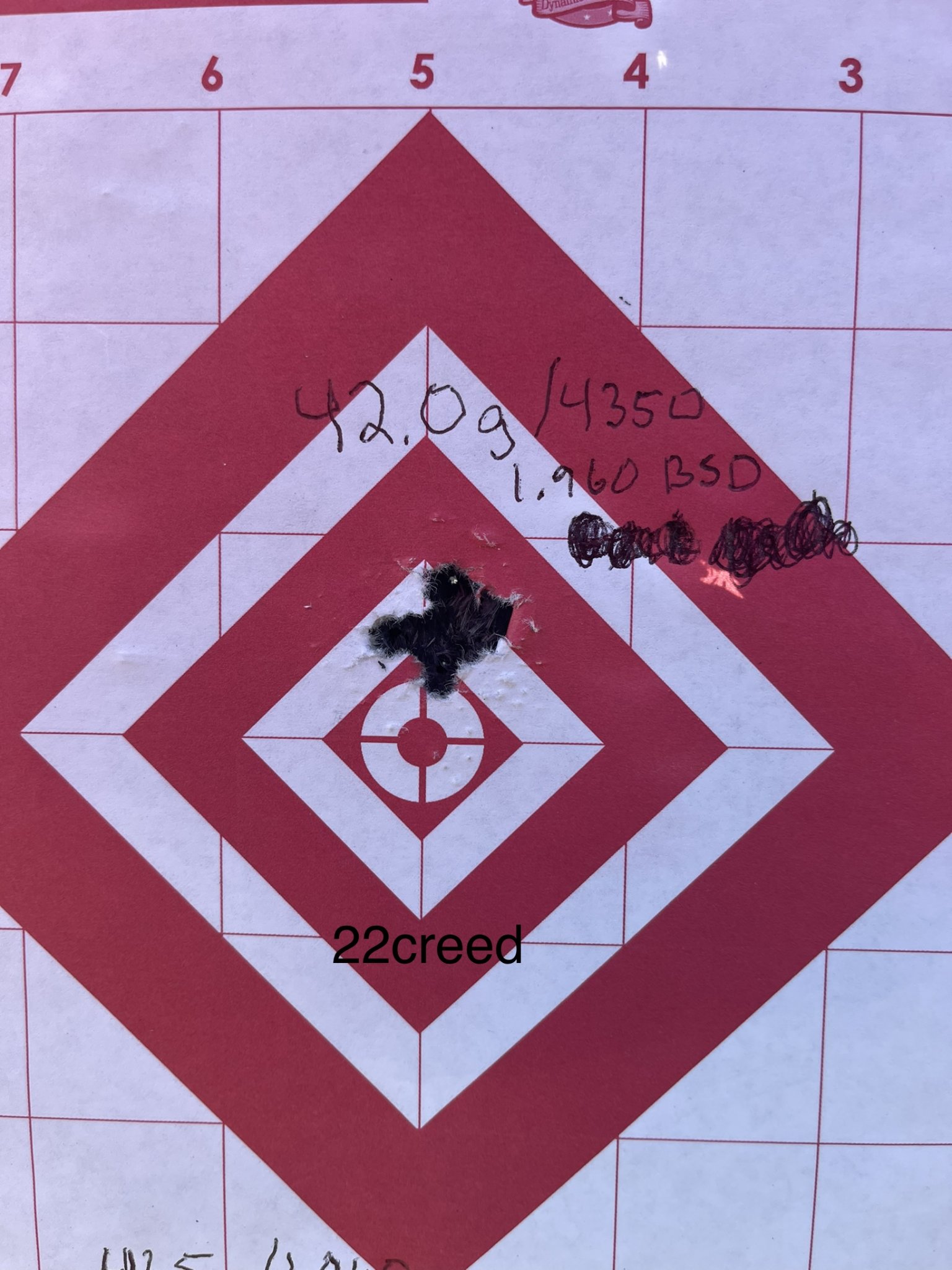

I have two of their barrels and both are varmit rigs. 16” 5R 1-8t 22creed and a 18” 5R 1-17t 30BR. Both have held 1/2” or so if I do my part.
