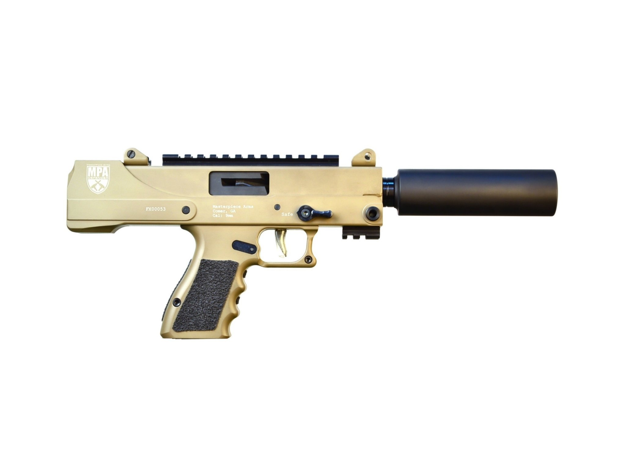

Not gonna lie, the Defender pistol in 9mm is tempting. Gonna keep it under the seat of my 64 Impala, just incase I catch a fool steppin.

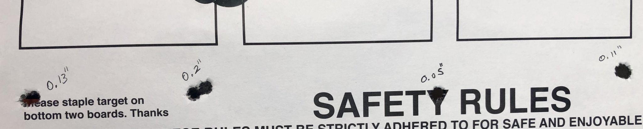

Did some partial load development yesterday for my MPA at 100. Just looking for a flat spot in the speed vs powder charge graph. RL-16 and weight sorted Hornady 135 A-tip bullets in neck turned and sorted Lapua cases.
Never seen such small groups during load development:
RL-16 from 40.0 to 41.6. Aiming for the corner of the black square just above the two shot “group”. From 0.05” to 0.2” center to center. I realize some of them look like single bullet holes, but i promose there are two bullets through that tiny 0.264+0.05” hole.
Ideal BR-like setup might have helped here: Enhanced Bag Rider installed, shooting free recoil off big heavy sandbags from a good bench. Squeezing the rear bag which is huge and filled with heavy chromium sand. Stable bench, and nobody around me, with little wind (5-7 mhp) from the 4 o’clock position. Cannot ask for more.... other than a $1500 front joystick rest.
I realize a single two shot group does not count... but wow that was a surprise. I normally see groups open up and close down again as powder charge goes up. For me this result is not at all typical. [I am not a BR shooter, just ‘appropriating‘ some of their equipment and techniques for bench work.]
