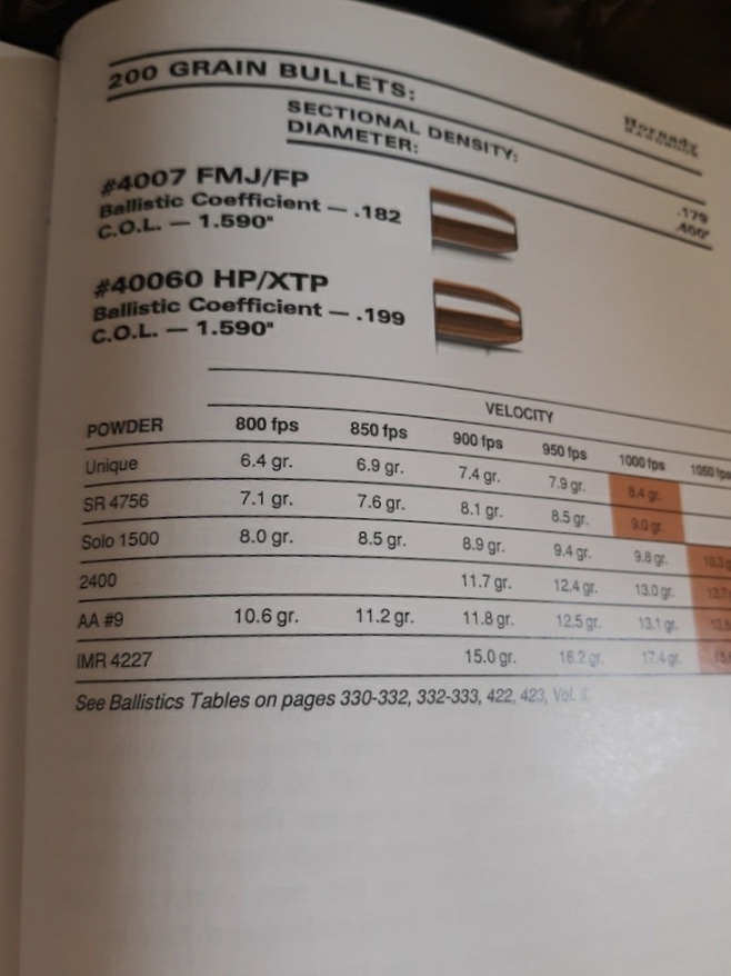

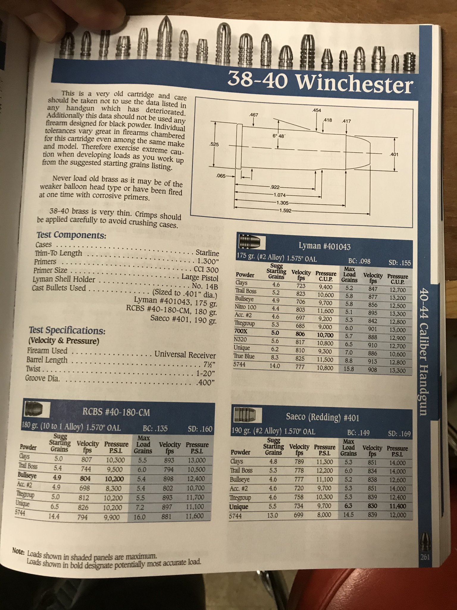

I looked thru some of my older manuals with no luck either. I did find this in my Lyman cast manual. Hopefully it will give you some guidance or at least confirmation on what you already are calculating.
I load for .44spl a bunch, and have been back and forth about getting an old Winchester in 32-20 or 38-40 “just because”. They are neat old guns. I read the post on your recent road trip and acquisition and my brain started toying with the idea of searching for an older shootable SAA like you found. That’s one of the few pistol action types I have never owned. Anyhow, keep posting stuff on it and help me spend money ok? Hope the below helps. Cheers.
