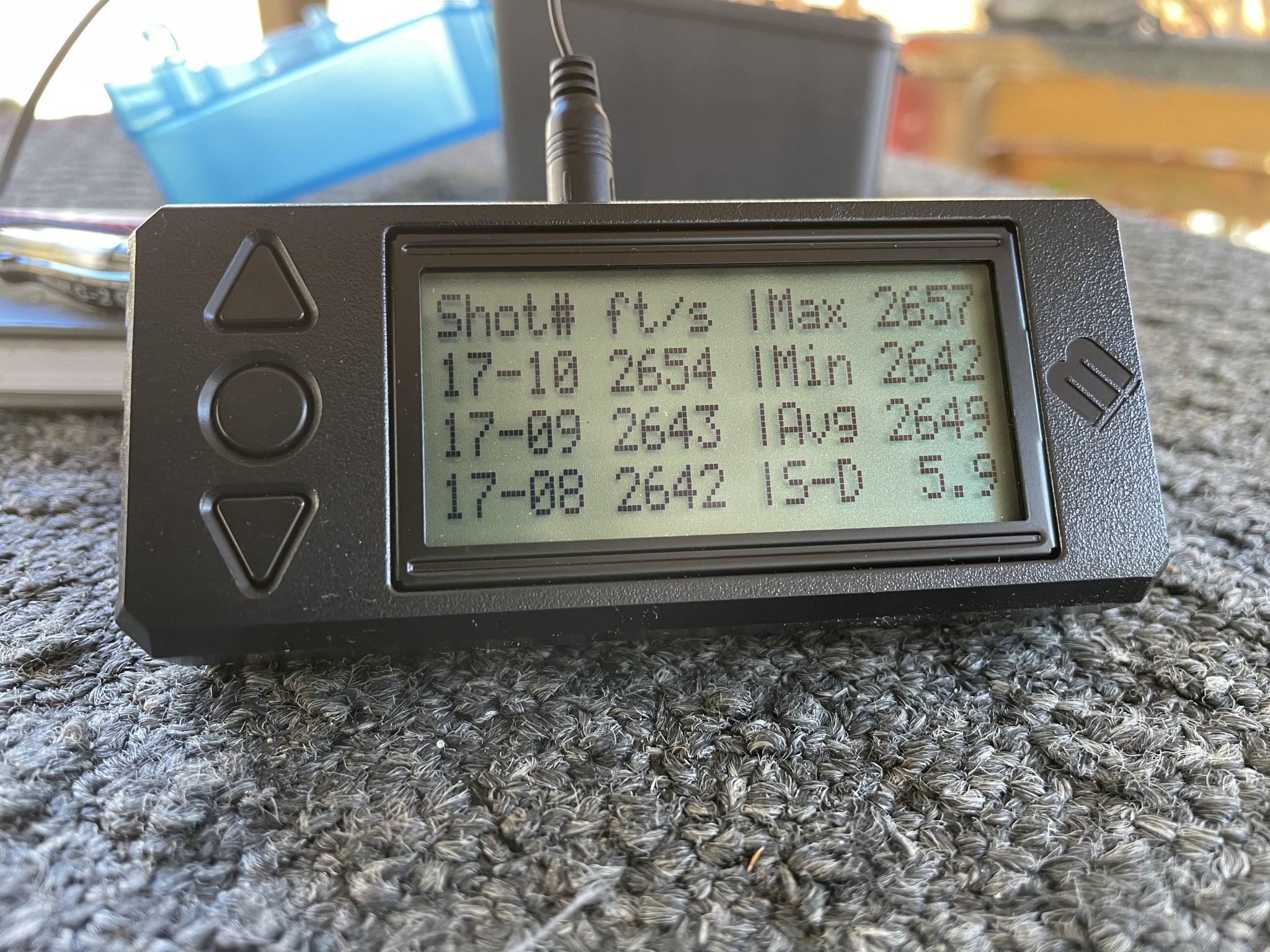

I’ve noted that too about those powders and have learned the ways of my own scale. My system of adding or deleting 3-4 kernels has worked this long. I get single digit SDs on 10 shot strings most of the time. Sometimes 9-11 or so but works for me. Sub MOA to 1” accuracy in 10 shot groups. This was a recent one with 308 CBC brass that’s been fired 6-7 times at least and V43.5 out of a APO Savage.

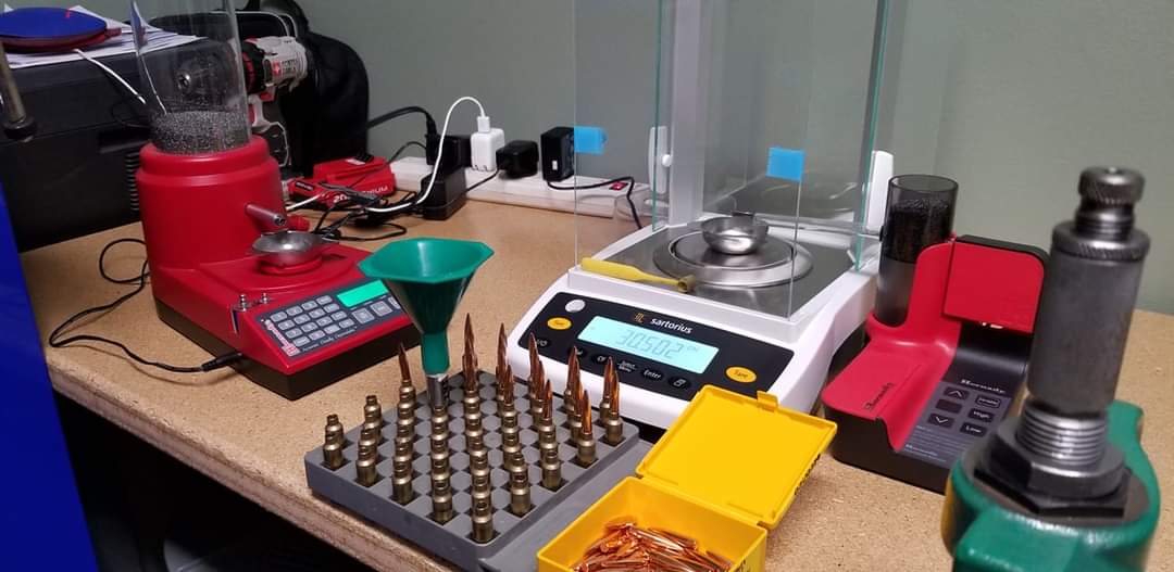

I use a Sartorius Practum and Mr. MacDonalds auto-thrower-trickler. The scale reports in 0.02 grain increments. The autothrower wants measurements in grains. For 308 my setpoint for IMR 4064 is 41.52 grains. I accept 41.50, 41.52, and 41.54. Anything else goes back in the hopper. With IMR 4064, 0.02 grains is a little less than one grain of powder. Given identical processing, Lapua brass shoots maybe 5% better than Lake City LR brass - trim, primer pocket uniform, flash hole deburr but no neck turn. I have a lot of LR so that is mostly what I load. Out to 700, I have much confidence in my scope settings - I can see the difference on the targets. I could sort cases but I don't bother. My shooting is crappy enough to make that unnecessary.
