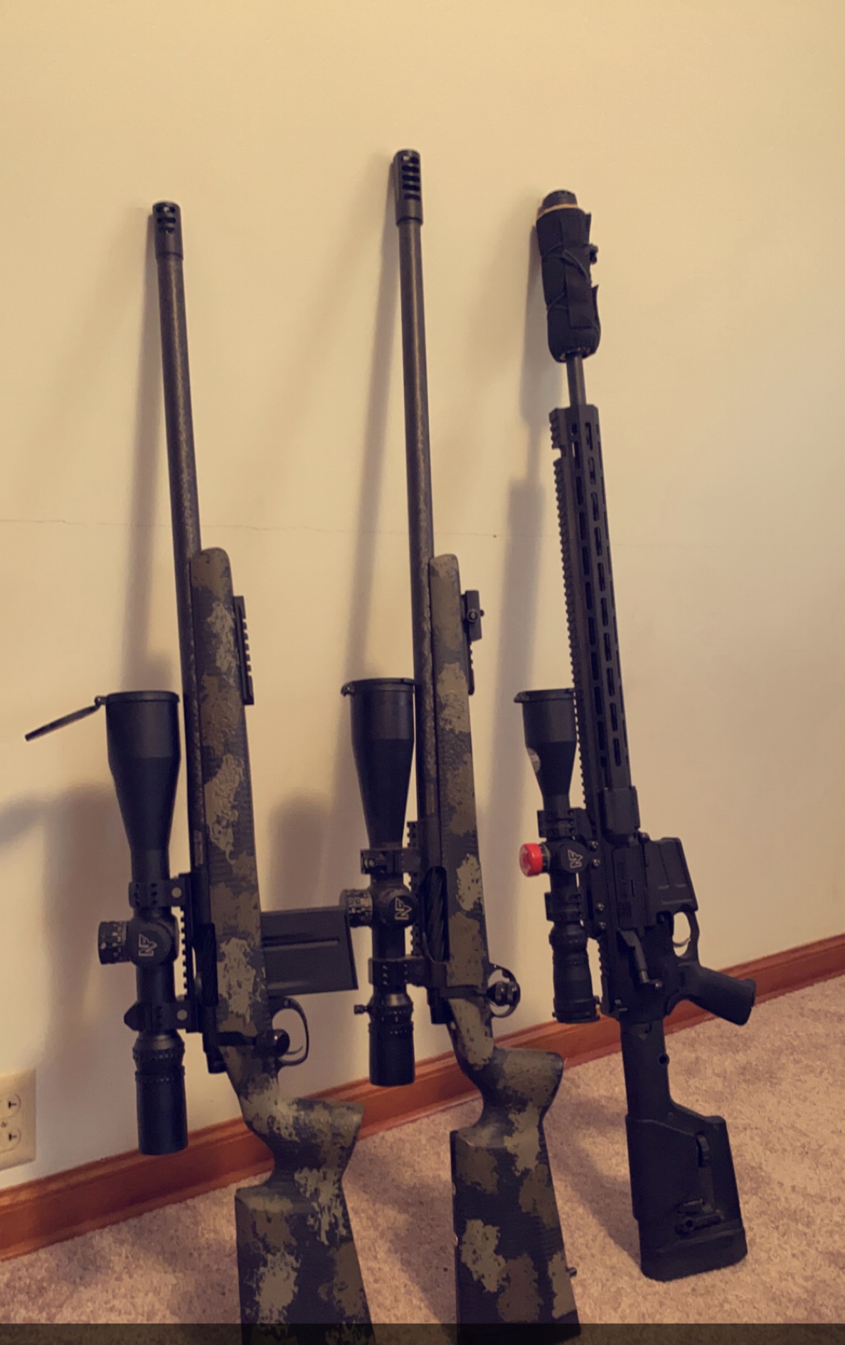

    I have the msr10 long range in 6.5.
    Pros:
    The rifle shoots extremely well for a gasser. I am able to go suppressed and un suppressed without any issues. It shoots hornady 143 eldxs extremely well.
    Cons:
    pretty heavy rifle with my nx8 and oss can
    Proprietary components make it hard to customize. Barrel can maybe be swapped?! but handguard cannot.
    Im looking to sell mine bare rifle for 1800. Less than 400 rounds through it. Want to build a mk 11 mod 0 clone in 6 creed
