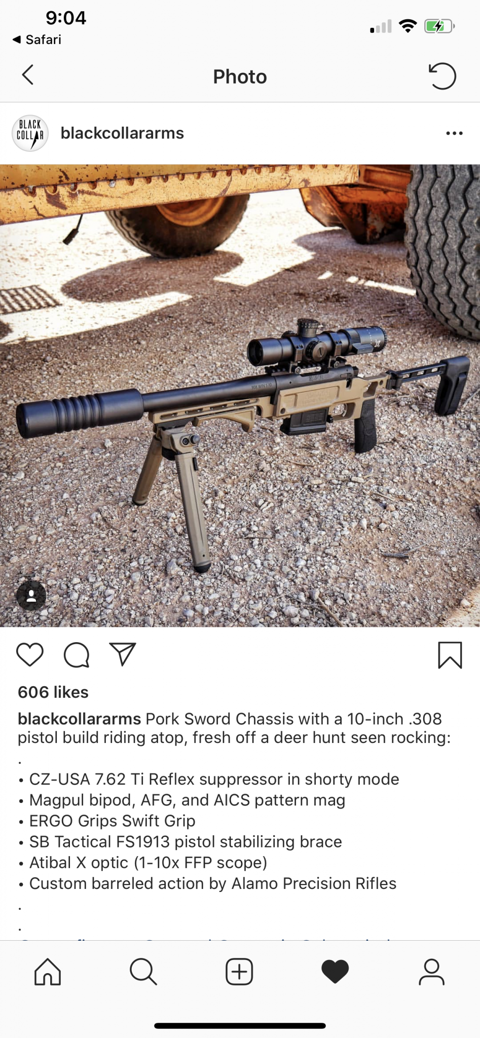

The “Pork Sword” pistol is what really piqued my interest, now I want to build my own version of this.

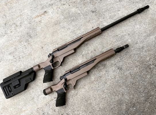

LaRue is doing something like that. A pistol and potentially a rifle barrel combo. Not a fan of the water spigot buffer tube mounting, or the setup in a rifle configuration overall. The chassis itself looks like a MDT LSS with a top rail.
This or the Remington 700 CP are two of the newer options.
