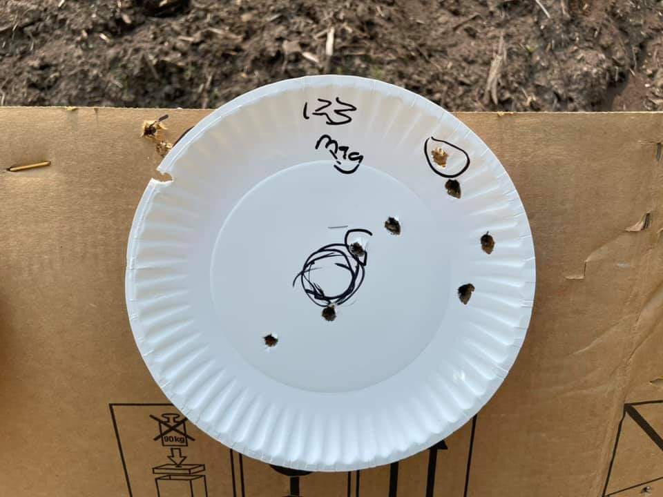

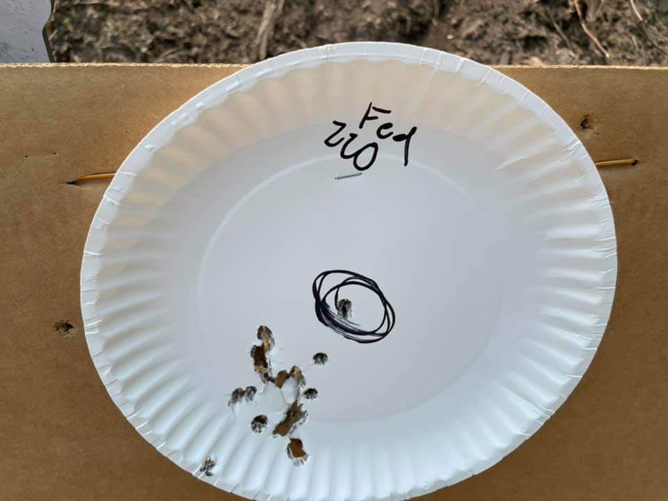

Are the bullets keyholing or cutting perfectly round holes?
My 1 in 10 will not shoot any heavy sub sonics. They always keyhole. Great with supers 147 and below but I haven’t tried any heavy ( 175 and above ) super sonic. I’m not sure they can be pushed that high without looking.
Here is a couple groups he posted up, the top is 123 magtech and the bottom is 220 federal unknown.
I suppose the bottom is not too bad other then the two flyers,
Before i purchase one of these, i just want to make sure this is not what they consider combat accurate for this platform.
