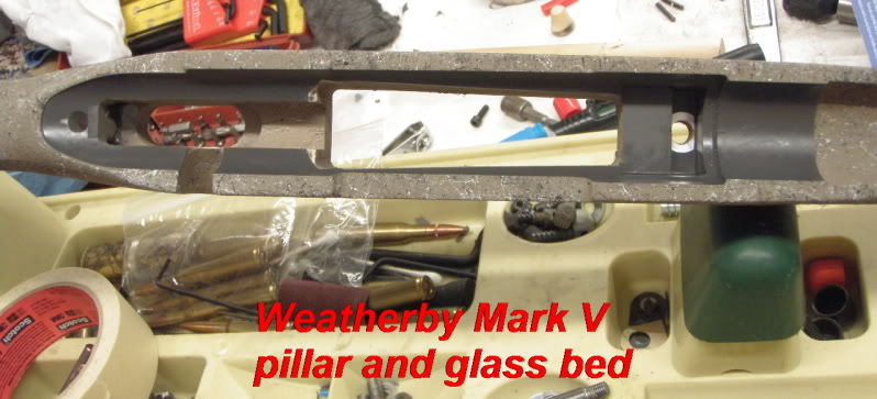

I bought a 416 a few years back with probably the worst bedding job I have ever seen. I hate to say it but it appeared to be from the factory which seems to use a light green fiberglass. Sounds very similar to your problem - there was so much glass that the front of the receiver was way above the stock. And the bedding wasn't even, when you tightened the screw the barrel pushed to the side. The solution was simple - just chisel/grind/sand off all the glass until the bottom of the receiver makes firm contact with the stock and after tightening the action screws to the correct torque the entire barrel is free floated. You should tighten the rear screw first (I tighten both screws firm then torque the rear, then the front to specs). You may also want to check that the rear of the recoil shoulder on the receiver is making good contact with the stock. Now shoot it and see how it does, you can now always go back and rebed the barrel if the rifle does not shoot well.
