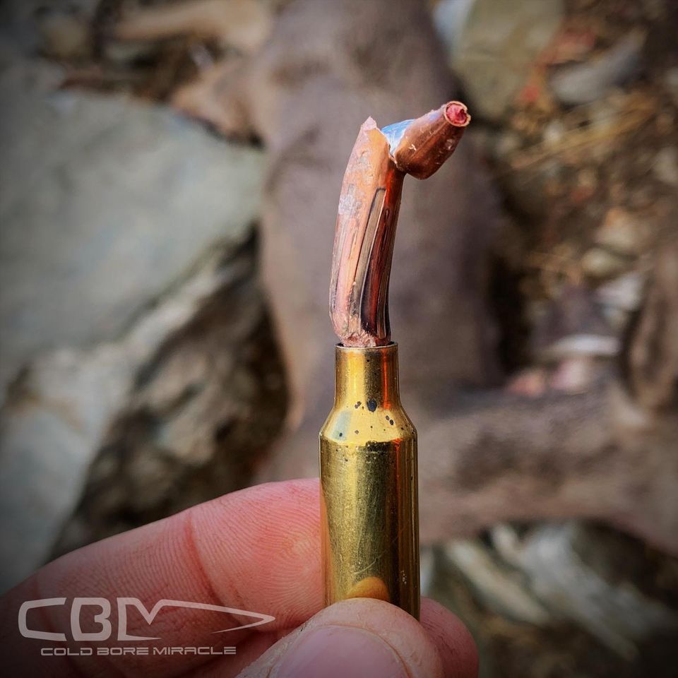

    Buddy shot this deer last week with a 6.5CM at 900 yds. Worked perfectly as far as killing clean, but bullet didn't expand at all. Only damage done was from hitting a rock upon exiting the deer.
    Video Here for those interested:

    Sorry I don't have first hand experience on the 143 but I have read very mixed results on it. I also don't like the 145 ELDX in .277 cal as my BIL shot a deer with it and had poor results...
    Curious to read what others have to say on it...

    I shot a deer last year with a 143gr Eld x at 111yds and it didn’t do near the damage I was expecting. Punched right through her and she dropped 20yds away from where she was.
    What was your MV and Baro Pressure? I think Hornady claims expansion down to 1600fps. From personal experience with tipped bullets in general anything below 1750fps starts to get dicey.
    Damn good shot placement, btw. That's a poke!

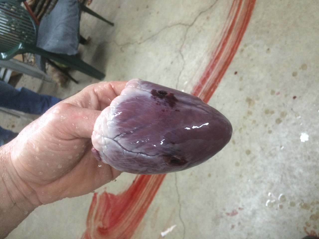

    My longest shot with my 260 is 1121 yards on a whitetail with 142 SMK. The bullet pin holed in and pin holed out. Mine was also a heart shot. I’ll post pic below.
    So I’ll say a SMK at long distance isn’t any better than what you have a pic of. My 260 runs 2835 at muzzle Unsuppressed with the SMK.

    So from what I have seen both here and on many FB comments, it looks like the 143 is pretty good when it is at 2000ish plus FPS. I had heard that it was supposed to open reliably at 16-1700 fps but that doesn't seem to be the case based on the bullet pictured as well as others experiences.
