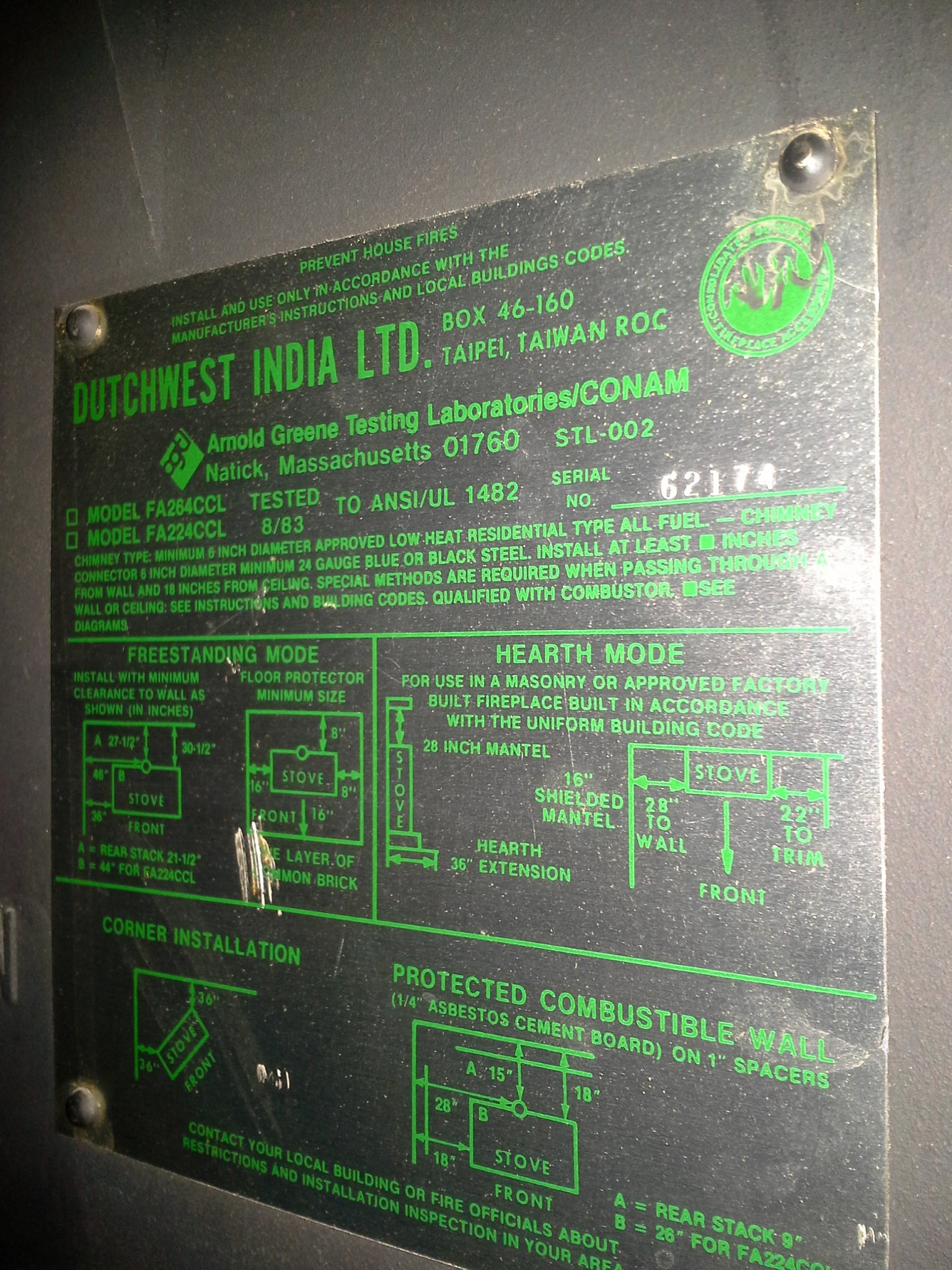

    My Consolidated Dutchwest federal convection heater has a metal plate on the back that shows the required clearances.

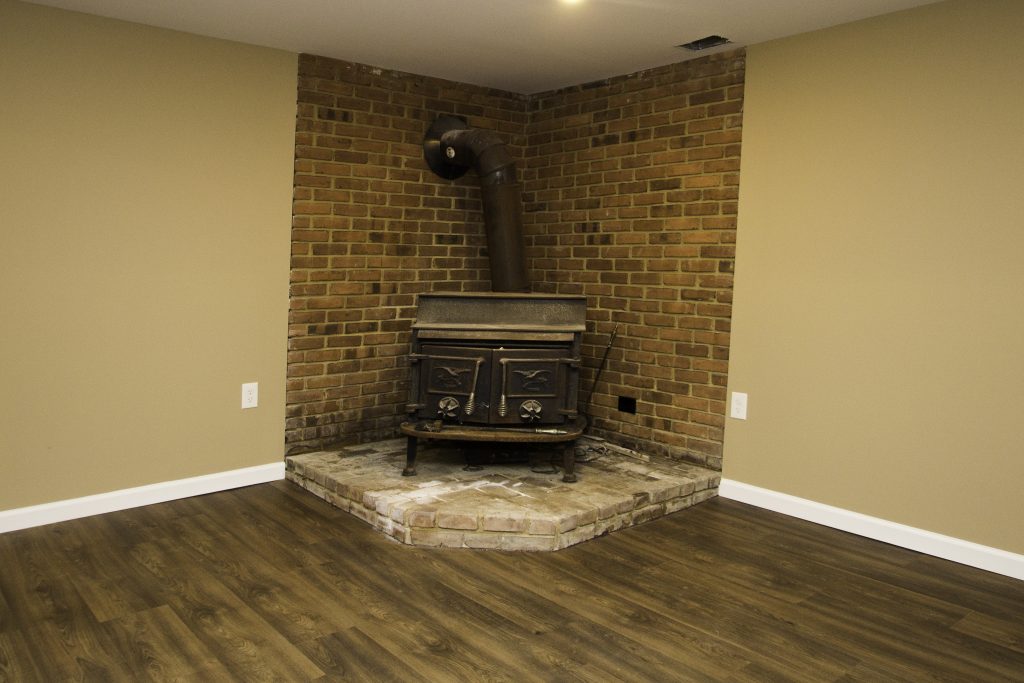

    This is similiar to what I’m trying to accomplish. But right now my corner is all painted drywall with wood framing behind it.
    What is like to do is instead of brick like in this picture is to remove the drywall and replace it with cement board. Then stone veneer over the top of it. But that leaves me with wood studs behind the fire resistant cement board / stone veneer. I’m not sure this is allowed…do I need metal studs to do this type of install?

    No, and no… no need to remove the drywall
    Got it. So the only reason I would have to remove my current drywall and wood studs is if I wanted to really cram the stove into the corner. Theoretically I could put the stove like 6in from the bare concrete wall if I wanted to correct?
    For example if I wanted the stove 12in away from the walls. I could replace my studs with metal ones, and my sheet rock with cement board and stone veneer. And I could achieve getting the stove tighter in the corner because there’s no combustibles now?
    Most modern stoves have very tight clearances already. My last was a corner install and manufacturer requirement was 6 1/2 inches from stove corner to wall. You have pipe and stove clearances to maintain. The manual figures for whichever is bigger. Any material that touches a combustible is now considered combustible. If stone is installed on top of drywall the stone is now a combustible and clearance must be maintained.

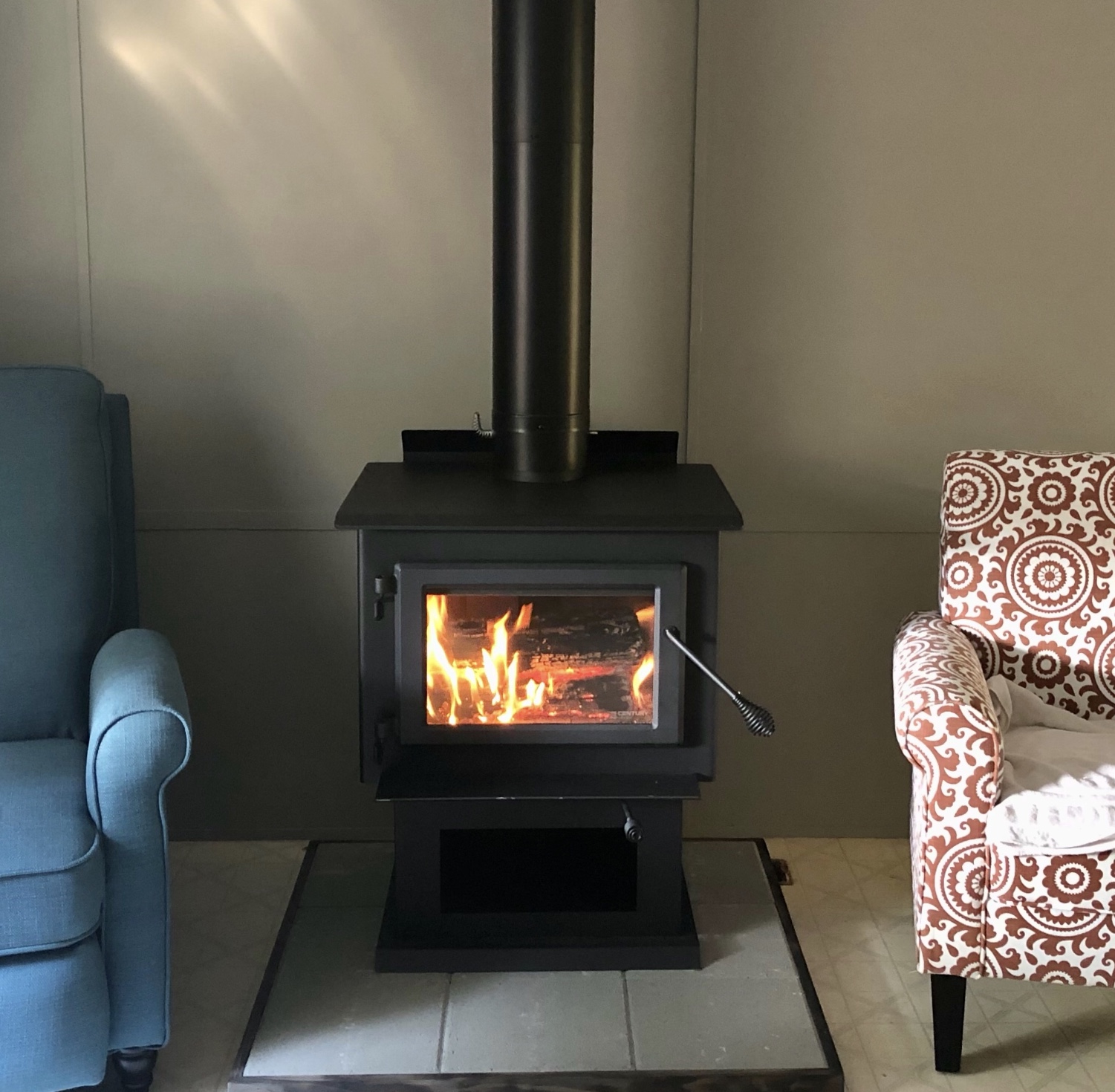

    I installed mine this summer. I heated with wood my whole life but when we moved here permanently, this house didn’t have a stove.
    It’s a Century FW2900, made in Canada. I used Duravent double wall interior pipe (inside is stainless) and triple wall stainless exterior. The ceiling box is Duravent as well. Watch some videos, read a bit and figure out a game plan.

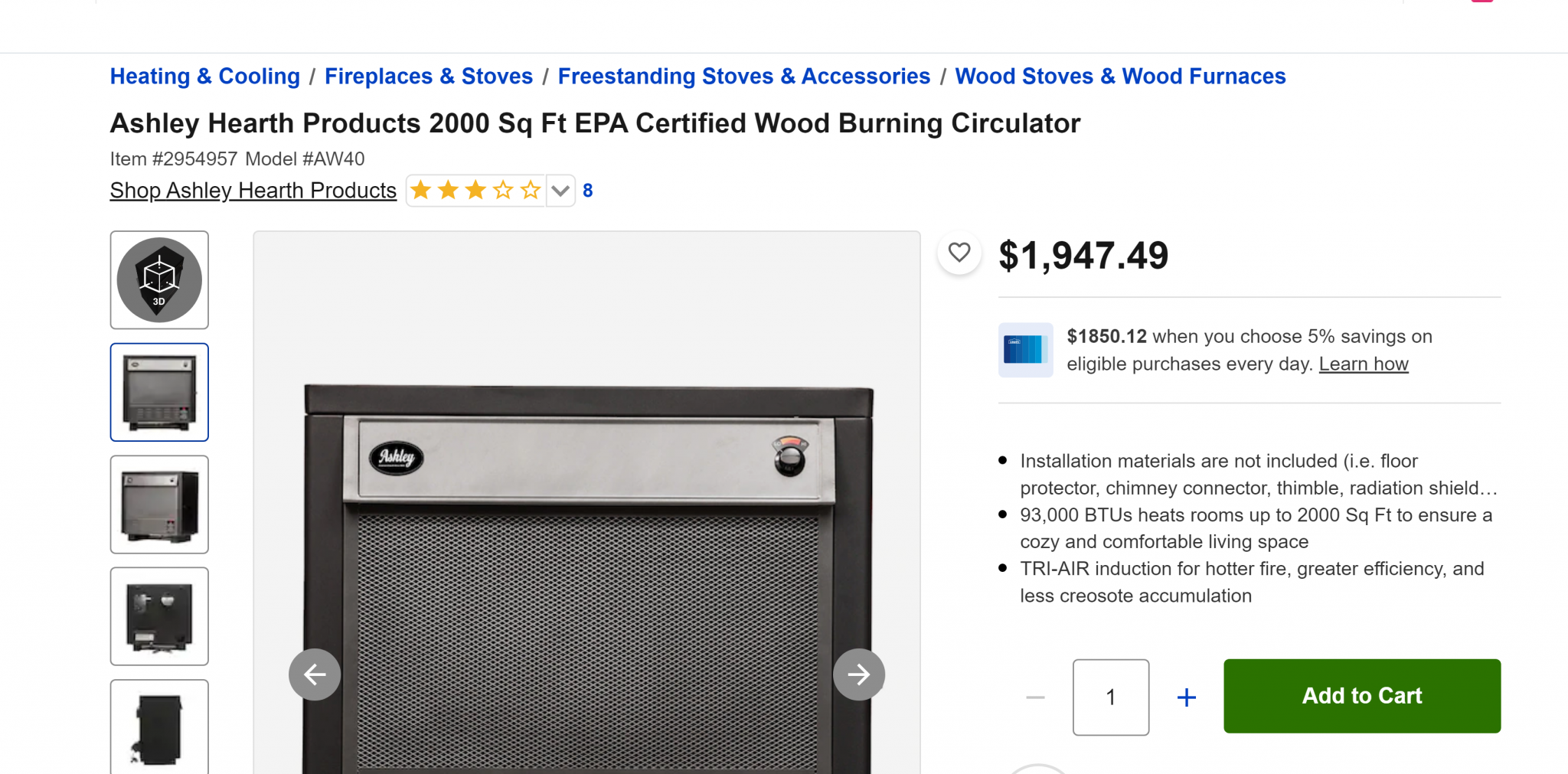

    do you want heat or pretty. The best stove I ever had was called a Warm Morning. If I filled it with wood and turned it down low, t would hold fire for 36 hours or more. Not pretty but they work.
    Looks like Warm Morning is out of business but Ashley makes the same type. Again if youre looking for pretty, click amd move on but if you want controlled heat this thing heats up to 2000 ft sq.

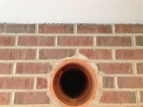

    You say 'thimble', what do you mean by that? To me a masonry thible looks like this:

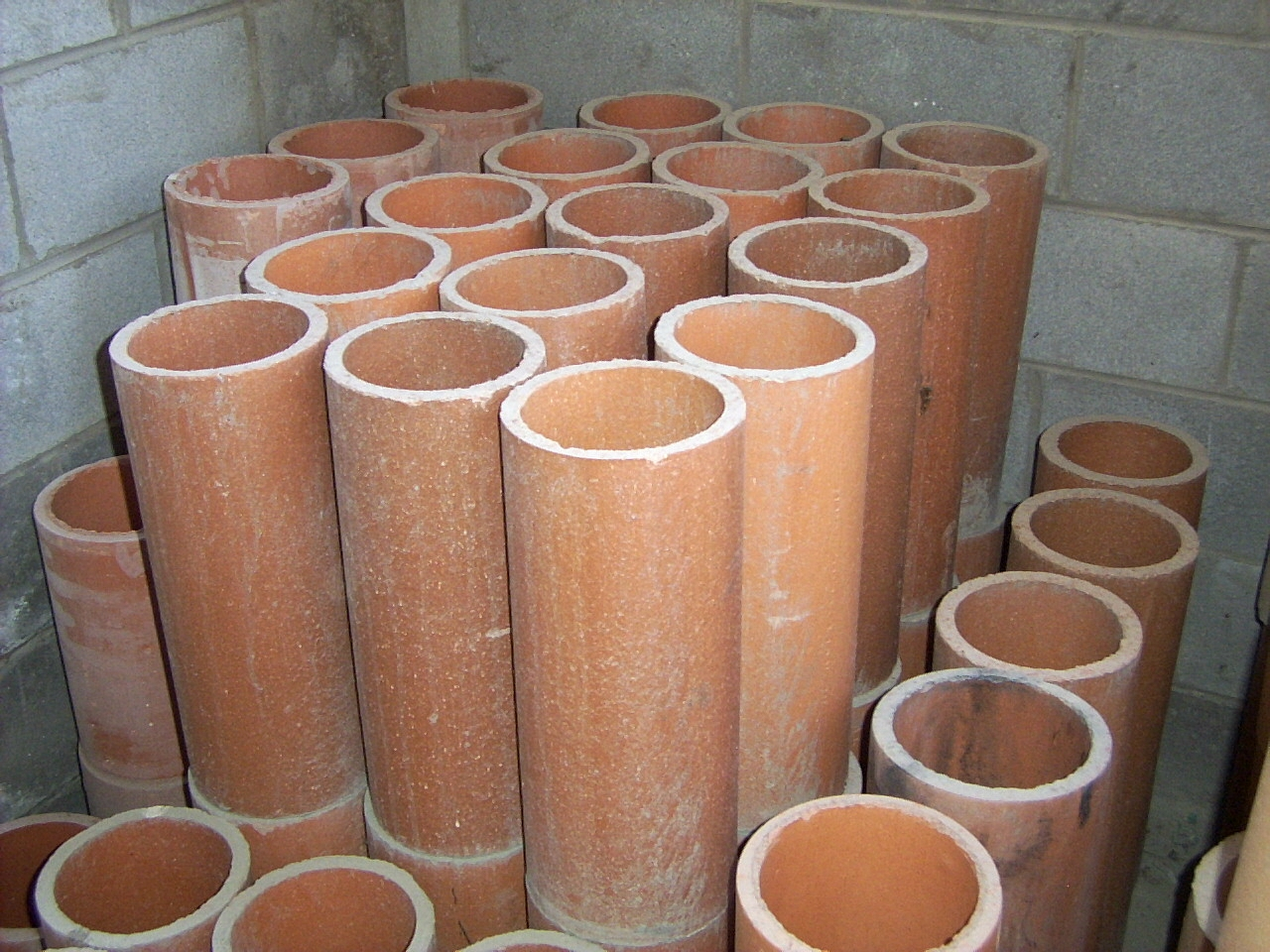

    A masonry thimble is a round, terracotta cylinder extending through the chimney wall into the flue. The hole is usually 6 or 8 inches in diameter and is designed to accept stove pipe.
    Ive used them up to 24 inches but if youre going through solid concrete you could use two 8" or 12" as needed and butter the ends with mud with in the wall. Cuts easy with a diamond blade on your grinder, but fill it with sand before you cut it to avoid vibration and cracking. Forget the stove store for this, they want to sell you an installation and will be hesitant to give you advice that could come back to bite them in the ass if you burn your house down, go to a place that sells cinderblocks and other mason's supplies.
    Then you run the inside metal pipe into that and same on the outside. We usually ran them straight into a masonry chimney but I reckon metal pipe wotuld work. Again, talk with the inspector before you do anything.
