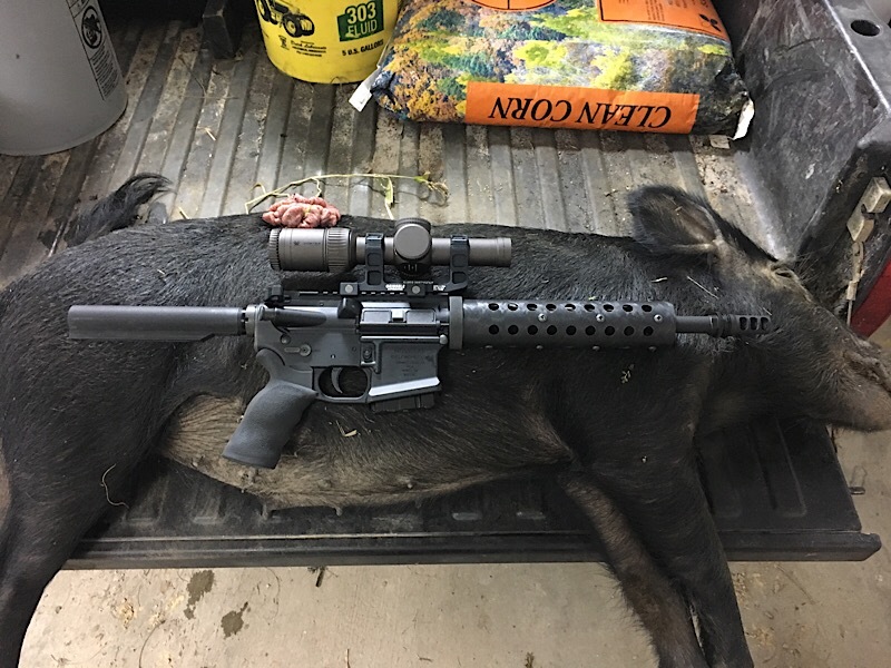

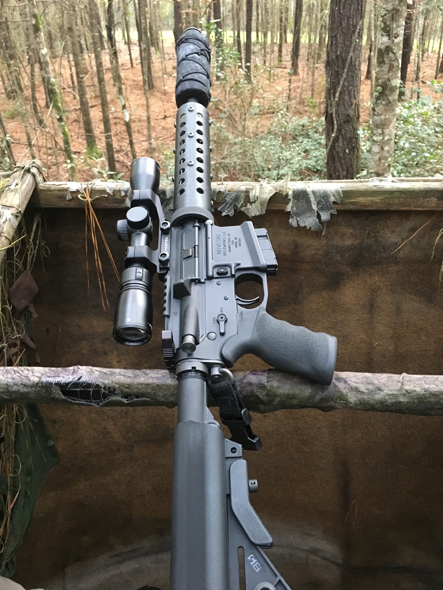

Alexander Arms 11" Grendel on a pistol lower I assembled from spare parts.
Check the Grendel forums for more SBR info. The Precision Firearms section has velocity #s for barrels down to 8.5" iirc.
With SiCo Omega it is tolerable without earpro. I'm thinking about a 5" TBAC Ultra direct thread to leave on it.
This will be for deer/hogs <200 yards. Still deciding on optics. Leaning to Vortex Razor LD 1-8x32.

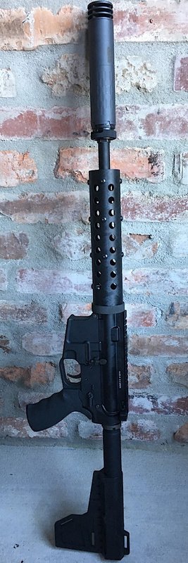

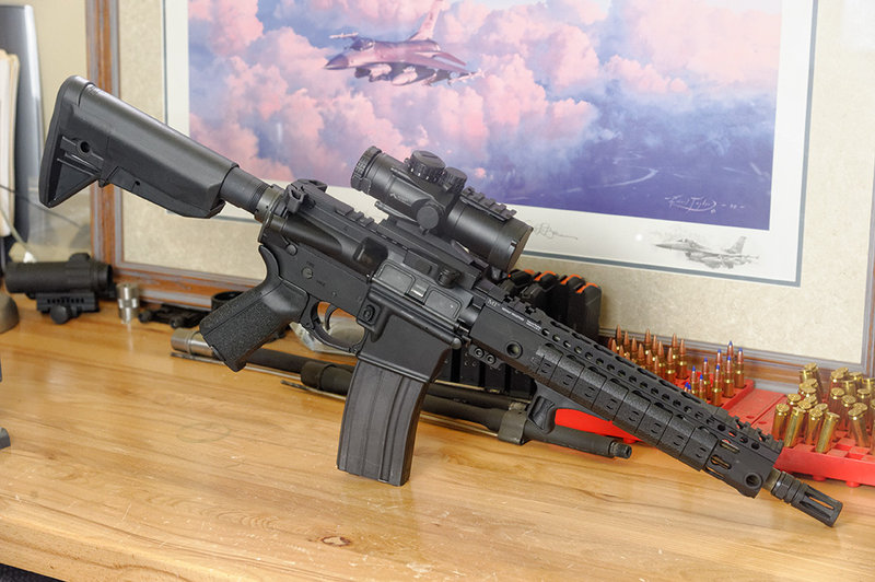

I'm doing a 12" Faxon barrel build right now. Waiting on some components, but it's going to be a much smaller PDW-type blaster than a carbine or rifle.
I have an Ultra 5 TBAC 30 Titanium 7.6 ounce suppressor in jail to tip it off when it's done. I'm not really interested in shooting it much unsuppressed, but I will for chrono numbers.

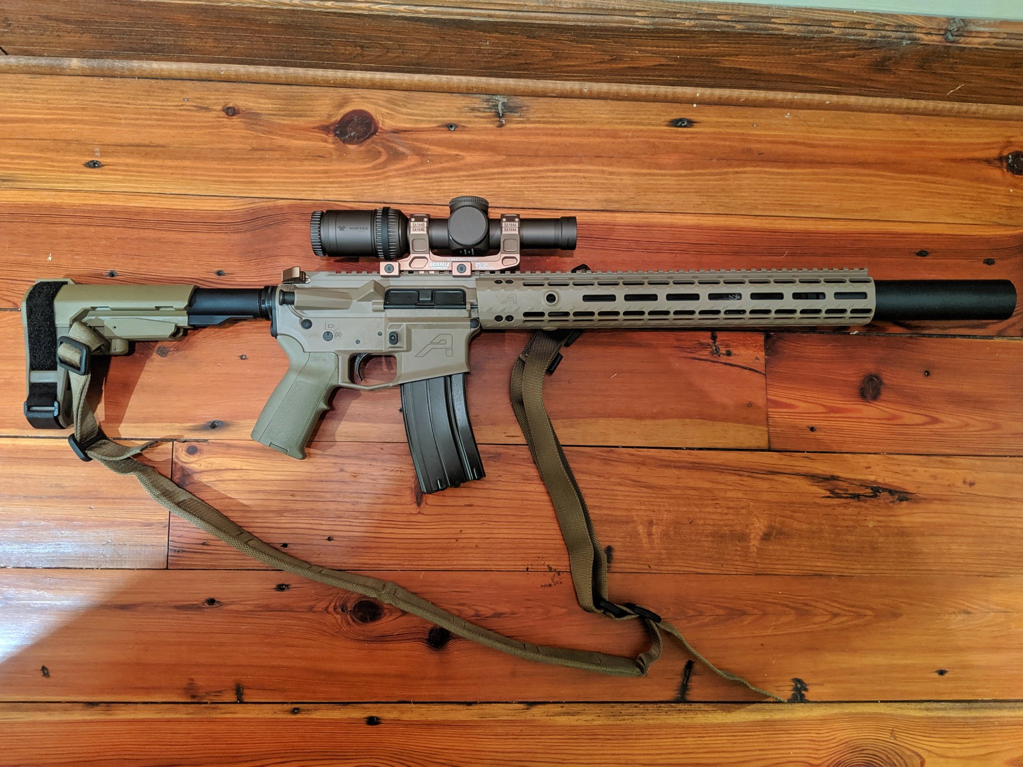

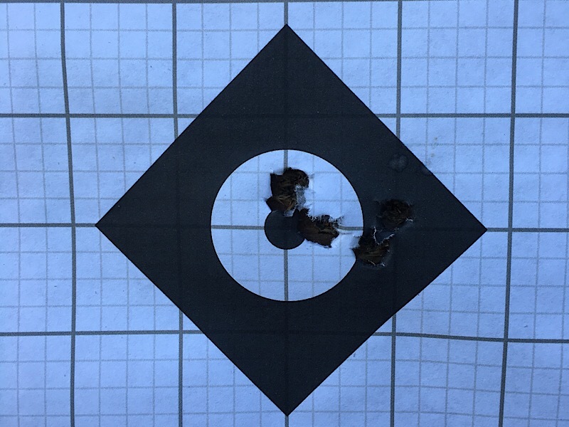

Here’s some motivation. First 2 shots to the right, next 3 after adjustment. Factory Hornady 123gr SST.

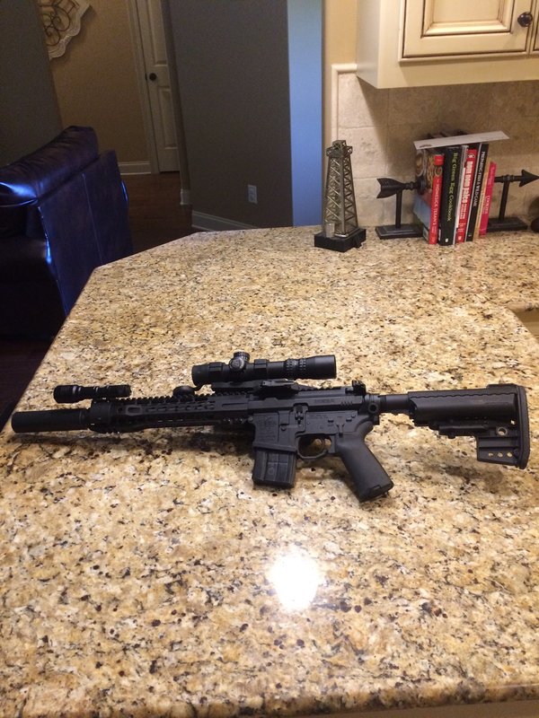

Hornady 123gr Amax: 11.5" Sabre Defence (suppressed) - 2348.8; 17.5" Satern - 2535
AA 90gr TNT: 11.5" Sabre Defence (suppressed) - 2450; 17.5" Satern - 2733.3
These were my CED chono #'s about six feet from the muzzle. Factory loads. The 11.5" Sabre Defence was a 14.5" cut back and threaded by ADCO and Satern was sent back to them for rethread to 5/8x24.
Foot long wears a VX6 1-6 and the almost 18" LRHS 3-12

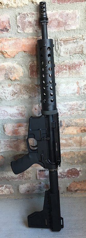

Alexander Arms has a factory SBR upper (seen here) and upper kits where you picK your own rail. I love mine. It thumps steel at 325yd. It is my primary hunting rig, replaced a bolt action .270.
