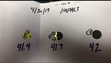

...got the barrel in April, it shot great from day 1. Took land measurements and what not when barrel was new prior to putting it on the action. I loaded up 120 rounds of a random load, zero'd, and shot a club match with it. Post match i cleaned it well, took follow up measurements and then went into load work...some pics of that below
above was at .010" off the lands, i loaded up at 41.8 verify again another day...both 5 round groups

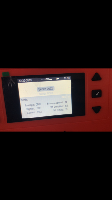

checked velocity to see if anything was obvious...nope, AVG 2869 ES 14

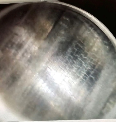

couple pics from near the start of the lands...pic quality isnt great, pic of a computer screen
yes that was actually my first thought after the first cleaning post nrl finale...thought maybe i just missed some carbon, so then i cleaned again and hit with a little bore paste then bore scoped it...was shiny with a little fire cracking but nothing major i could see
View attachment 7209754View attachment 7209755
That looks 30 times better than my oldest dasher did at 600rds for some unknown reason. Back the borescope up a little to the end of the neck in the chamber, I consider a carbon ring to be what builds up at that 45 deg angle of the transition from neck dia to bore. But honestly, as clean as that looks, i'm throwing spaghetti at the wall now.

yea that area is clean also from memory, i had short video on my phone and i just snapped some stills from it, but it was only that lands area in the video

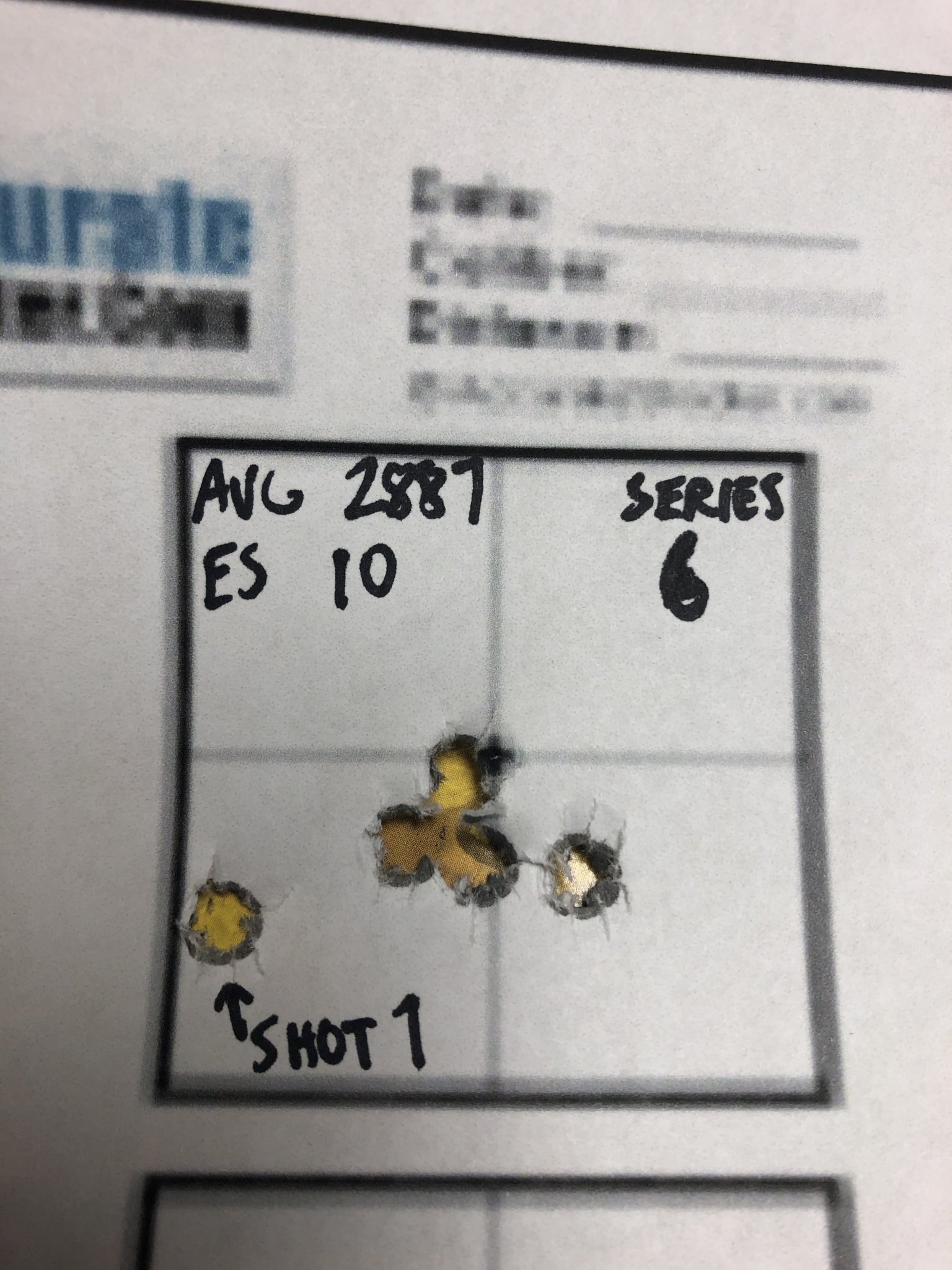

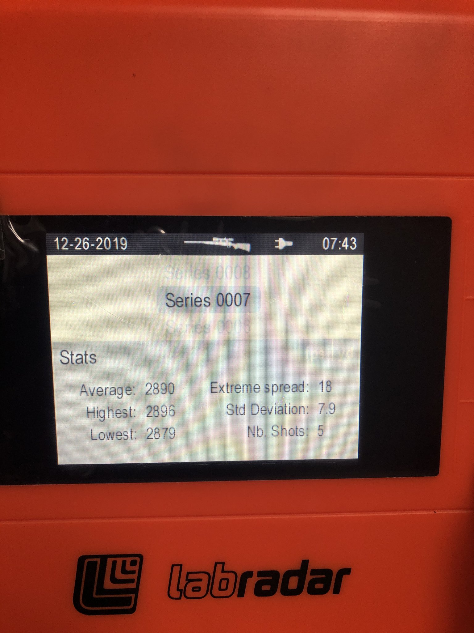

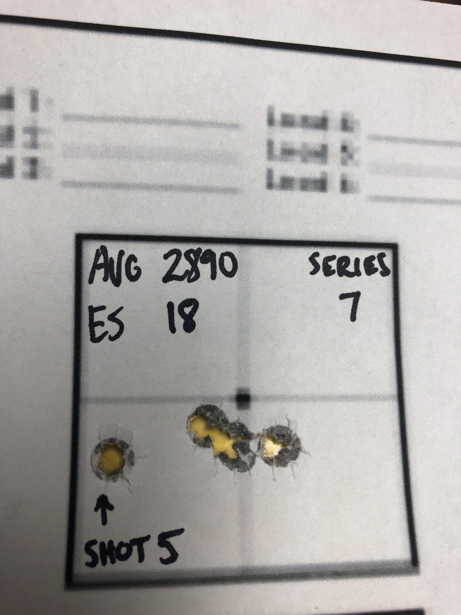

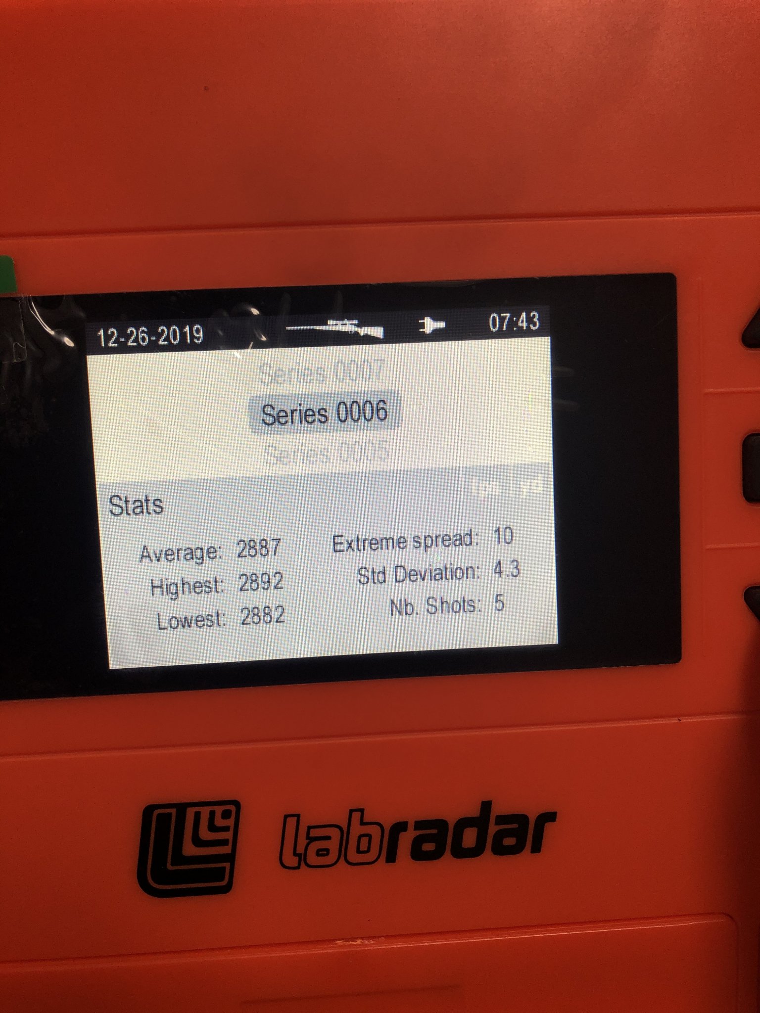

at the range saw the following
first group...
removed the muzzle brake...forgot to reset the labradar to a fresh strbut numbers were basically same
put the brake back on, shot 5 more...
First thing I noticed was I picked up 15-20 fps from annealing
groups almost want to tell me something is loose? Random shots being out in the same direction seems weird... But the no brake groups with more recoil, had similar shape but much larger...idk what to make of it, if anything
even weirder is these groups seem to have a common theme, but don’t resemble any of the groups shot previously when the issues first came about
not sure what to make of it...but smith wants to recrown it tomorrow and knock off step 1 from above
Any thoughts? Typed this on my phone so harder to proof, hopefully didn’t butcher anything too bad

see if you can feel it with slug or tight patch.
its 24" now...ill try to push a patch see how it feels
like i mentioned up above with slugging, ive done it on a few barrels, but what i felt, i had no real way to gauge good or bad...one barrel that shot great felt loose at the muzzle, another felt tight lol i didnt know what to make the differences i felt
