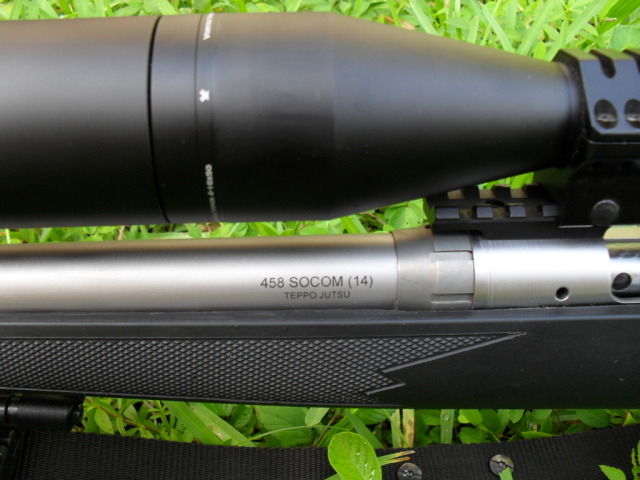

I realize this thread is a bit dated, but this project is definitely doable. I built a .458 SOCOM bolt gun for slaying hogs in the Southeast. The main reason was to suppress it and use 500-600 grain subs. A 600 grain sub produces 1,469 ft. lbs. of energy at the muzzle (1,050 fps) and loses very little velocity out to 400 yards. A 500 gr. sub produces 1,224 ft. lbs. at the muzzle, which is comparable to the supersonic MK262 5.56 round. The difference is the expansion of the projectile produces a massive exit wound about the size of a coffee saucer. I bought the headspace gauges from Manson Reamers per Tony Rumore from Tromix. The Rem 700 barreled action sits in a Hunter 700 stock and is fed from a modified .308 AICS Pmag. If you have any questions feel free to ask. FYI - don't bother with the Bishop Ammunition. They absolutely won't help and literally accused me of copying their idea and threatened me with litigation.

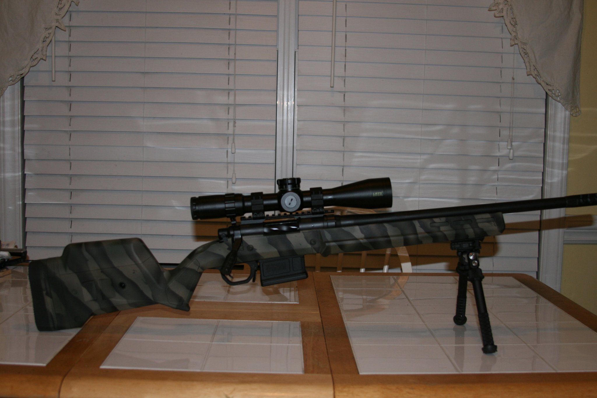

I've built a few, and building another this week. Ultimatum u300 action, Boyd's stock, magpul plastic bottom metal and 5 round magazine. Nothing really hard about it, any Smith should be able to do it.

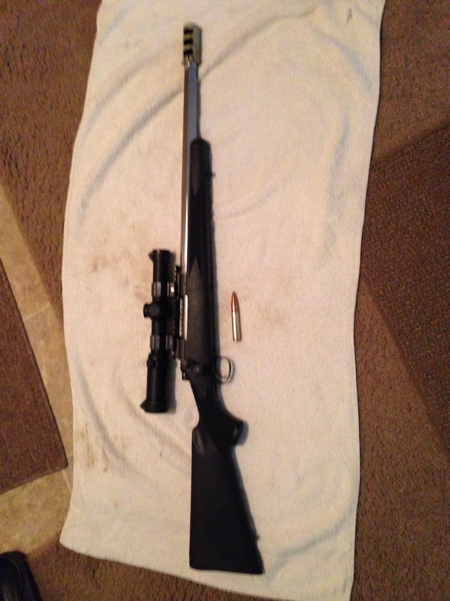

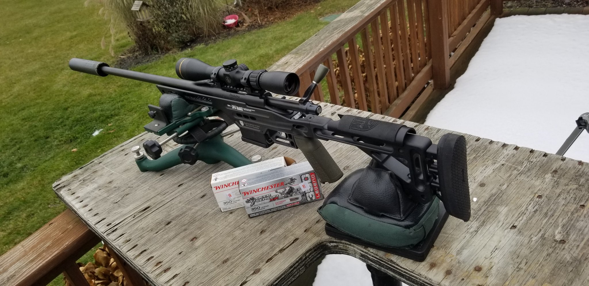

350 legend is a smooth shooter. Been tinkering with mine and happy with it so far. Still a work in progress as far as the finish stages go but functions and shoots good

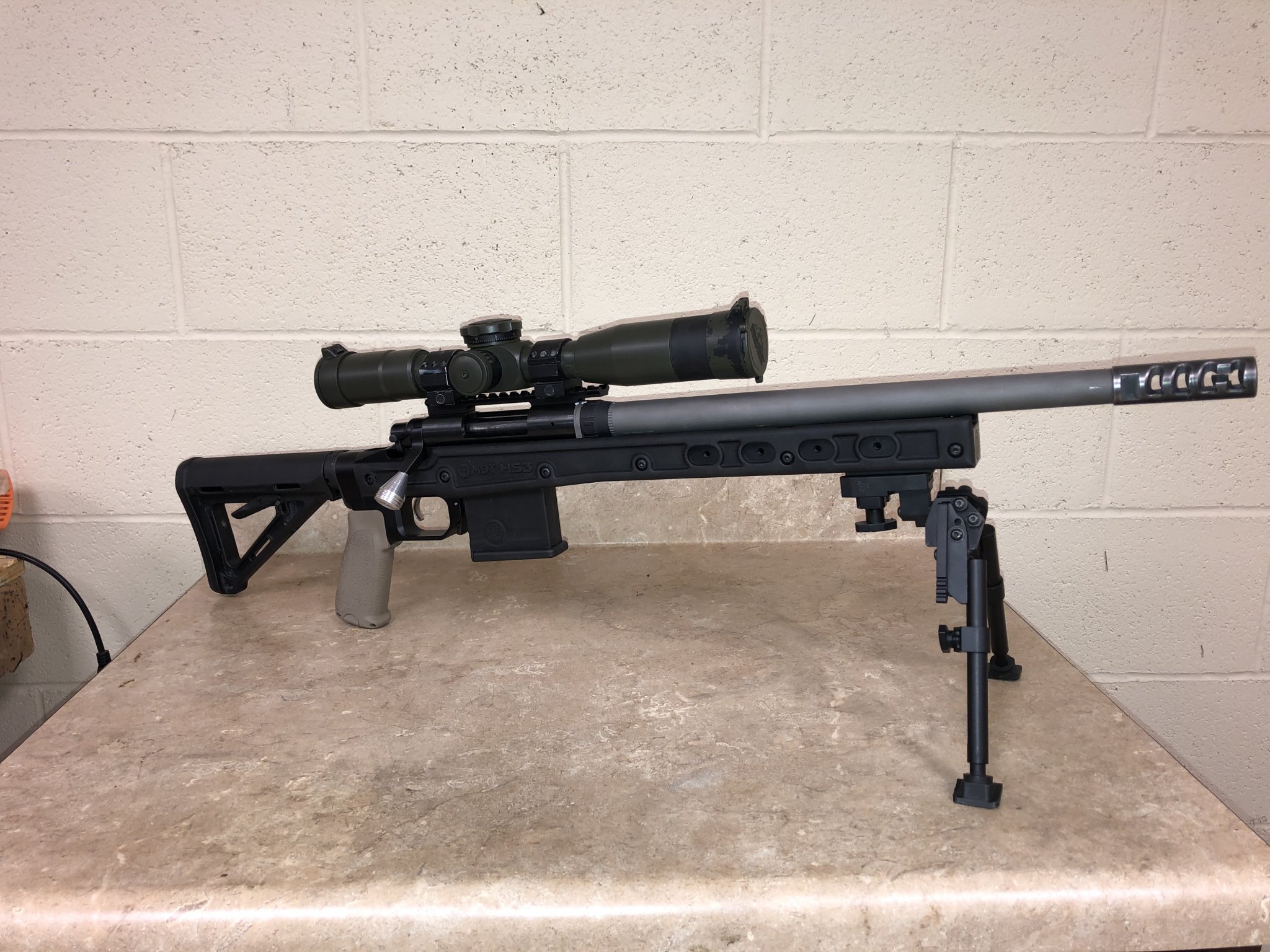

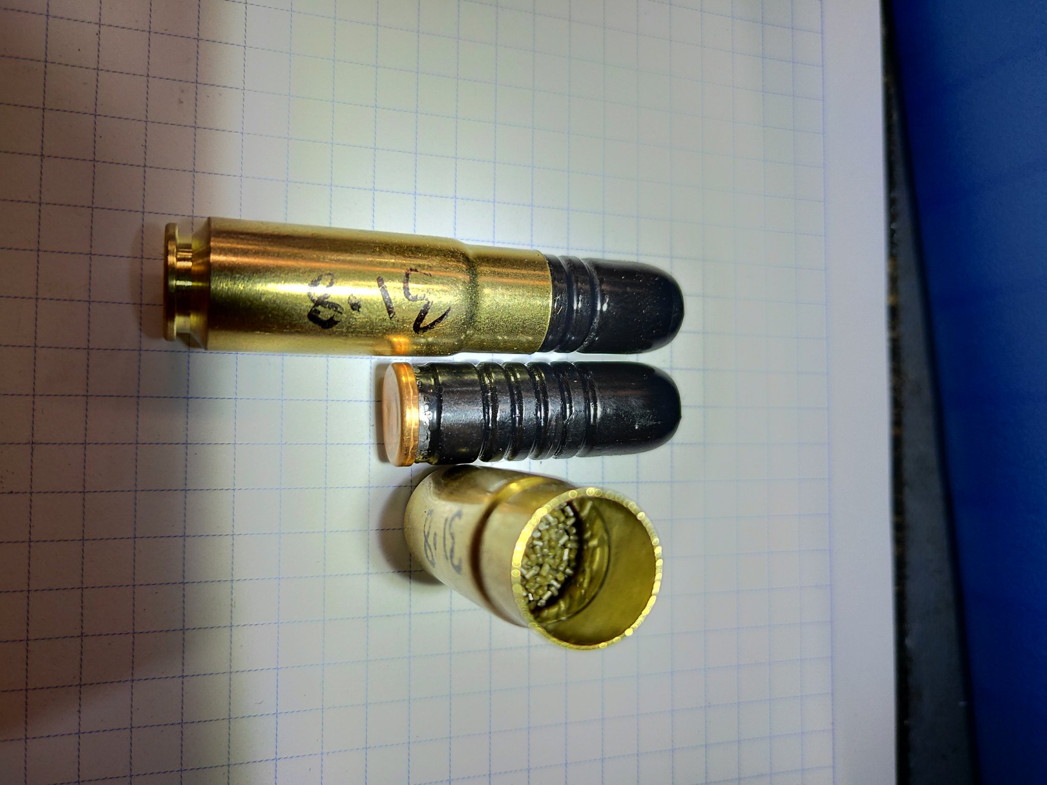

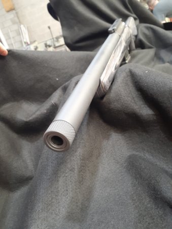

Here's a build we did for a customer, and a load Dev round for another rifles (not this one).

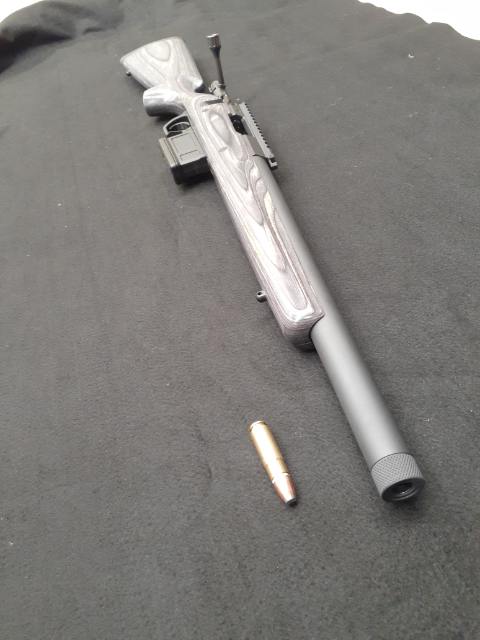

Southern Ballistic Research plumbed this one for me awhile back. 20” bbl on a Savage short action. Never got around to finishing the build, plan was to use an XLR chassis and feed the rounds from AICS mags with a spacer installed. I would show better pictures but I’m locked out of my photobucket account and the rifle is in Florida.

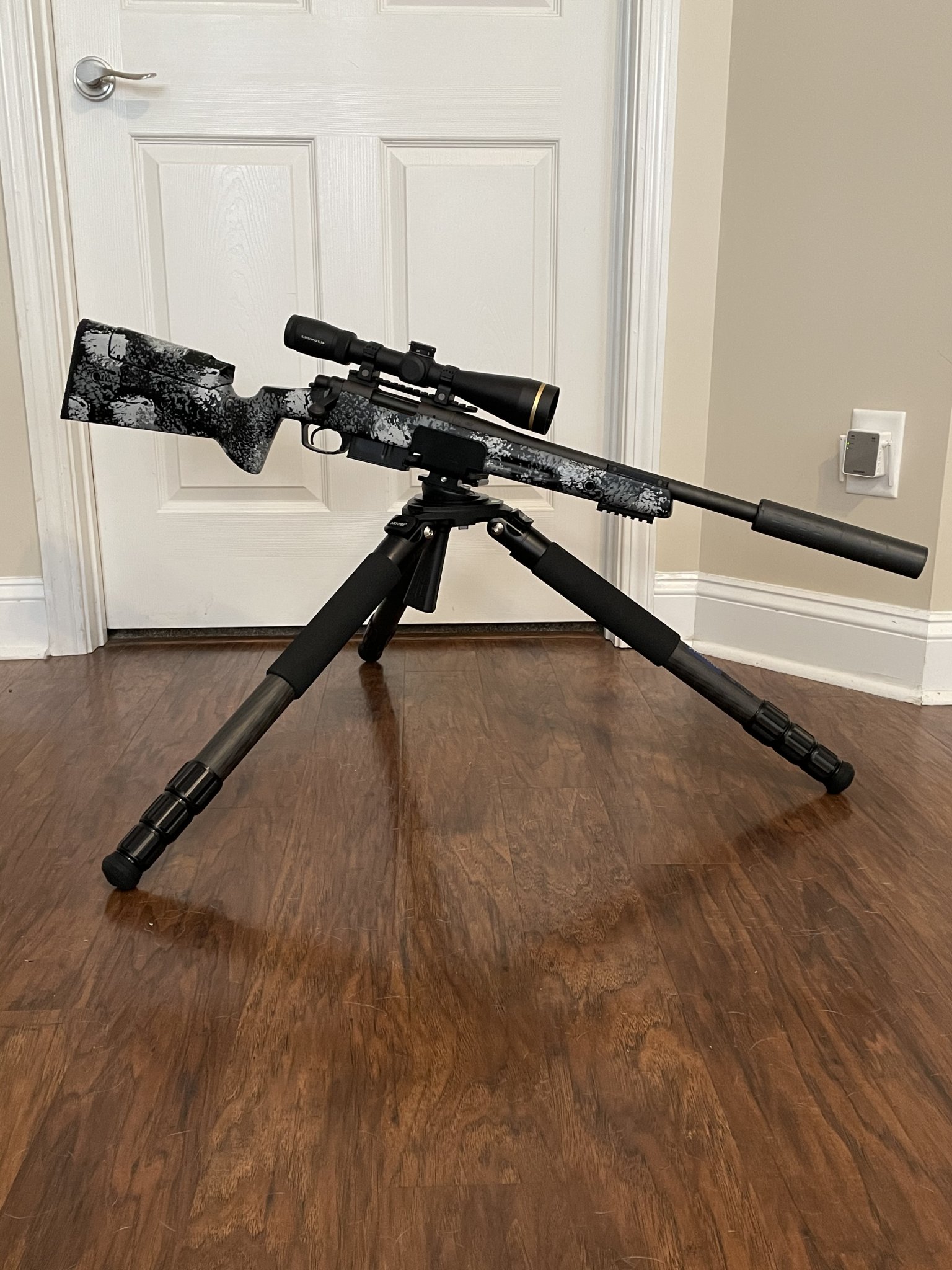

I realize this thread is a bit dated, but this project is definitely doable. I built a .458 SOCOM bolt gun for slaying hogs in the Southeast. The main reason was to suppress it and use 500-600 grain subs. A 600 grain sub produces 1,469 ft. lbs. of energy at the muzzle (1,050 fps) and loses very little velocity out to 400 yards. A 500 gr. sub produces 1,224 ft. lbs. at the muzzle, which is comparable to the supersonic MK262 5.56 round. The difference is the expansion of the projectile produces a massive exit wound about the size of a coffee saucer. I bought the headspace gauges from Manson Reamers per Tony Rumore from Tromix. The Rem 700 barreled action sits in a Hunter 700 stock and is fed from a modified .308 AICS Pmag. If you have any questions feel free to ask. FYI - don't bother with the Bishop Ammunition. They absolutely won't help and literally accused me of copying their idea and threatened me with litigation. View attachment 7192904

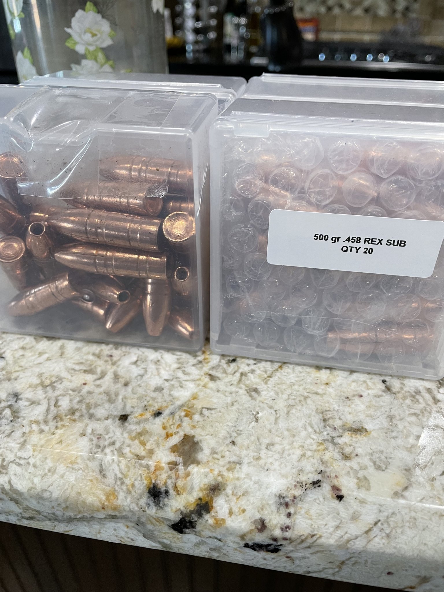

I’m working on a similar build with the same purpose in mind - shouting hogs with 500 grain subs at close range. How has your rig worked for that?
Was literally going to make a 0.5” spacer out of legos and epoxy it to the rear of the magazine, trim the follower to fit and leave enough clearance at the feed lips for the bolt. Didn’t get that far to account for the spring. I think I could have made an ar-15 mag spring work. The project is shelved for now, life got in the way and the rifle is over 2000 miles away.
I would love to rent a reamer from you if one exists. Started playing with powders yet?
