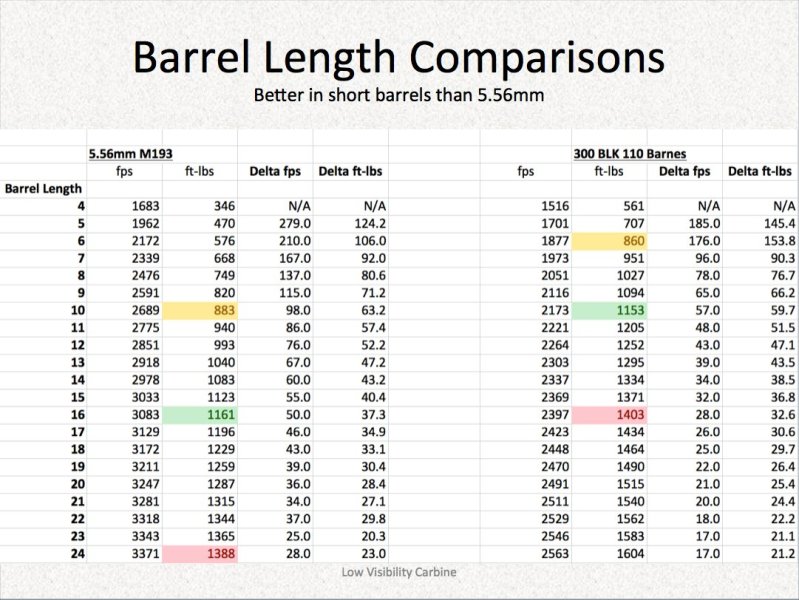

Here's what I saw recently on this subject. It's from 2015. Fellow cut the same barrel down and ran tests.
Go easy on me, just had cataract surgery today, feeling woozy. Can't read well, so maybe this has been discounted on this thread already. Also, the twist was 1:12″, which the author notes is not ideal. I wouldn've thought if one was going to go through all this trouble he'd get a 1:7", but whatever.
Notice the biggest change was from 16.5" to 14" but of course that's 2.5" and the other jumps are 1". Too bad he didn't do 16" & 15". Oh well.
edit: he also didn't crown the barrel each time and it seems the barrel was pretty shot out (Black Hills load shot 6 MOA!)
Reactions: jzerfoss
