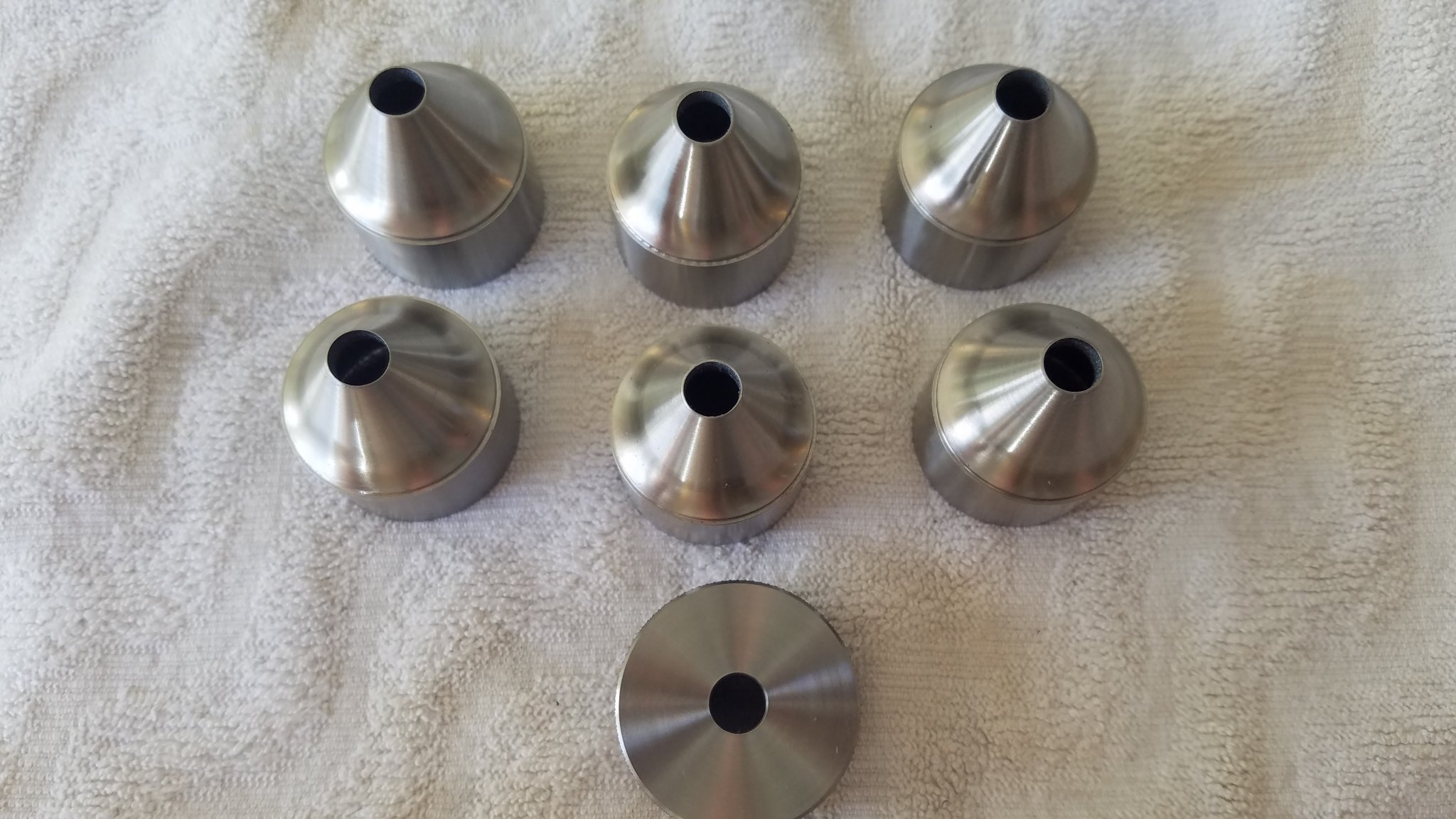

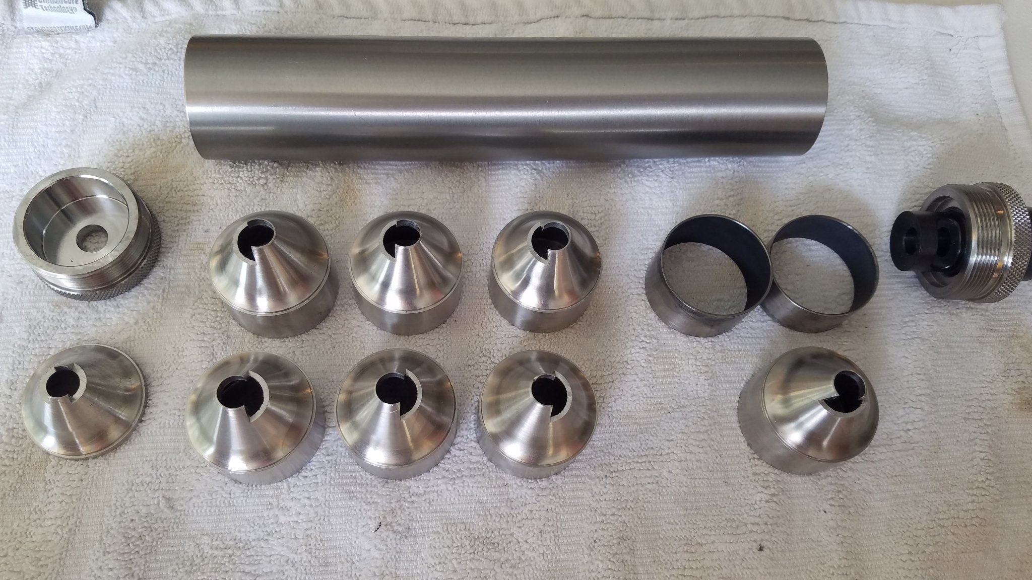

    Built an 8" from Solvent Traps Direct.
    I used a Cherry Bomb, 1.5" chamber and 8 baffles.
    A couple of the baffles had the skirts trimmed.

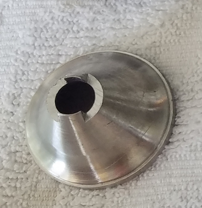

    The baffles will need to be clipped.

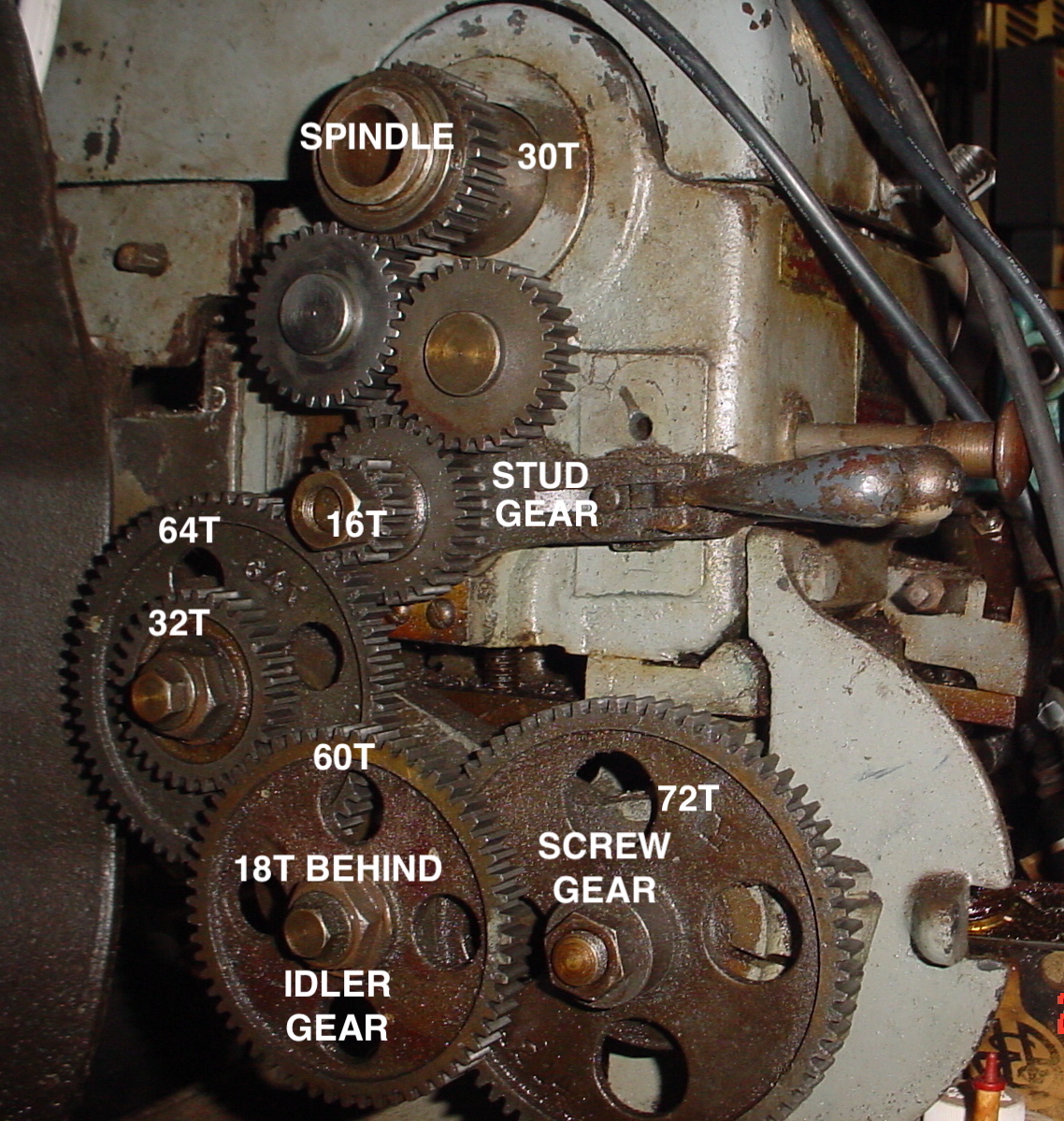

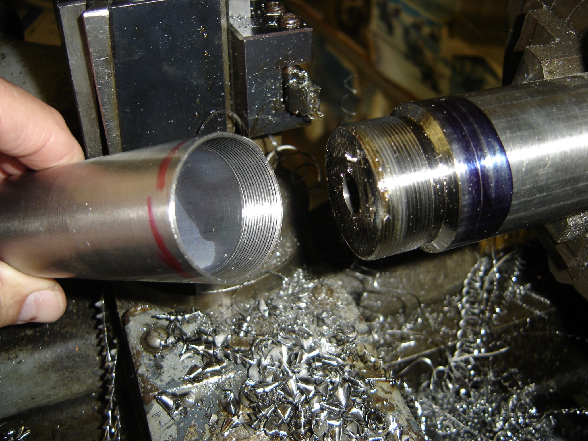

    For those of us that like to make things, I actually had fun figuring out how to cut threads w/ my ancient 1946 lathe.
    No gearbox, manual selection and arrangement of the gear train was required, so as to obtain the thread pitch.
    I bought the titanium on ebay, tooling from https://littlemachineshop.com/.
    Titanium cones from WTT. TIG welded the cones together.
    For my first silencer attempt (300 Blackout SBR, sub-sonic loads), it works great.
    Will make another soon.
