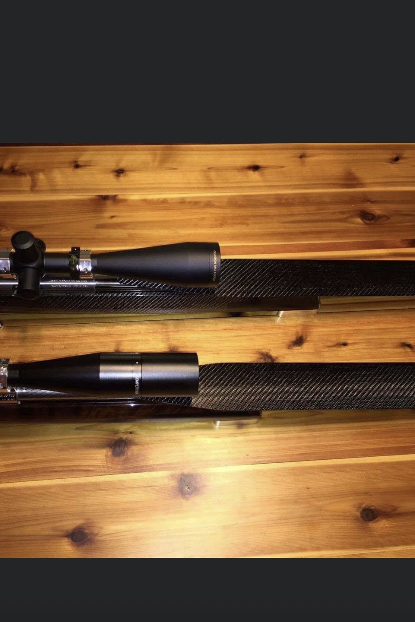

anyone ever try or use something like this ?

if so who's did you buy or make it yourself ? I have seen the flat ones and the one curved this says are bad but looking for one like the right example I am drawing a blank finding any company that makes any of them . If I could ask what are your thoughts on the idea or function ( did it work for you , what materials were yours made from ) thanks .
I saw one at a bench rest match once, carbon fiber. Never used one though

Used to be very common (mirage bands, in general) in the Long range highpower days. They can make a substantial difference in the amount of “barrel generated” mirage that you look through. I think that most of us try to avoid getting barrels that hot anymore.

I made mine out of cut off sections of 6' lengths of white window shade blinds. They even have the correct curl. Attach with small pieces of Velcro.
Very common on our bench rest guns. 6ppc and 6dashers. They work
I think brownell has them metal or carbon fiber. Use them at f class they work
Used in fclass by almost every shooter that I’ve seen. I use them. They work very well for 22+ shots over a 15-20 min period
Your pic on the far right is how we use them.
Got mine from Sean Patty’s Mirage Shields. I shoot with the guy that sells them
Basically blinds with auto decals on them. Velcro to barrel
Reactions: acudaowner
Seen some of my local benchresters use them. I run a small ran off a cell phone charging battery pack. Helps cool the barrel as well.
So you guys are actually letting these things touch the barrel? Just something about that concept hurts my brain.
