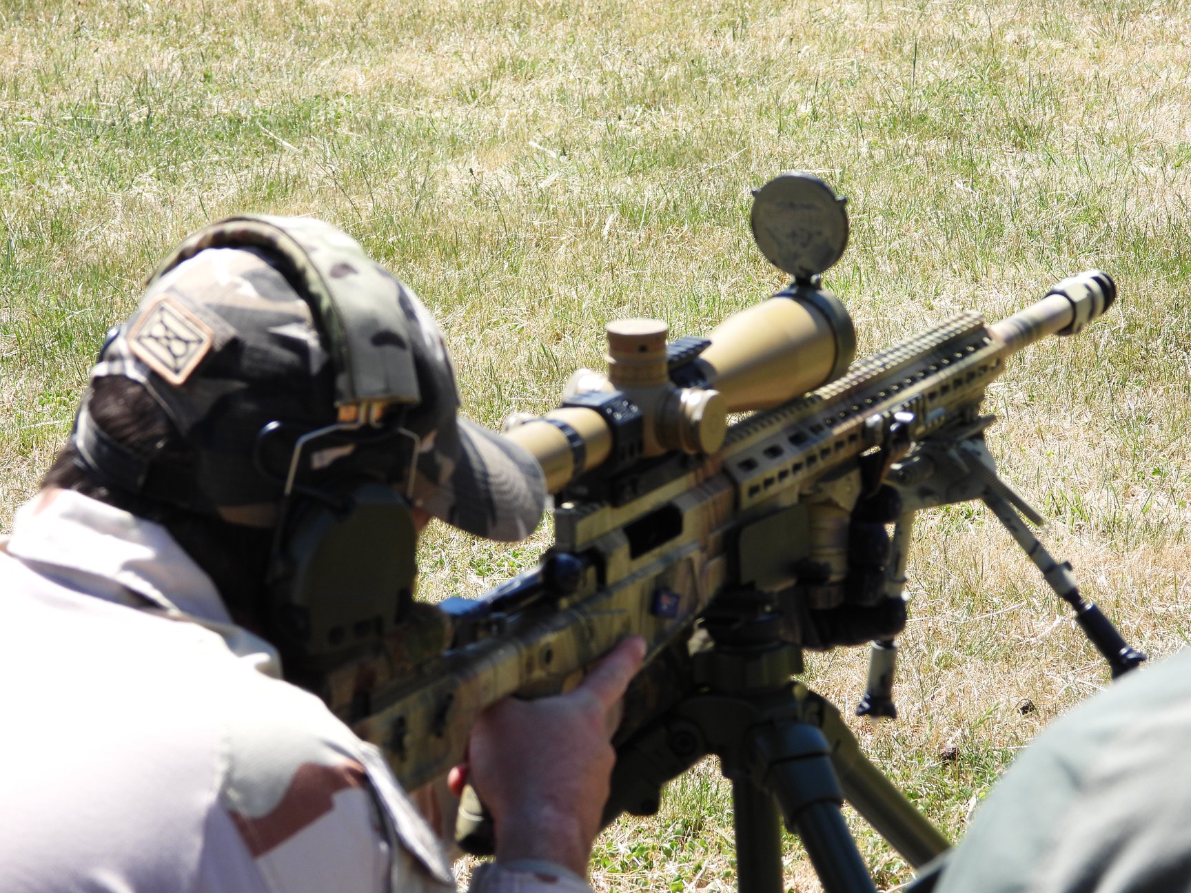

Hello,
I am after a hands on comparison between the above mentioned optics,
Intended use is on a .308 for mostly competition (not PRS) and shooting steel,
I currently have a S&B 5-25 on my rifle, and i understand either will be some type of step down, but I am afterinformed opinions on these 2 particular scopes,
This:
VS:
Would be looking at the Mil XT in the NF, Price difference is fairly large between to 2 optics, I have a LRHS and find it punches well above its price point, hence the consideration.
Thanks for any input.
