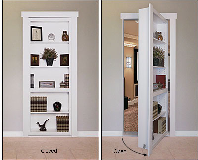

I thought about having what looks like a little broom closet with a false panel leading into the gun room. Fairly cheap to build, and if built and disguised properly, it would be fairly secure. A former neighbor had one, and it was really well done... First you would have to know it is there, then would have to figure out how to gain access to it.
I like these:
Why advertise something of value?
Can be made to be kidproof as well.
R
