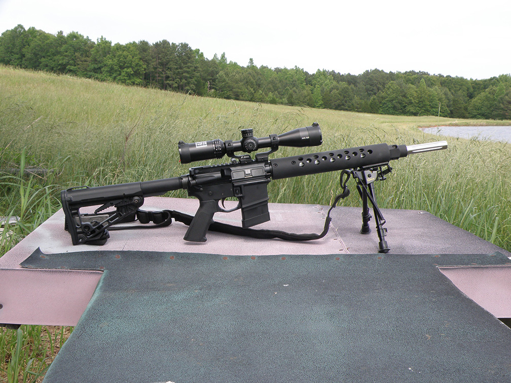

My new WOA 18" 1 in 7" twist complete upper shoots like this at 100 yds and smaller.
They charged me $100 more to flute the barrel.
