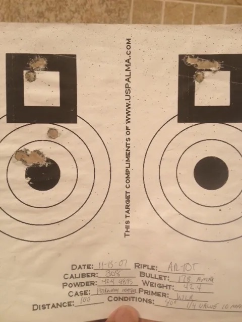

this is a very old picture of what the old barrel did regularly…..
