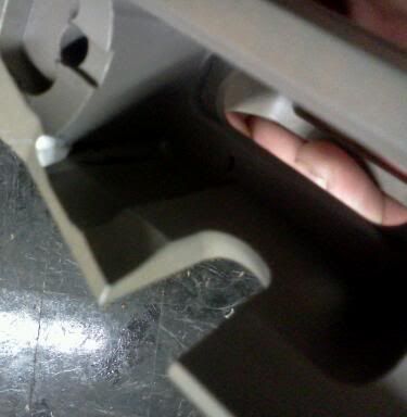

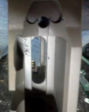

I have a Huber Concepts trigger and I had some problems with it and my chassis. It went in just fine, I just couldn't activate the safety. I ended up taking a chainsaw file and relieving about 1/8" out of the chassis.
It's got enough room now, so everything functions fine. Just wondering if anyone else has had any issues.
