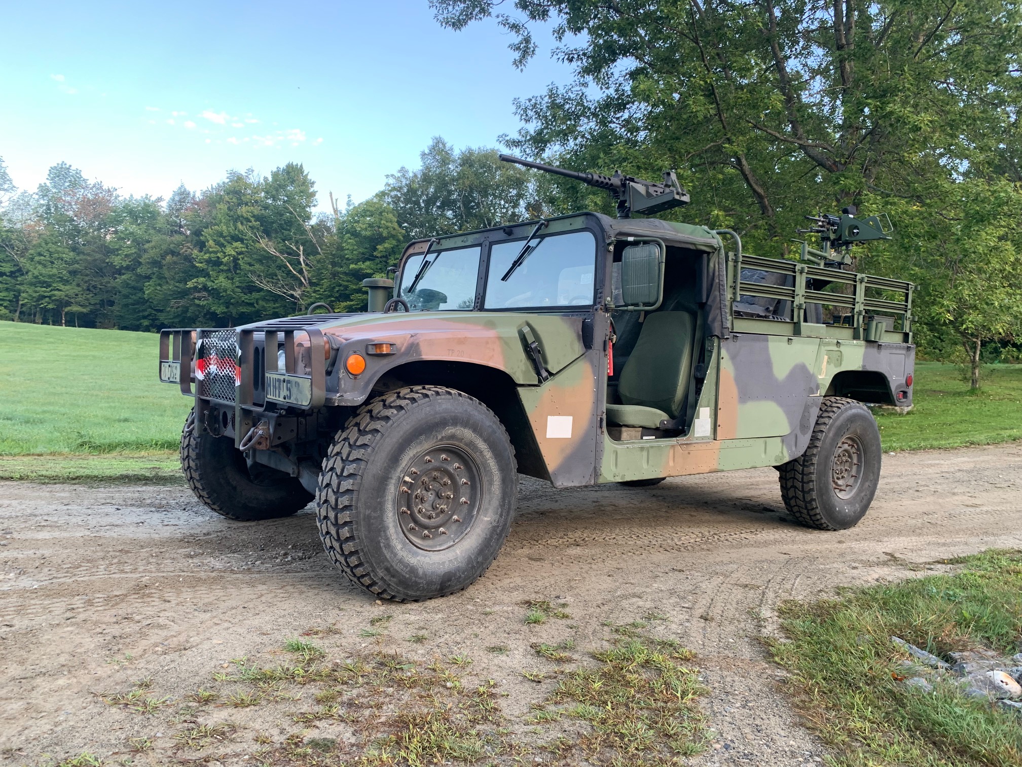

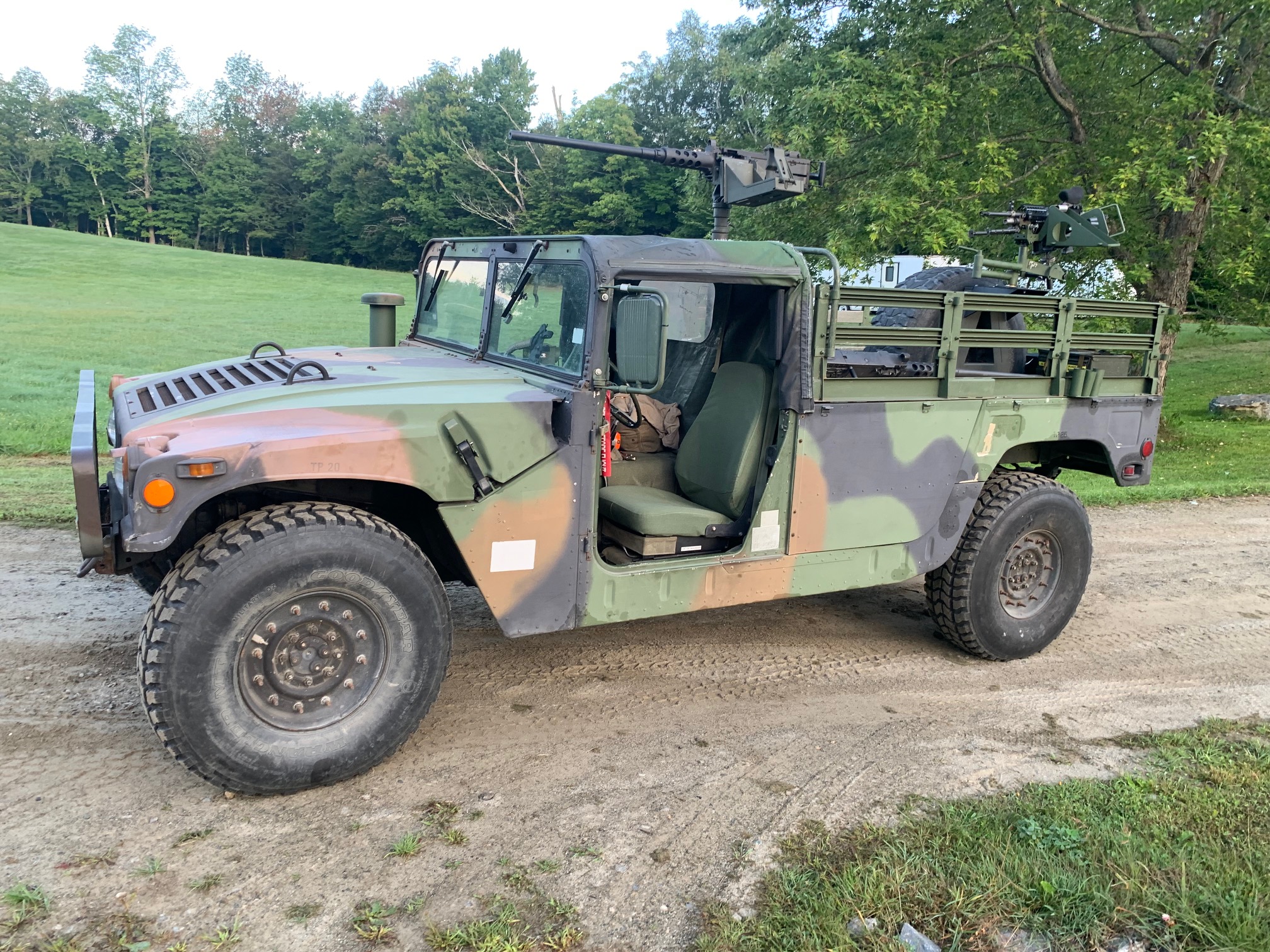

A few tips... first, not being a daily driver is good.
They are a hoot. But you better do your own 'wrenching. You aren't going to find someone to work on it. Period.
They are slow. But who cares. You;re having fun.
Forget GOV. Planet. Buy one from the sucker who BOUGHT one from Gov Planet. Then put thousands into getting it roadworthy. Then found his Wife didn't like it. It won't fit in his suburban garage. Noone wants to work on it. Etc. etc. etc. Buy from the guy who has ALREADY invested in it. I got mine 18 months ago basically running great for $11.5K. That barely buys you a hulk on Gov. Planet. It was a father/son project. They had a blast with it. Son went to college. Dad sold HMMWV. Perfect way to buy one.
If you can find National Guard units (look for the tail numbers), they are way better than ex-Marine ones. (Noone lets the Marines have nice things. Do not buy a USMC Hmmwv.). Second best are the ex-Air Force ones. They never left Tarmac. I think they waxed them.
Problem areas? some have block cracking problems around back cylinders. Natron boxes (the computers) suck. And are $1,000. Glow plugs and injectors often need replacing. Easy to do. But a few hundred dollars in parts. Injector pumps plug up. Easy to fix. But lots of fiddly parts and lose a spring and good luck.
They are noisy. Inside they are like being in a steel drum full of angry wolverines rolling through a gravel pit into a Korean livestock auction. I wear headphones.
Do NOT replace the starter with a key unit. The key unit won't work with the 24V system to transmit enough power and you'll burn out your starter or Natron box. That gets spendy. Carry a lock. Or a 1911 and don't leave it alone in a parking lot. Anyway, secure it some 'other' way than putting in a key conversion.
Keep up on lube services. Geared hubs won't go 5 miles if dry. When you get it... it will be dry. Don't 'just drive home' and think you can get away with it. Unless you know the hubs, etc. are lubed... then have it flat bedded until you can do service.
Last, join G503.com There is a great HMMWV area there. And real experts. Join there before you buy. You may even find good deals in their PX.
They are a total blast! I highly-recommend one. I annoy bicycles and love idling outside the organic foods place. AND I get to park in all the places reserved for "Green Vehicles." (Fuck you, manbun, it's green. Now go suck a dick -- actual quote.)
Oh and they are really fun if you happen to own a SAW or an M2 or both.
Cheers,
Sirhr

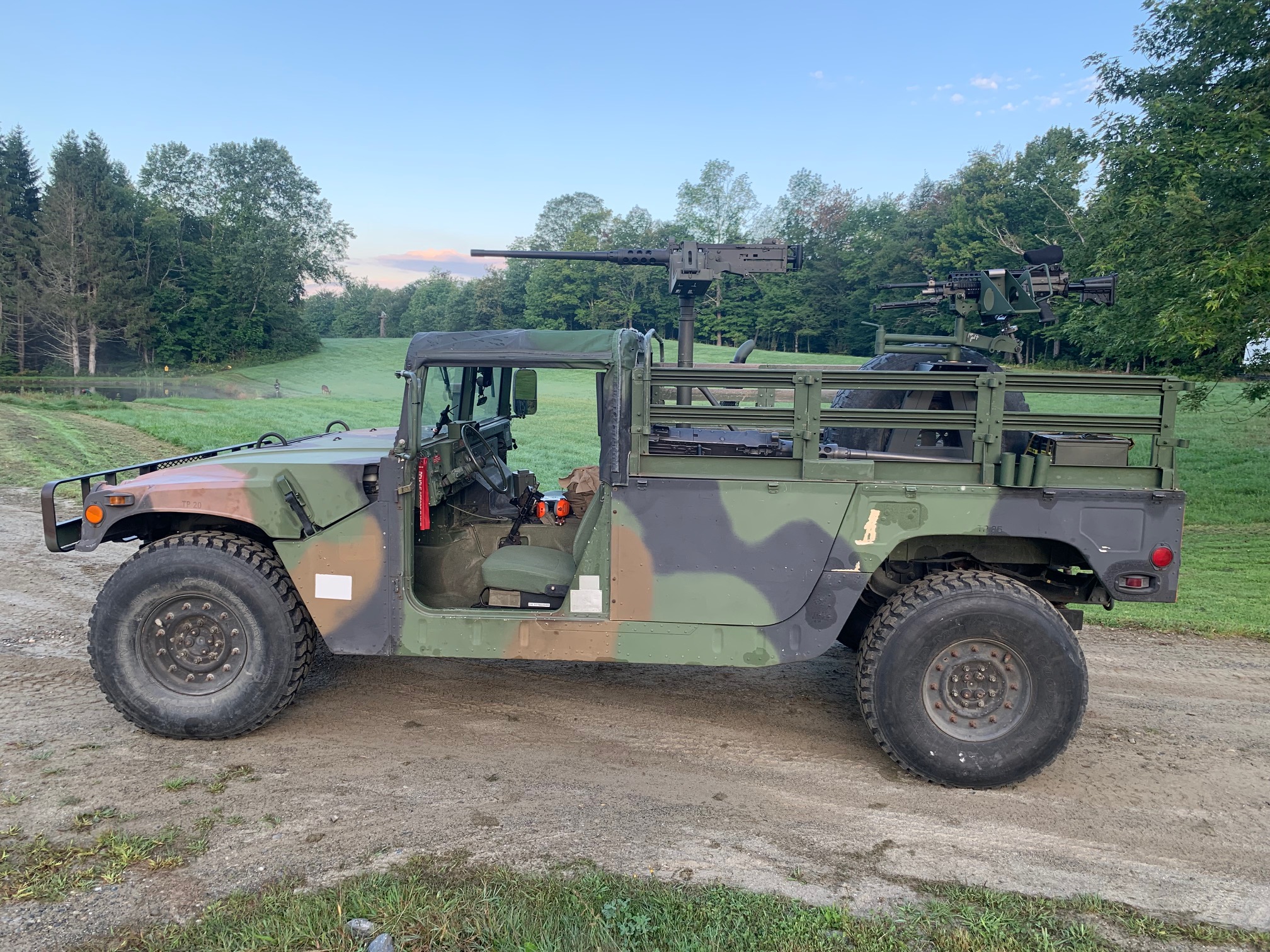

PS... his name is SMAUG.

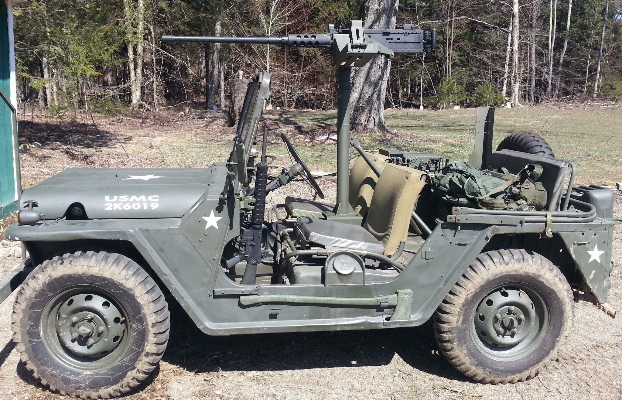

Yeah... I bought mine as a mobile gun mount. Replaced the Mutt. Both are cheaper than tripods these days. And worth less than the guns!
Sold this guy to buy the HMMWV. The Mutt was always fun. And cute. But the HMMWV is just 'in your face.'
As it should be.
Sirhr
Battery cut-offs are fine. Just don't put an ignition key on it.

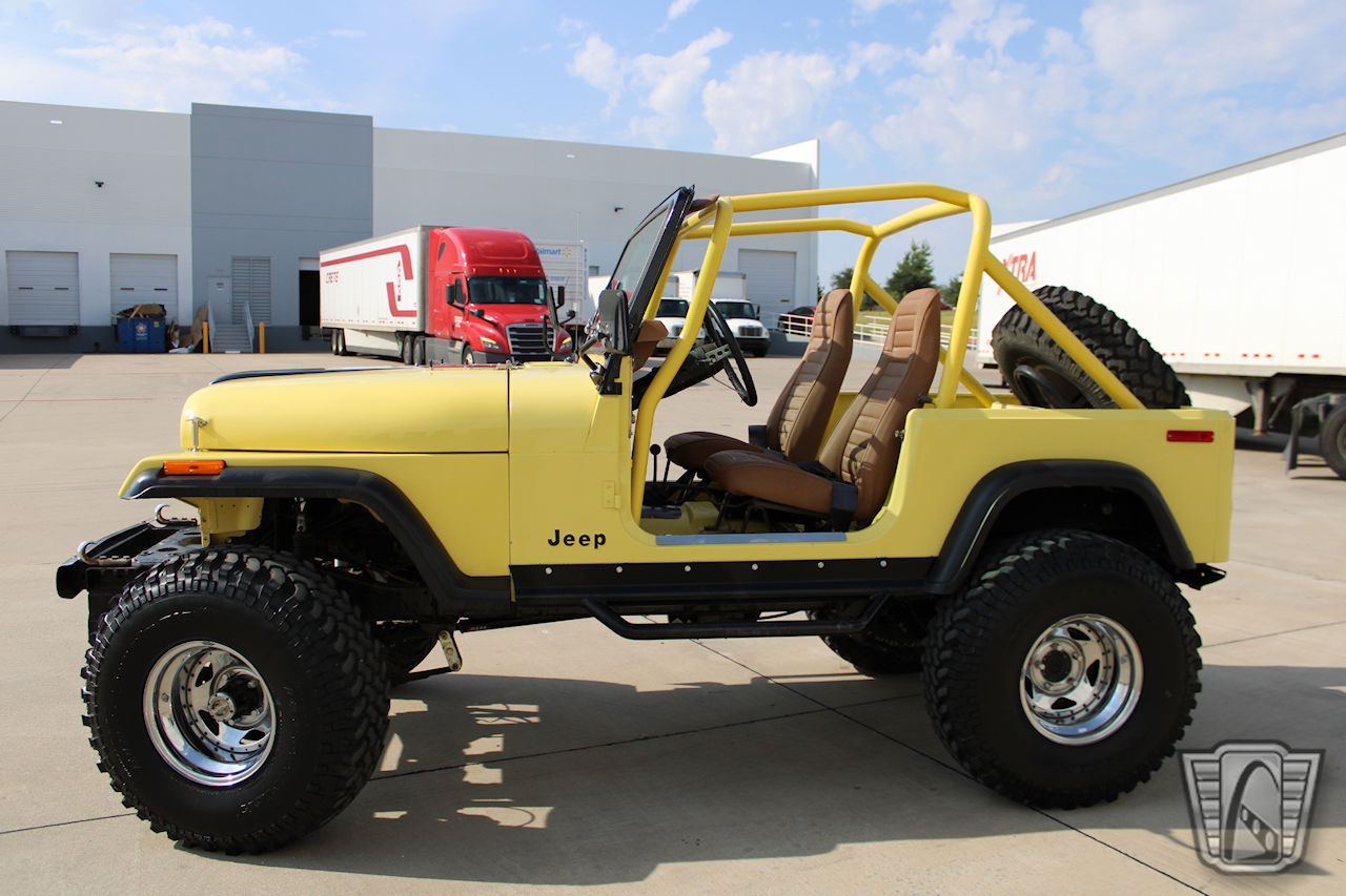

Lol... not 1, but 2 50s....
I was looking at them once, but it was cheaper to put 1 ton axles and lockers in a blazer, which will spank a humvee in most offload situations now. My first blazer eventually ripped the sandwich plates on the steering box through the frame at an off road jamboree in Texas. So I made a hydraulic assist set up for the next one I built, and used some Off Road Design chevy steering box braces. That blazer is actually sitting now waiting for me to strip it for another one, the new one will have a top, doors, and heater because I am getting too old run around in the winter in my topless no door no heat hoopty. The old one only weighed 4500 lbs with a dana 60, 14 bolt, and 38" boggers. The new one will probably tip closer to 5500.
I had a D90 from 1994 - 2001. Loved it. Put 100K miles on it and sold it for WAY more than I paid for it. But the big $$ service bills sucked.
This is my other 'off road' toy.
AMC 401. It... goes.
Now if I can just figure out the carb and the stall converter... I'll be happy.
Sirhr

Yup, I have one. Love it!
Cheers,
Sirhr
When can I come over to play?
