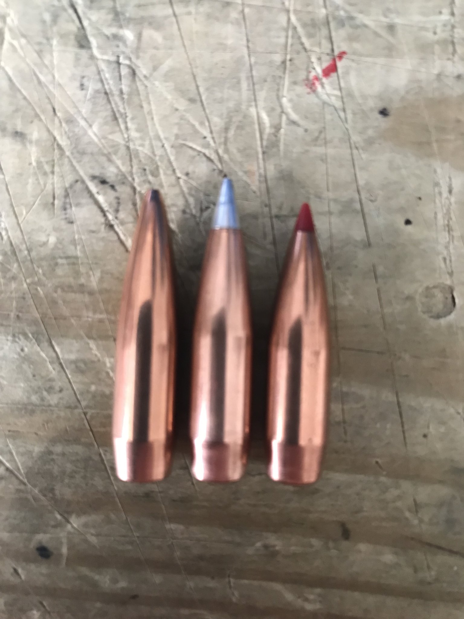

I don’t think they are overly long at all. Below is a pic of the 176 ATip with a 178 BTHP on left and 168 ELD-M on right. I run them in a standard .308 match chamber in a PVA prefit barrel.

Your first picture speaks 1000 words. You’re right, it’s not especially long. Check out the length of the bearing surface on the A-Tip though.
I’m not saying this is a problem, just pointing out a detail that I think is worth considering. In my SAAMI chamber the A-Tips touch the lands at 2.910”. At that length, the boat tail and a few thou of the bearing surface is below the neck/shoulder junction. That’s why I suspect that there is something to be gained with a longer freebore. (I could be totally wrong lol)

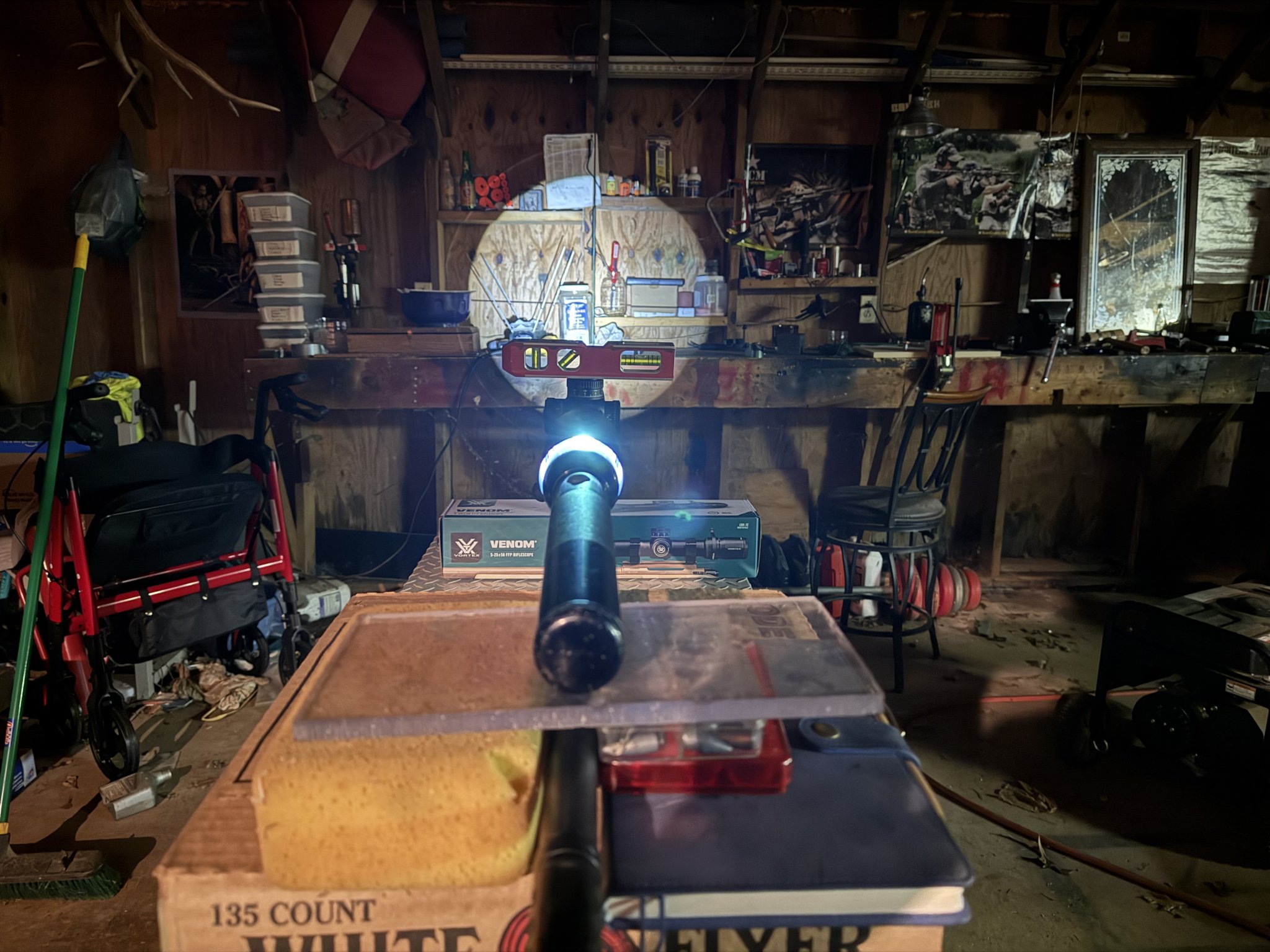

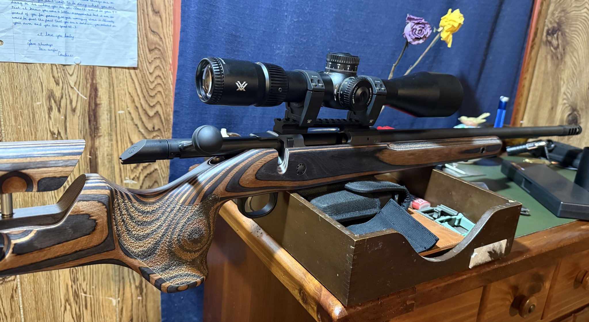

I went with the 1.45” rings…starting to wonder if I shouldn’t have gone with the 1.1’s the comb is maxed out pretty much… scope is at 2.5” above bore.
I got the brake on and the scope mounted and leveled today though… not relevant to the thread just excited and sharing lol

Looks good. The height it is now won’t hurt anything if you are comfortable behind it. My go to now seems to be about 1.26”. It just feels right for me for a ring/mount height.
