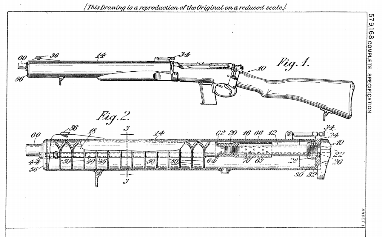

Are you sure the ports are drilled through the rifling? This is the closest thing I can find to a drawing. It almost looks like the piece forward of the barrel is a sleeve threaded onto the end of the barrel with the ports in it. I have no way the scale it but the actual barrel doesn't look to more than 5-6 inches long. Plenty long enough for 45ACP.
Definitely through the barrel. Into the rifling. All the Delisles were made with US Thompson barrels, modified for the purpose.
The barrels you see in the print were not long, and were ported and then a shroud was fitted over the ports to direct gas backwards.
I have a set of MoD prints... very clear.
Cheers, Sirhr
