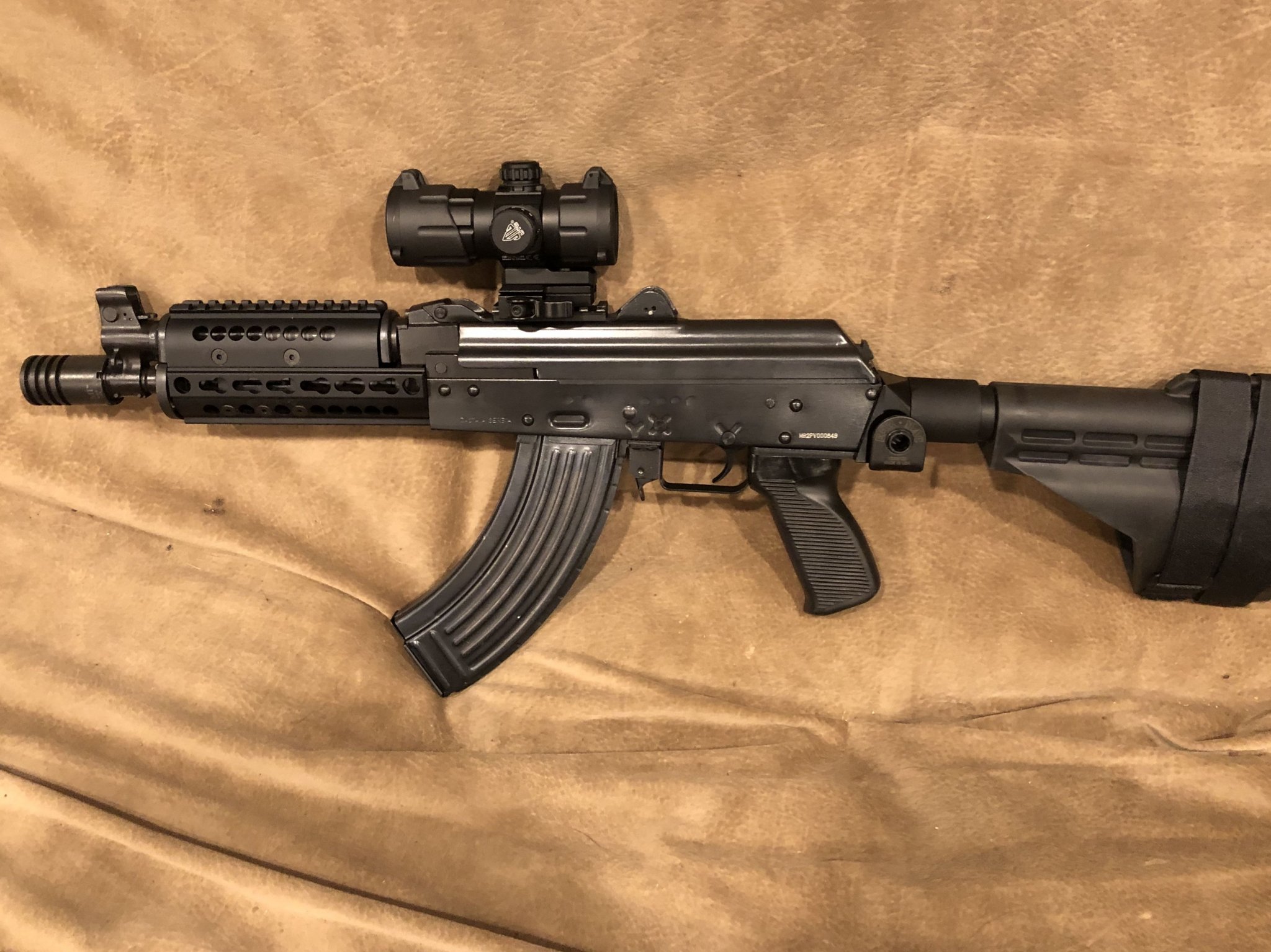

    have had my zastava M92 7.62X39 pistol for 5 years now and have been thinking about putting a can on it'
    it has a 10.25" barrel on it and across my chrono runs 2100-2150 FPS and i have many 10 for ten shots on 10" gongs at 200 yardfs
    and with a 3X scope on itll do it at 300 0n 12" gongs. BUT---it has a terrible flash bang with just the flash hider on it.
    be great for hogs in the thick stuff and deer same.

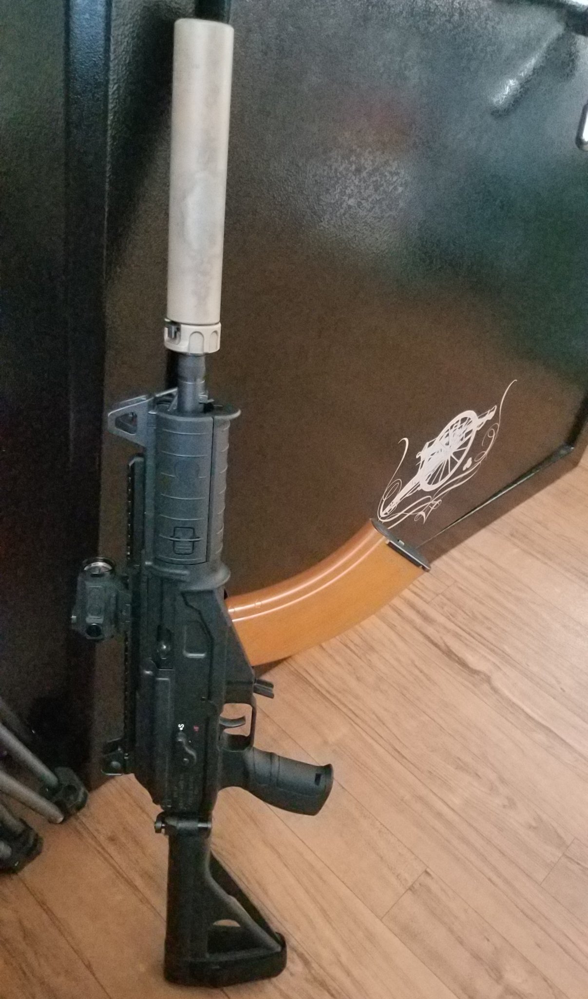

    I have this Sig 556xi russian, now a SBR. It’s ridiculous how much gas I take to the face shooting this left handed, like one of those old motorcycle chase movies. I never run the can anymore. Tromix used to make a piston adjuster for it you could drill to reduce the gas, but unfortunately this is a dead platform anymore. I don’t want to modify the stock parts since I can’t replace them.

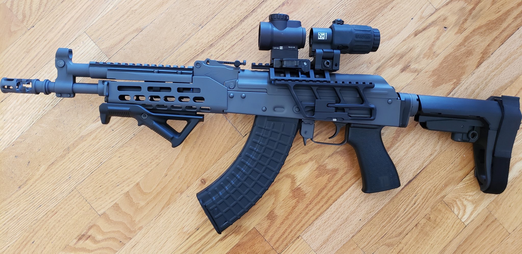

    Bringing this post back to life. Ordered my RD 704 pistol back in Aug 2019 and it arrived 4 months later. Insured the irons were on for my eyes and then the Optics. Can pretty consistently hit a 1/2 ipsic at 300 with Red Army. Now that I have my TBAC Ultra 9", they are both headed back to RD to be married up and tuned. Looking forward to comparing standard velocity and BB 196 Subs. Will report back later.
