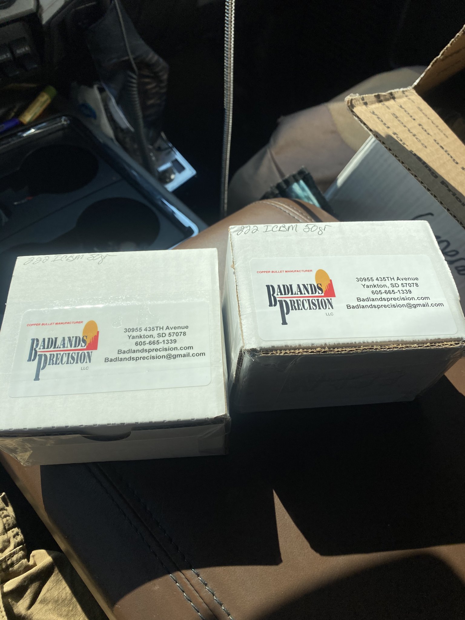

    Just got my next shipment of 50gr Badlands 22lr bullets. Going to do a bit more load development in a couple weeks and get some good solid radar data.
    Who else on here has it is getting a barre to shoot the new heavy copper solids?
