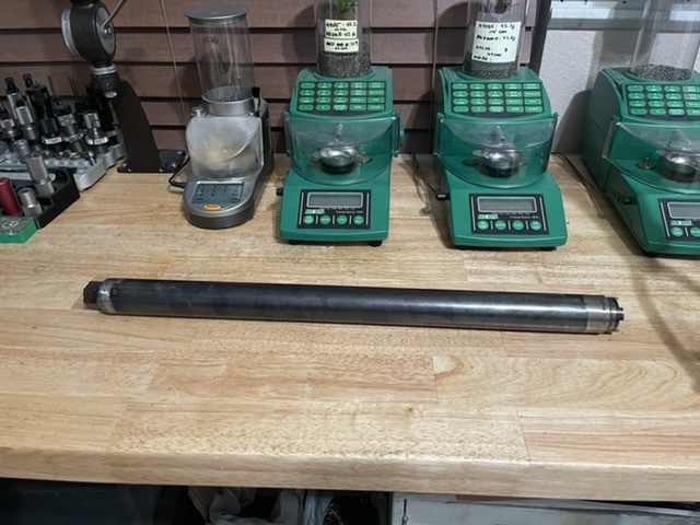

Well, if you end up having no luck there and if you want, ill send you dimensions to this one so you can have a fab shop make you a copy. Its just a steel tube with cut outs on one end and a hex - 1/2 square drive on the other. Designed specifically for KAC SR25 barrel nuts.
Well, if you end up having no luck there and if you want, ill send you dimensions to this one so you can have a fab shop make you a copy. Its just a steel tube with cut outs on one end and a hex - 1/2 square drive on the other. Designed specifically for KAC SR25 barrel nuts. View attachment 7971588

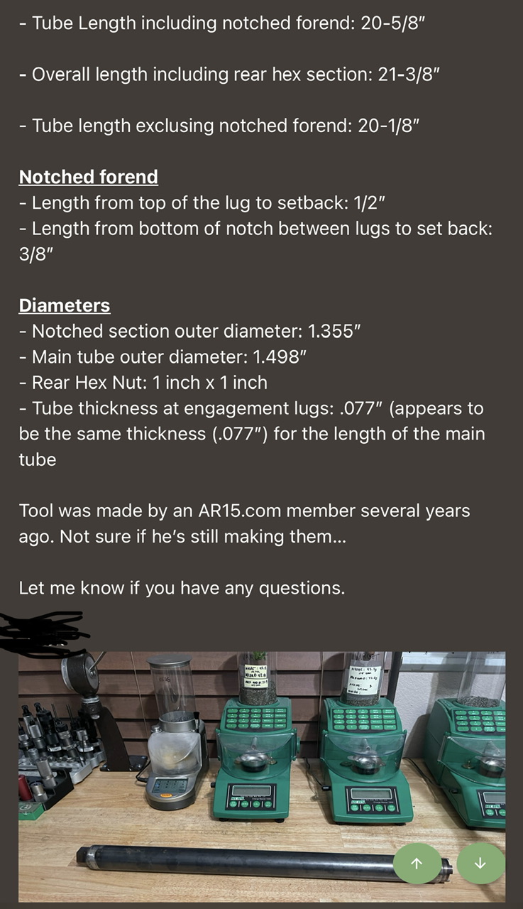

I would very much like the dimensions for this wrench if you don’t mind.
Here’s the dimensions I gave to @PizzaBox; have no clue if any of that helped as i never received a response, not even a “thank you” from the fucking guy. Hopefully it helps you and anyone else that could use them to fab the tool.
Thank you very much. I am already talking to a local guy, if it comes out nice I will offer up for use to everyone
You’re welcome. Hope it turns out well; perhaps he can make some for folks on here who are looking for that tool.
