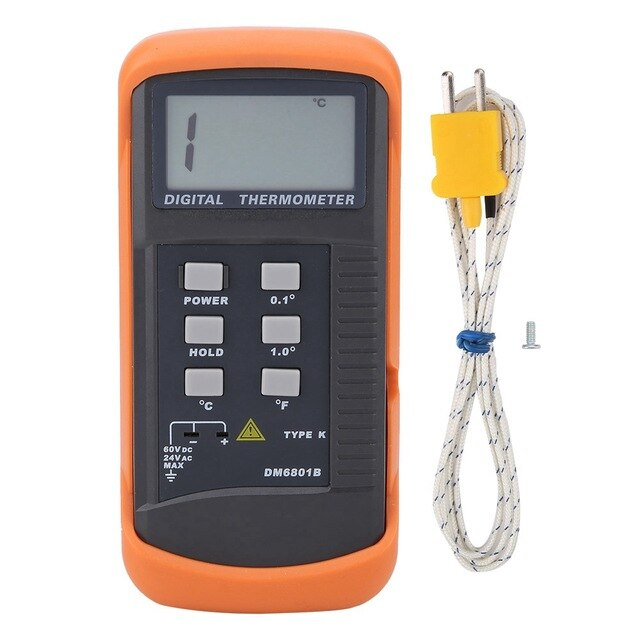

You need to google search for this:
Digital Thermocouple Thermometer Temperature Dual-channel Backlight Meter Tester
7092617
+1

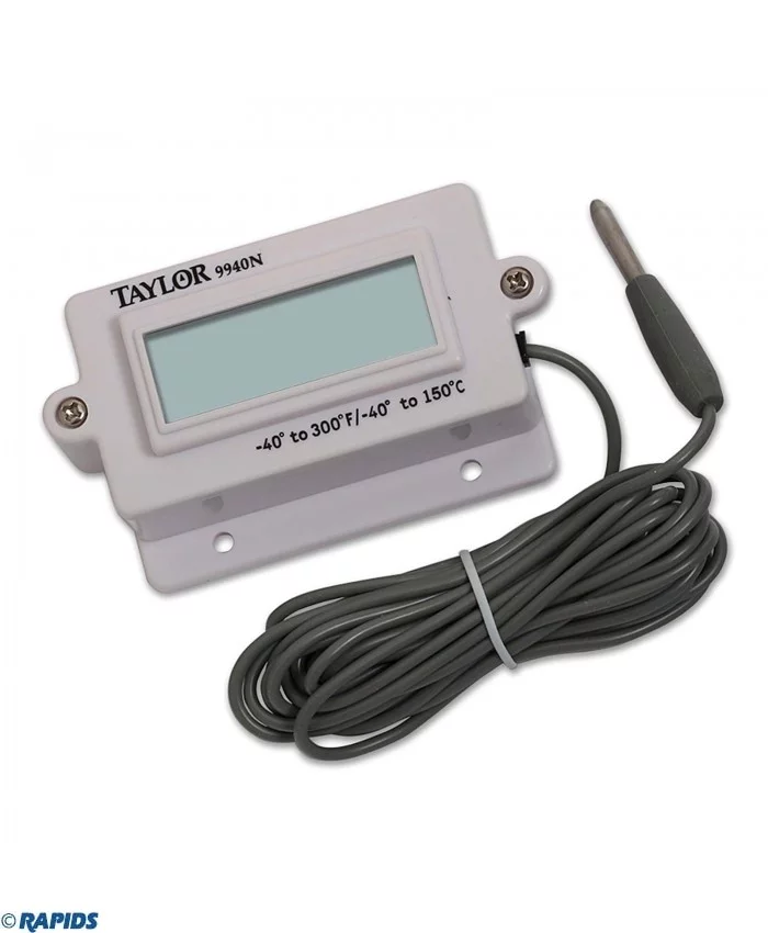

thanks for the help. What I am looking for is a thermometer that has a remote gauge. The probe is about 6 feet long and the gauge mounts on the wall behind the tanks. I have the tank thermometers but you have to be right on top of the tank to read them and they always get fogged up or splashed on.
