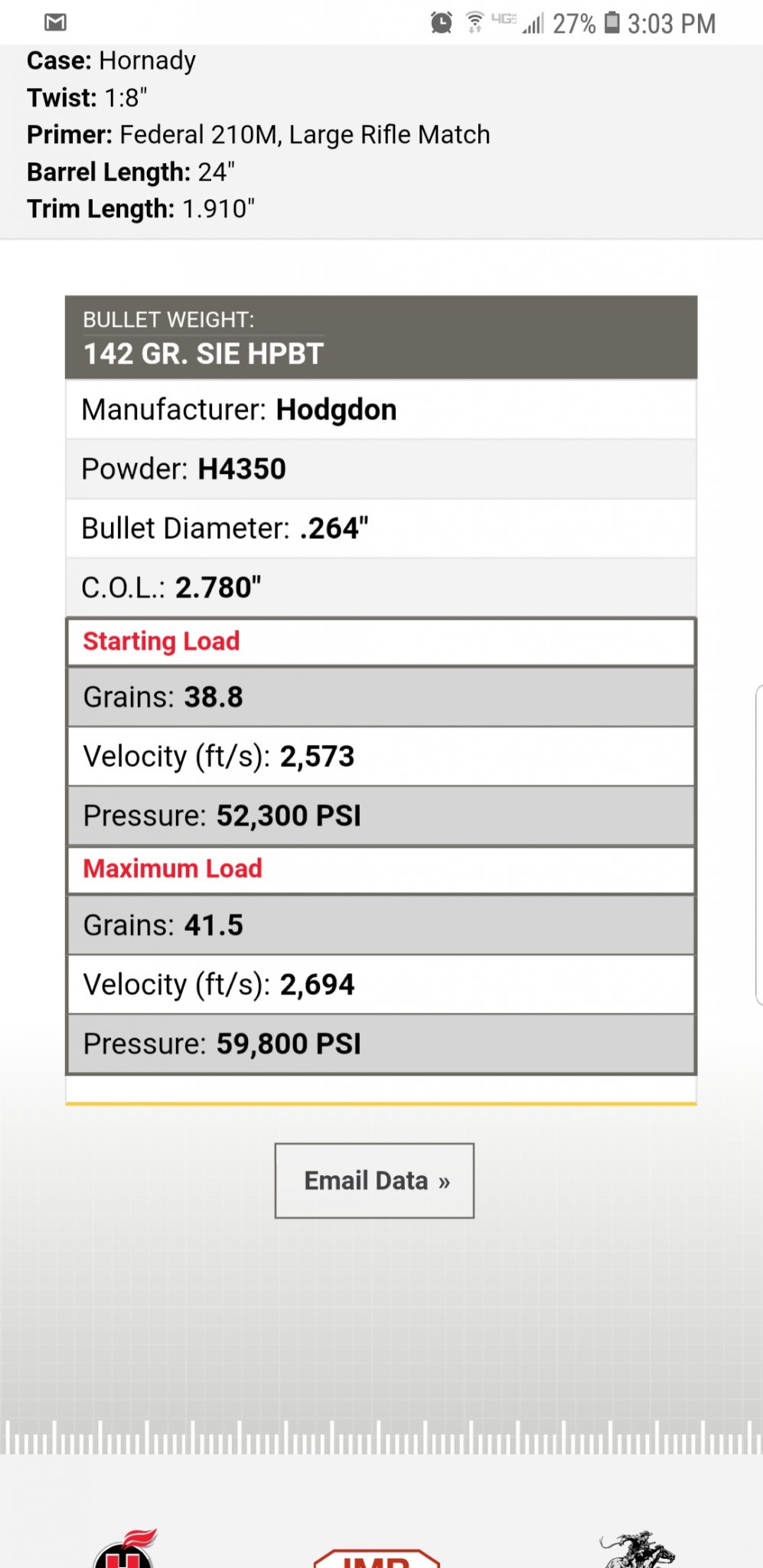

Thanks for the book data, I have Hornady's newest manual and have measured for Cartridge Base to Ogive, COAL, and measured shoulder bump from fired factory rounds. Just trying to see what people with Havak's are getting good results with. I only have H4350 at the moment and only 2lbs so I'm trying to start from a known accuracy node.
Let your rifle tell you that. I will say Hodgdon is fairly conservative with their published data, but start low and work your way up. H4350 is becoming readily available in my area so be on the lookout for more.
