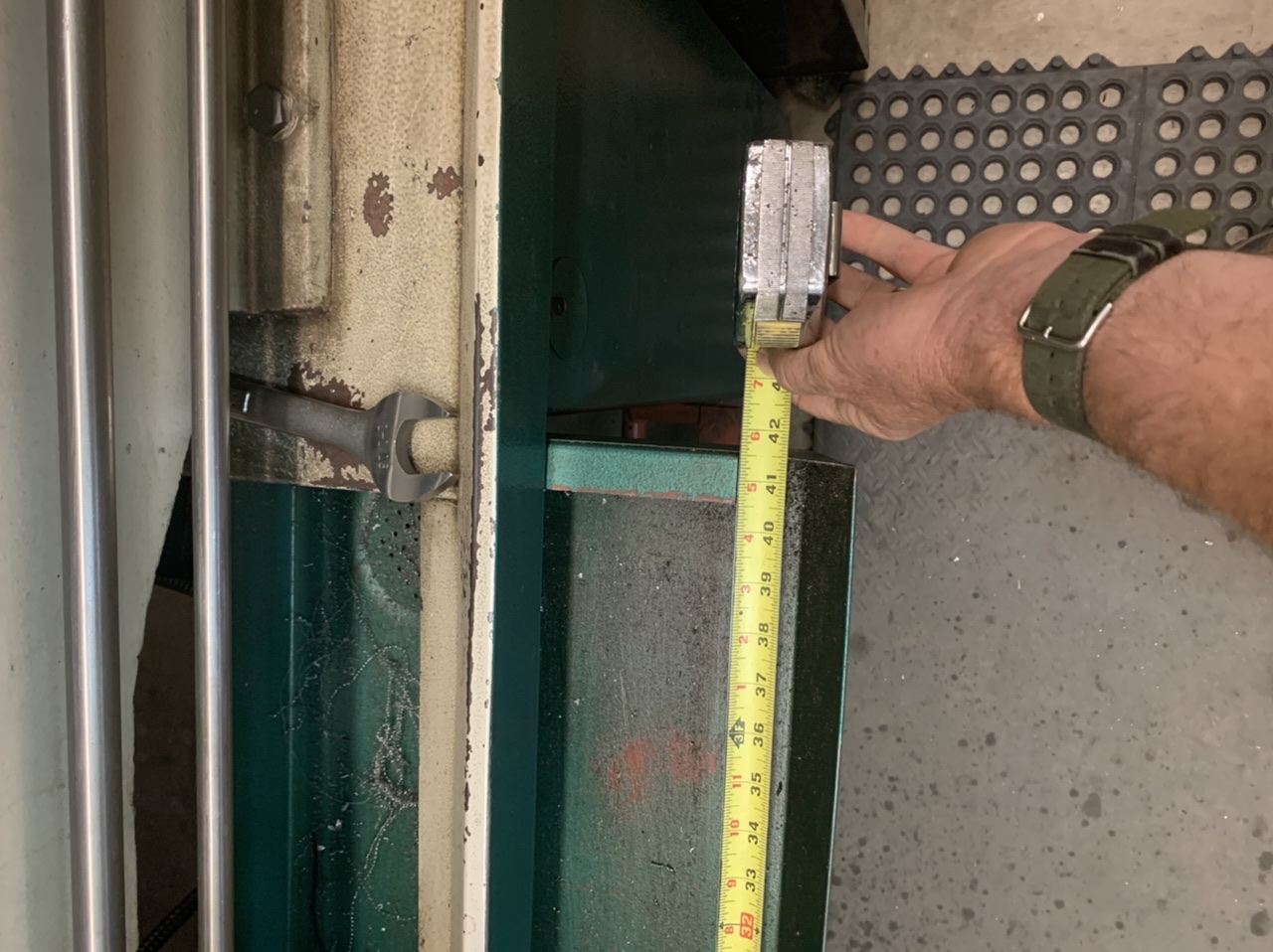

I have an old 13-1/2 x40 that looks to be very similar, but without a slide-out chip pan.
During clean-up, I'm tired if trying to get my hand and various other things up under the bed to clean out chips.
I'm thinking about putting a G0709 chip pan on my lathe, but I'm not certain if my pedestals are far enough apart. I have 41-3/4" between the pedestals.
How wide is the pull-out pan on the G0709?
I'm hoping someone here owns one and would be willing to give me the outside-to-outside measurements across the top of the vertical sidewalls, and the width of the front fascia.

I believe @forrestgump01, @Tac284 and @338RUM runner have one, if they're still around.
I have a 0709 and here is the width of the chip pan.....good luck with your project
I have a 0709 and here is the width of the chip pan.....good luck with your projectView attachment 7518550
Great! Thank you for taking the time to measure that, it is very much appreciated.
Looks like it's going to fit fine, with 1/8" of clearance per side. There won't be enough space for the soft-close slides, but easily doable with some steel angle.
I went ahead and ordered the pan from Grizzly. I have some leftover PPG basecoat and clear from a Ducati and Triumph I painted a couple years ago. After I get it all assembled, I think I'll use up that old PPG on the stand, chip pans and backsplash shield.
Thanks for the help.
