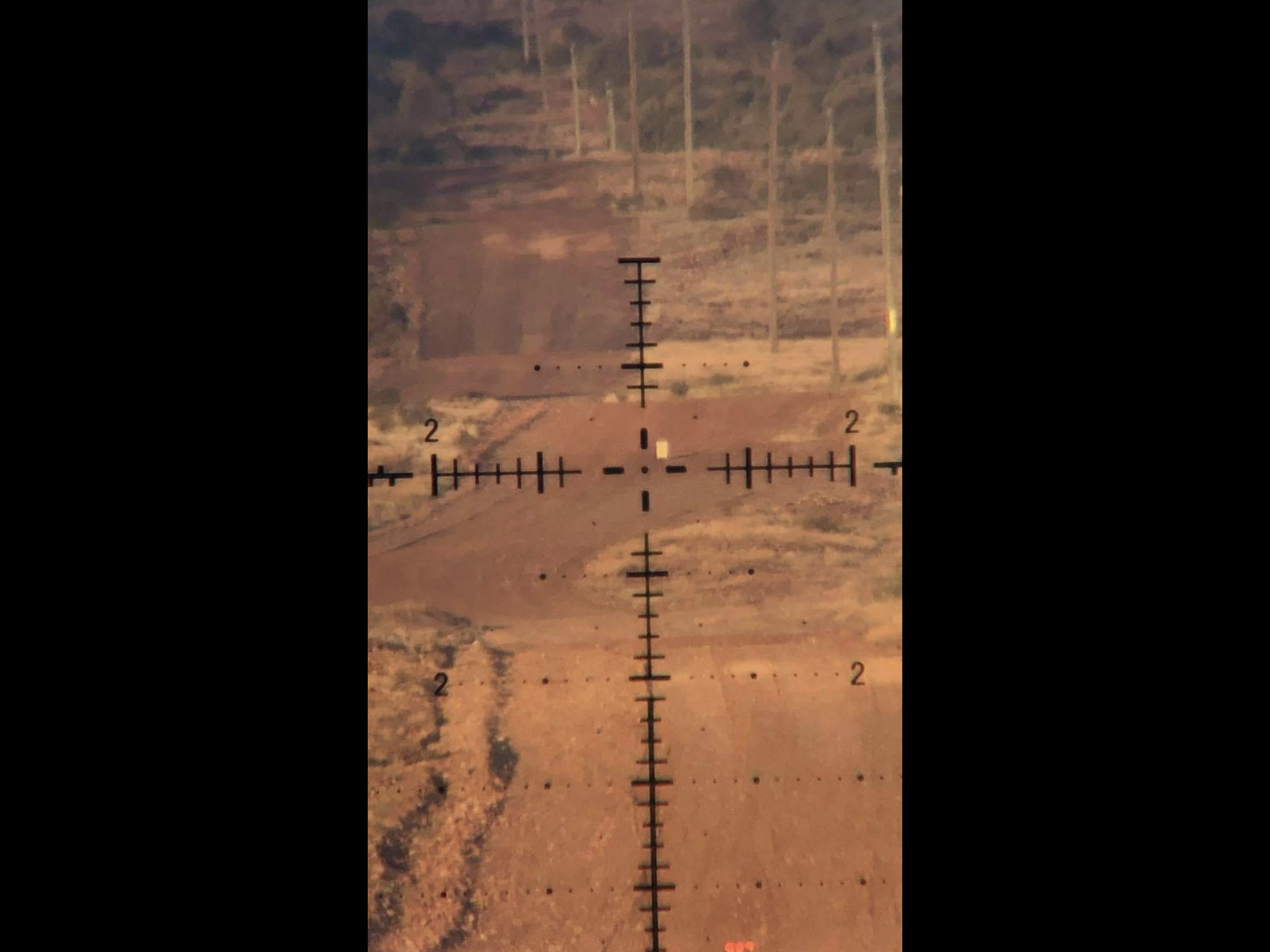

    Here’s a low res mobile phone pic through a 4-40 with Ilya’s reticle. I didn’t take this
    pic personally, it was sent to me by one of the ELR testing crew. Target is over 3000
    meters and is (approx) 20 x 12 inches: optically the 4-40 is very good.

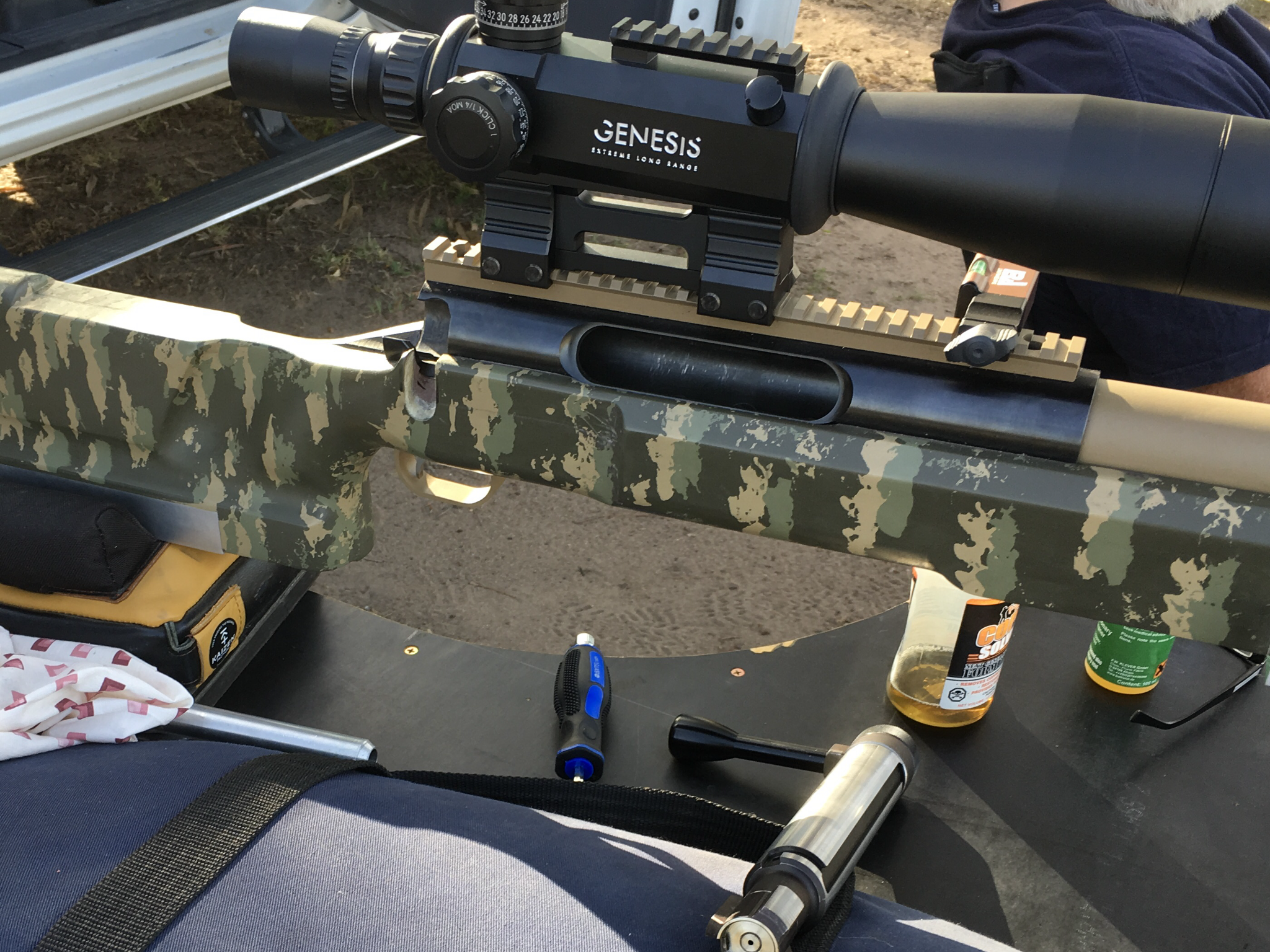

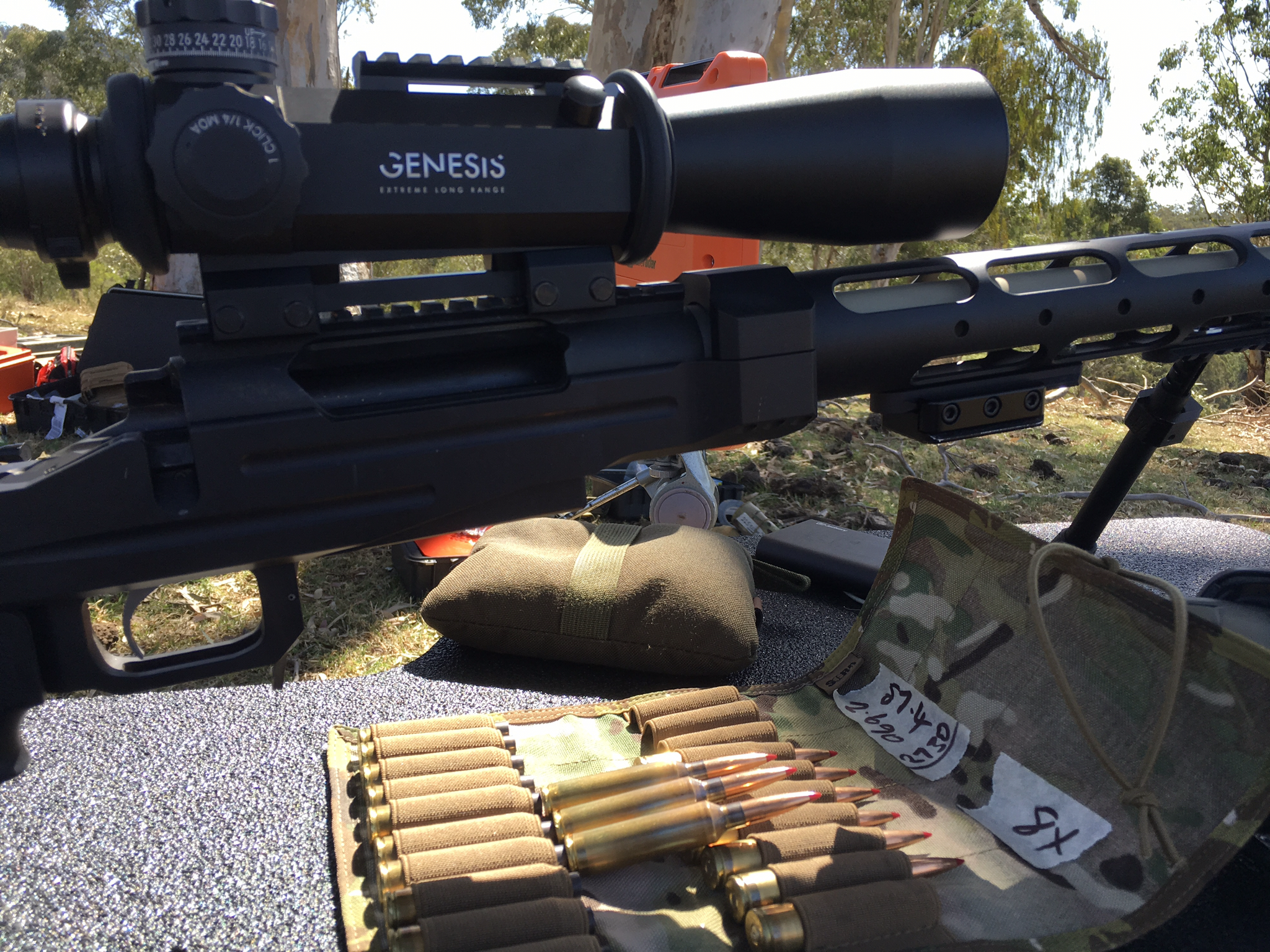

    One very useful addition with every Genesis scope, is the inclusion of multiple height
    mounts. Standard height is fine out to at least 3000 yards with 338LM, without any
    barrel obstruction issues. See first pic below, optic dialled for 2900 meters, 30 inch
    barrel, no obvious visual obstruction. Top rail for other toys included.
    If you add the cost of a Tier One optic + Taco vs Genesis, price win goes either way
    depending on models selected. Optically, the Genesis is going to be better, as you will
    be looking through fewer pieces of glass. The Tacos are rocksteady devices, but if
    you don’t have a chassis system with a rail, you then have to factor in getting it custom
    mounted to your optic or stock, which is more $. Some optics may not enjoy having
    a Taco hanging off their front end.
    Second pic below shows the included high mount system on a McMillan 50BR stock
    with a Barnard 50BMG action, 36 inch barrel. Should be able to max out the Genesis
    in this configuration without obstruction, and theoretically plink to 5000+ meters with
    a hot 375/416 and solids. Hit % at that distance is up to you and Mr Wind. 🙂
