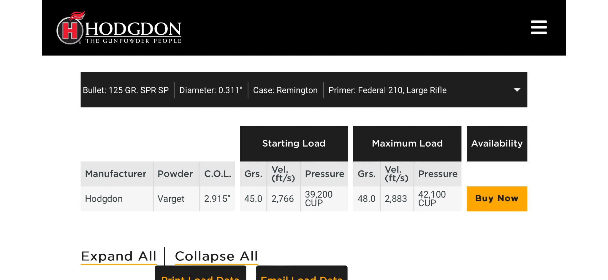

    Was in my Hornady manual working up a load for a 125 grainer for an experiment (helping a buddy try and find a good load for this old enfield) and noticed Varget wasn't on there, but only some odd no name powders. H4895's there but I dont have any at the moment :(
    Anyone use anything else for the light 125 grainers by chance?

    for such a light for caliber bullet, varget is getting a bit on the slow side (but will still work)

    That light of bullet I would go IMR 3031, and the near similar burning powders.
    I load 150 SIE Pro Hunters N140, N540, AA2520, RL15. You could try those too.
