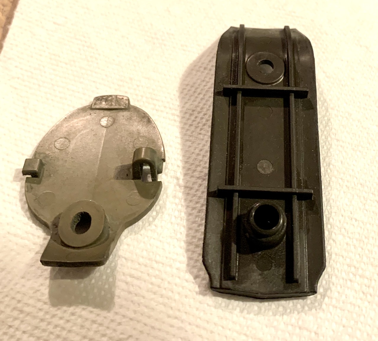

Test 1
The polymer will definitely take the dye. It will show the original color if you take a knife to it but it won't transfer to paper after scrubbing. I think the color is a very close match to Magpul OD. The Aervoe on the other side took the dye perfectly too for whatever that's worth.

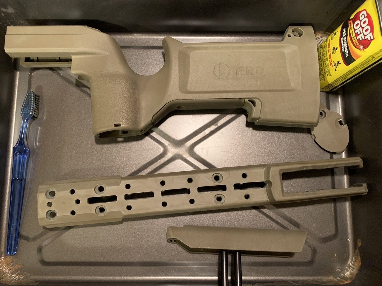

Thanks. I've got a lot of paint to get out of nooks and crannies. The Aervoe actually came off easily but the Krylon Fusion has been a real bitch. It leaves a very thin layer of color that really does seem to be fused to the surface of the polymer. I've hit it with everything from Citristrip to brake cleaner and it's slow going. I can say that I haven't come across any chemical yet that will damage the plastic (I won't chance Jasco or similar). It is very tough.

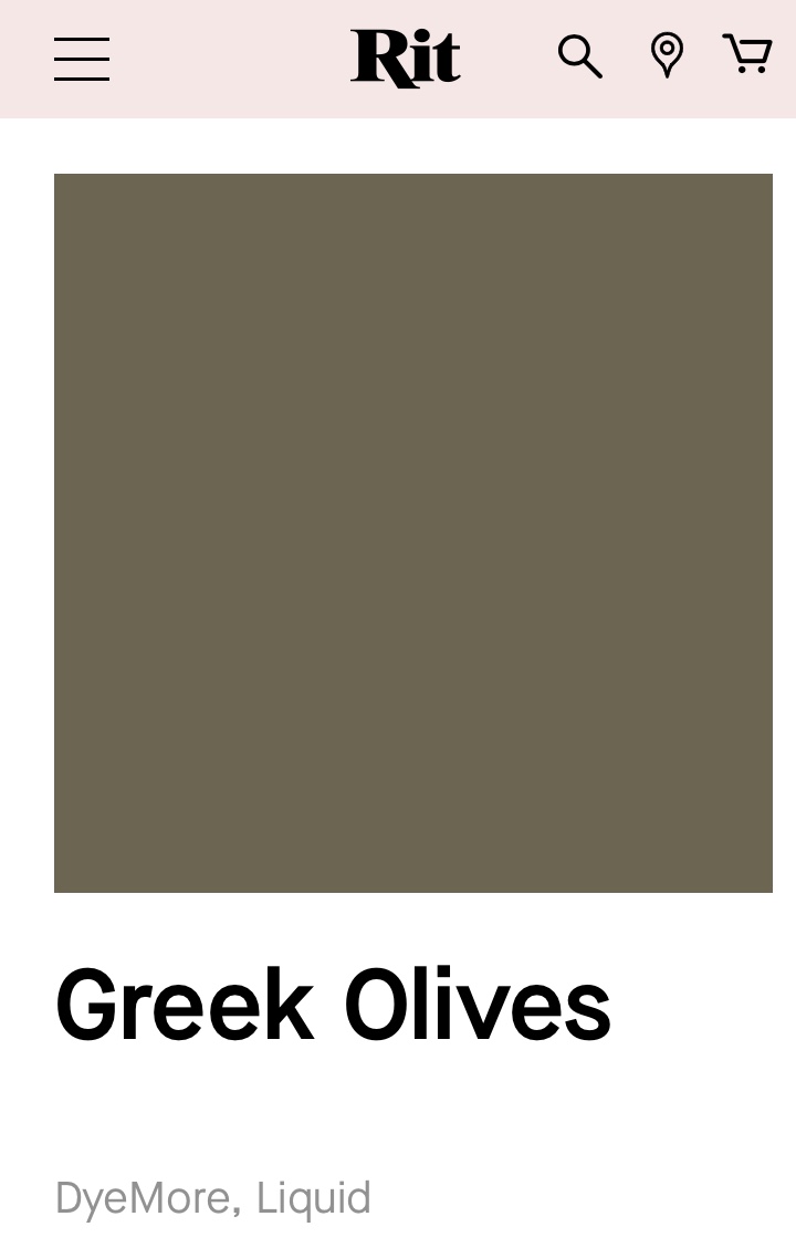

I found that Goof Off and a q-tip works great for crevices. I have almost everything cleaned and ready to go. I should be able to post up a picture tomorrow afternoon. I'm going with a Rit formula called Greek Olives which is more of a brown od. It'll be darker than the picture because of the underlying FDE but it should work well with the KRG fde because it already has a bit of greenish tint.

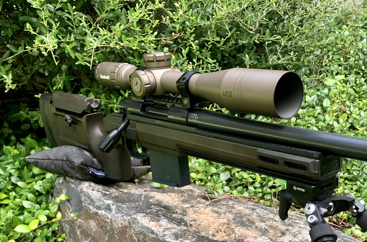

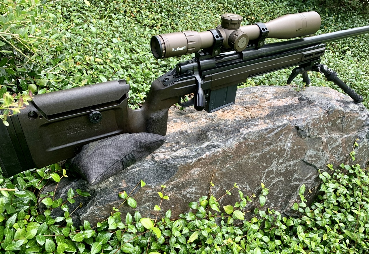

Done. It looks a little browner in real life, I would probably opt for the Olivine Green formula over most FDE polymers for a more green OD.

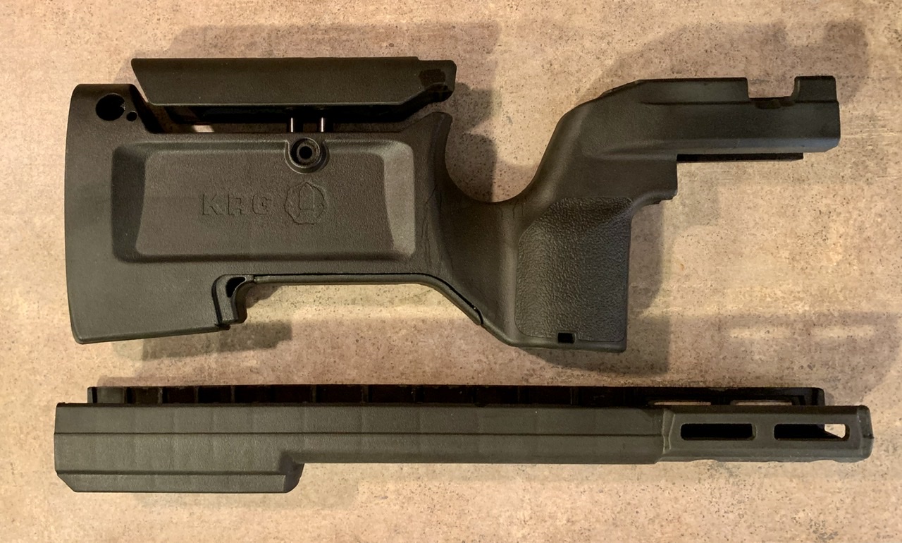

Here's the original for comparison:
