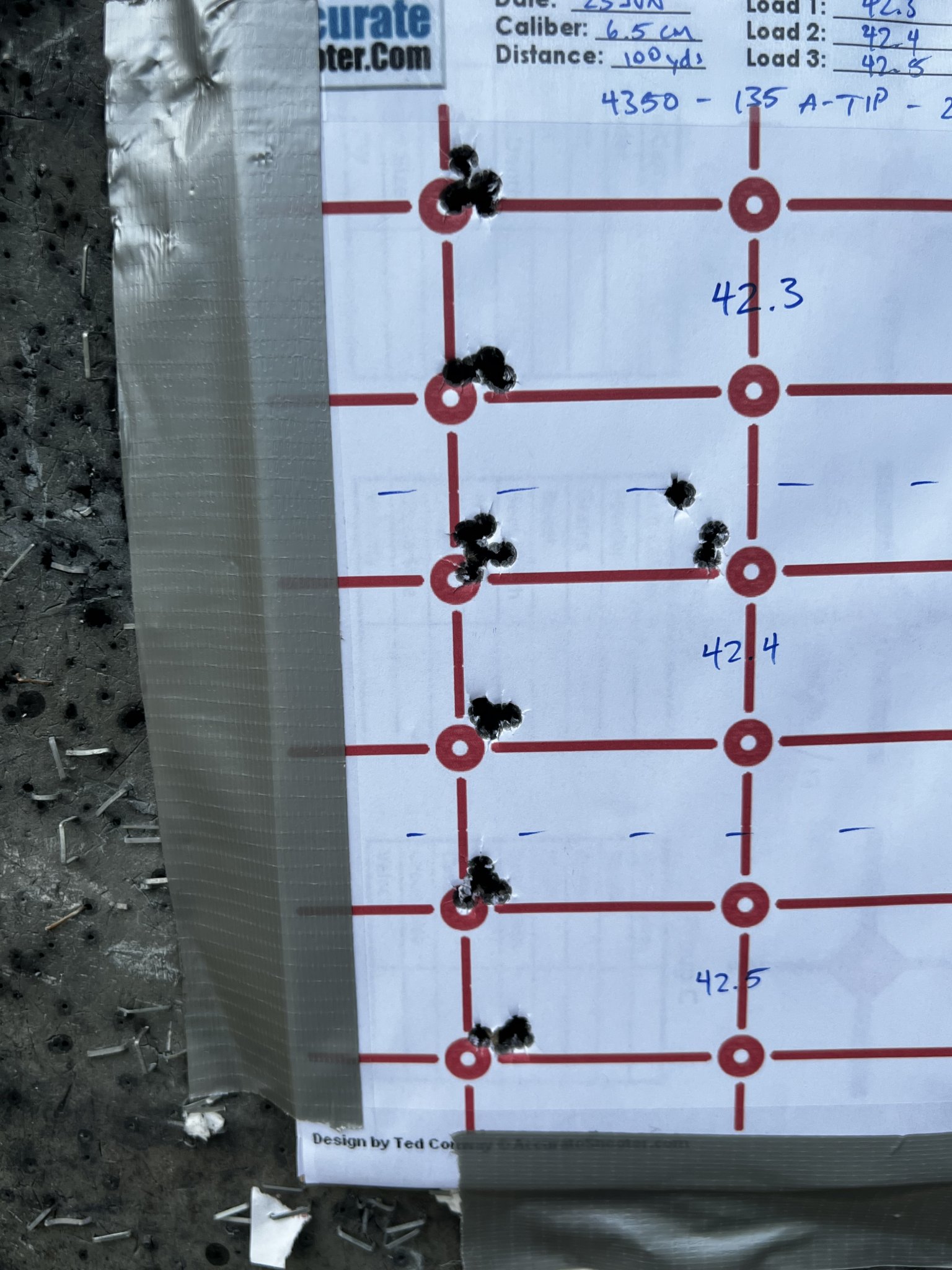

Obviously I’m going to use the caveat “work up” here but I was able to get into the 42s comfortably with this combo in my ATX.
Spreads were within 20fps of each other (as referenced by the same POI on all the groups) and the average speed was 2850 out of a factory 24” barrel.
Ignore the 3 on the right… fouling a removed/reinstalled/clean barrel. Adjusted zero and shot the 6 groups on the left.
Reactions: AllenOne1
