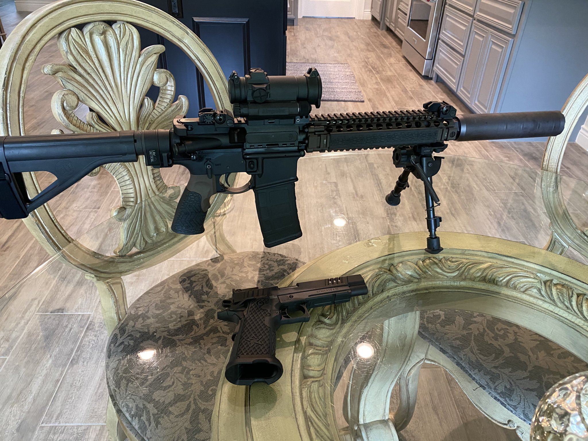

    I do. A bit over gassed with my 5.56 Surefire SOCOM but, as long as you are not doing mag dumps, it won't be too trashy.
    I have since SBR'd this rifle and put a DD stock on it.
    The 10.3 is currently my favorite AR setup, even over my suppressed 16” KAC.
