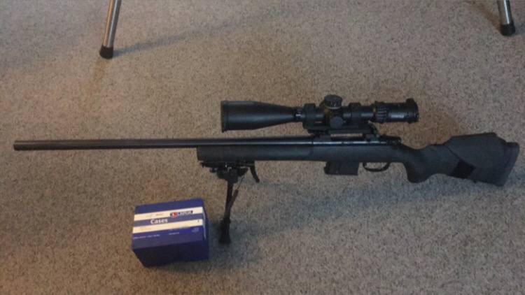

Yes. I have four rifles with set triggers. This is my cz Kevlar.308. I’ve used it in prs/sniper competitions a few times. The set feature was costing me a second or two on each shot, so I don’t use it for that. I use the set trigger for other purposes, but find it to not be useful at all in prs style competition. Your mileage may very. I’d be more likely to keep track of time and use the set trigger at the end of a stage with extra time on the last few than fiddle around on the first shot trying to get set up toward the target etc. 2 different trigger pulls in competition was completely distracting to me. To the point I abandoned the set feature on the first stage. I would love to hear the logic behind a set trigger on a tactical long range rifle? Real world or competition world.

Yes, CZ 550. It's quick and easy compared to a two trigger set type trigger. Just push forward before pulling. They were adjustable for both the set and standard, but I believe the standard was only adjustable down to 2 lbs. reliably when the set was adjusted down. I put the set at about one pound, and the regular pull at 2 1/2 lbs.
I can see what the guys are saying above in that two different pulls, and the speed lost to change them, makes it better to just adjust the trigger to one light poundage. And, get used to that only. A two stage is kind of the same thing. A half a pound of spring pull to the release then another half pound to let the sear go. A little light, IMO, for packing around. I prefer an adjustable trigger where I can put 2 to 2 1/2 pounds on and take the creep way out. Hair trigger but with some weight behind it. I've seen a lot of guys adjust triggers and not understand that. Also, stoning surfaces so the sear and striker faces are not grabbing during release.
Overall, I'd say it's usable in PRS, but the two stage or well fitted/adjusted trigger is going to give you the same without the time lost to set it before each shot. Not many stages are that short on time for what it takes to set that trigger. The stages where you try to hit as many as you can in a given time, it would be a fiasco for the shooter.
