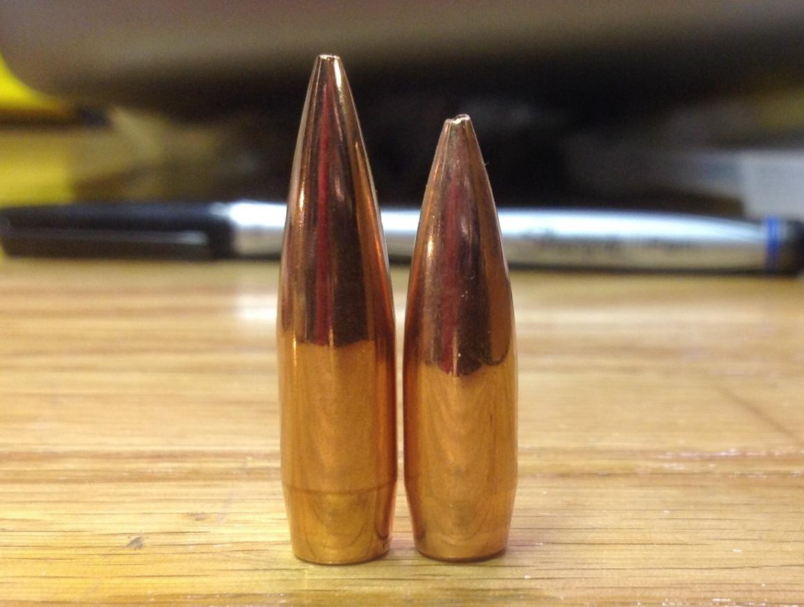

I use the Nosler 155's CC in my 16" .308. 2600 fps easy acheived with IMR 8208 great accuracy works good to up 800 meters.
I have a thousand 155CCs I've been planning to give a shot, but when I compared them side by side with the scenar I didn't think they would offer much stability past 600yds.
See attached.
