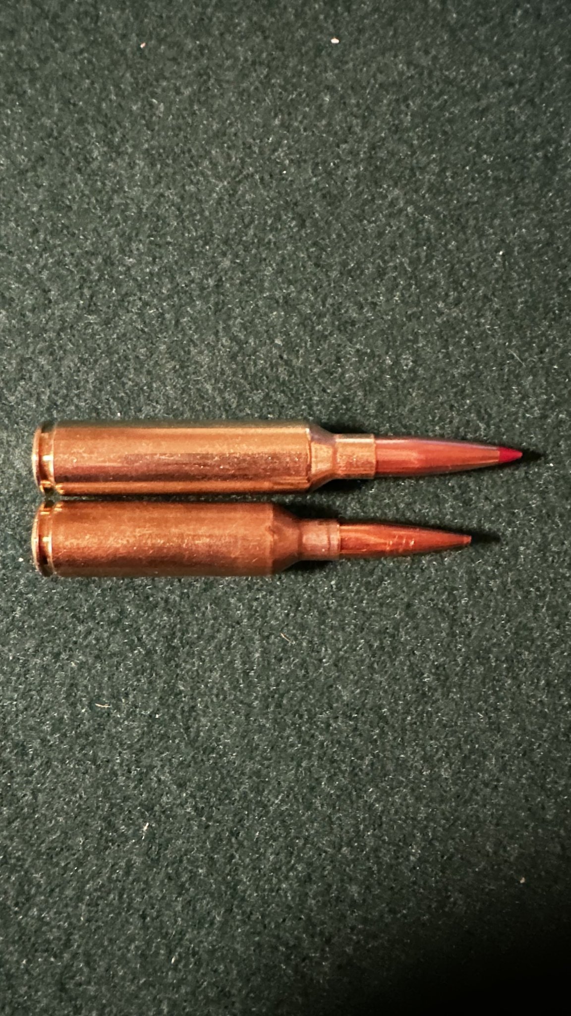

    I Think I've narrowed my choice to this cartridge, seems to be to shoot flatter than 300 PRC or WinMag or 6.5 PRC with less recoil than any of them. Looking at a Christensen Arms Mesa Long Range. Will need ammo, any suggestions of LR accuracy or is it dependent on your rifle. I already know that , but thoughts? Looks like HOrnady is the only one making it so far.

    How far are you looking to reliably make impacts? I wouldn't worry to much about how flat it shoots, gravity is a constant. Look at the wind deflection. Also at distance being able to see the splash from a bigger bullet makes a big difference also.

    I want to hit at a mile. Further if it hapens. My 6.5 Manbun is giving out befor a mile. I'd rather get a tool that will do the job easily than tweek one to just make it, so 7mm sounds like the one...should make 2K I think.
    I've had a lot of success with 7mm PRC at a mile, think it is a great round for that. As mentioned, the smaller you go in caliber the harder it is to see hits and misses. Pushing much beyond a mile, I like my 300 Norma. Around a mile, my 300 Norma load cuts the wind better by about 1/2 mil than the PRC. Recoil is negligible.

    Oh ya we chatted in that other thread. Ya a 7 PRC will do a mile-2K but a big 30 will do it better. I'd say don't short change yourself but if you are stuck on a 7 the PRC will be fine. For that distance I run a 30 Sherman Mag which is basically a 300 PRC improved, 250 A-tips at 3000fps is hard to beat. (or a 300 Norma)

    Being old and approaching worn out, recoil is a factor. A mile is what I want to do, 2 K would be icing. How is the recoil difference compared 7PRC and 300 PRC or WM?
    I'm shooting 190s at 3050 and don't even notice it. Rifle weighs in at 22 or 23lbs. Granted my calibration may be a little off because I've been shooting 300 norma and 375 cheytac lately, but it is by no means what I would call stout.

    About 12-13 ft/lbs on the prc vs 19-20 on my 300 norma. If you are worried about recoil, I'd say the 7mm prc is a fantastic choice for a mile.

    @Maggot the 7 PRC will do fine, no way in hell it has the same or less recoil as a 6.5 PRC though.

    The 300 will have more recoil for sure. If that's a concern stick with the 7 it will do just fine
