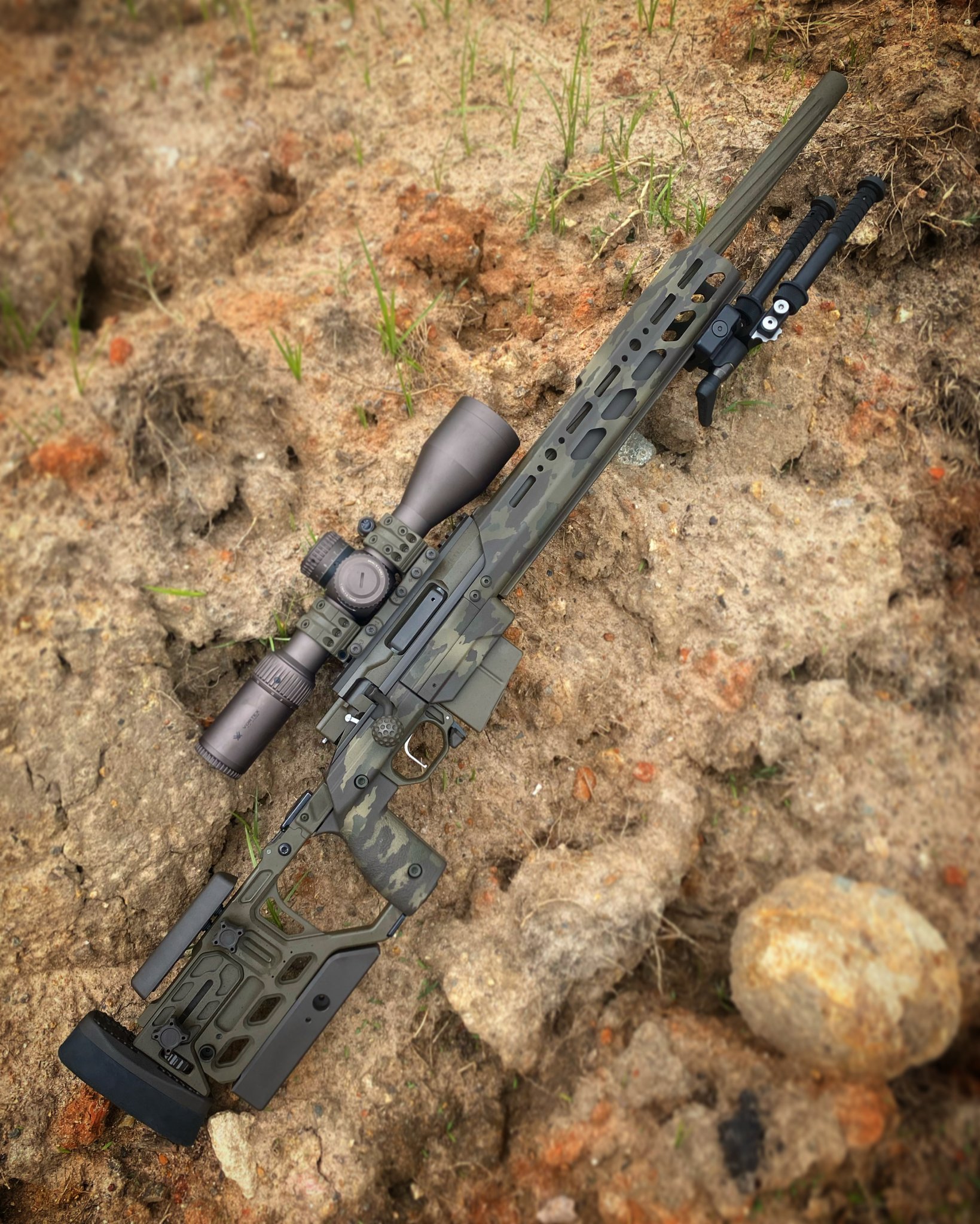

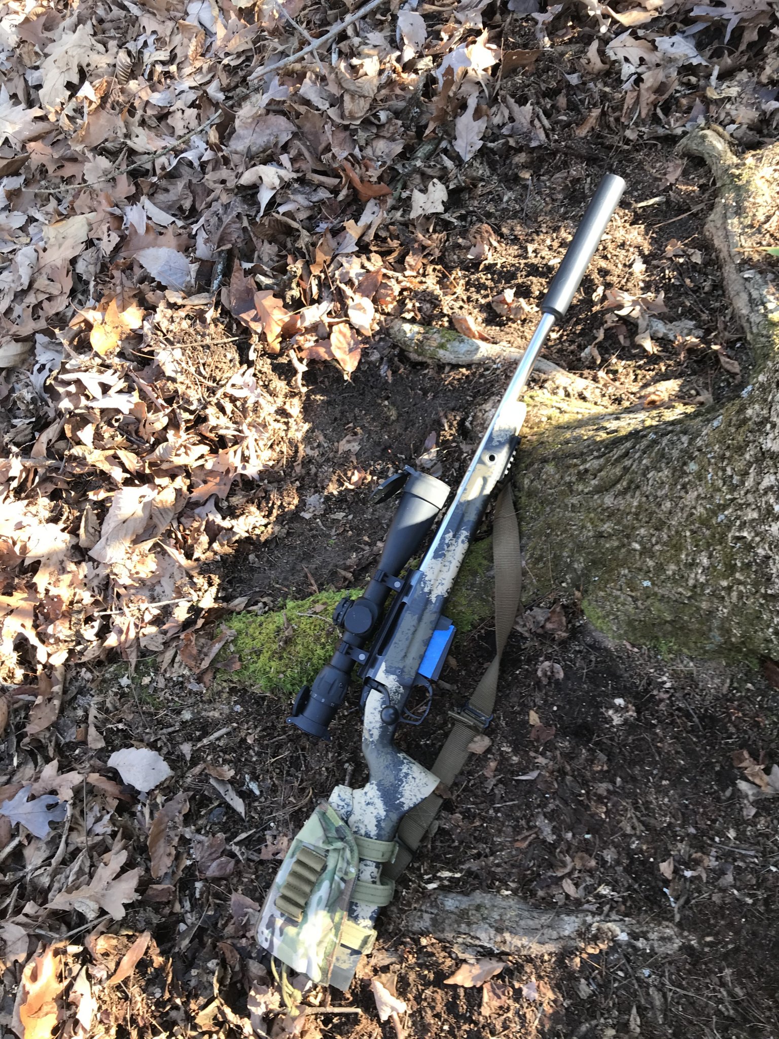

I went with the 7 SAW Type 2 reamer for the 162 eld-m. Bartlein #3 contour 9tw. 22in finished length. 2850 FPS with Varget which is pretty good considering my buddies 26in 6.5-7 PRC does 3050 with the 162s.
Killed 2 bucks in my first season with it with the 162. Both time DRT.
This year I want to try the Barnes LRX 145 since it’ll be mostly short range hunting and at that distance the 162 will blow up/fragment and make a bit of a mess.
Reactions: 806guns
Might need to build a Remage in SAW II

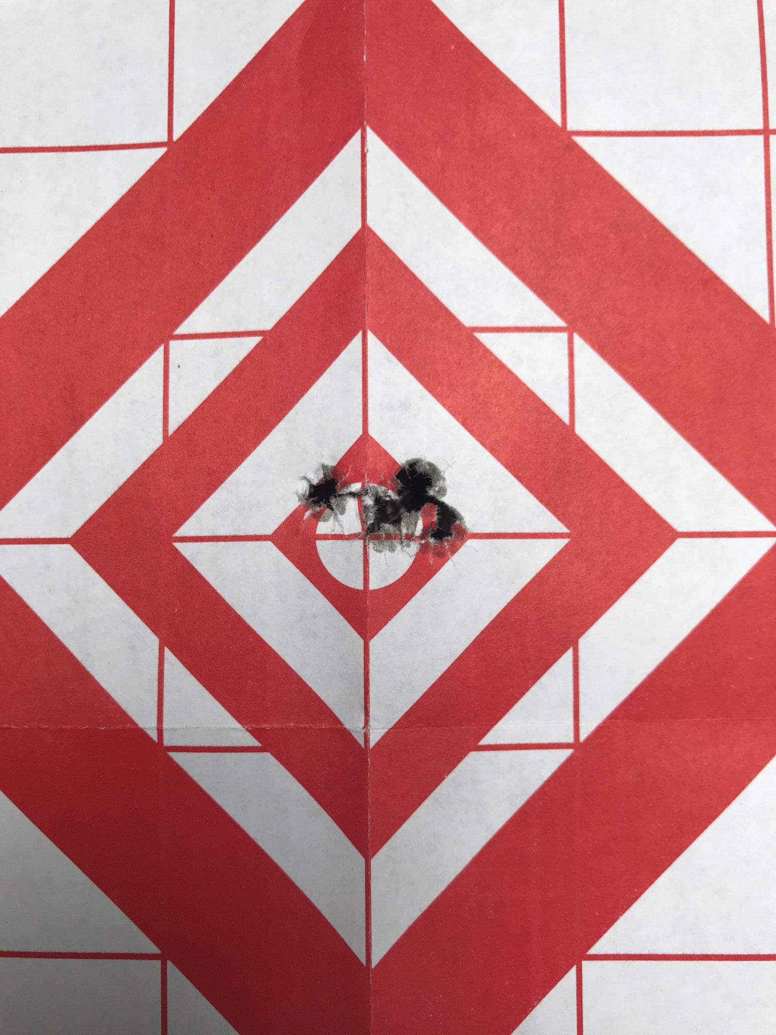

It’s very very accurate and easy to tune. Alpha brass has been excellent so far.
I’ve shot better than 3/8 Moa during load dev. I also shot a 3 round 3/4 moa ground at 1000 y
Recoil is very light. Currently sits in a 9lbs build on a Manners LRH. Optics this fall will be my old trusted LRTSi 3-12 since I’m not planning to hunt fairly long with this rifle. The 162s have been excellent and they’re 1/2 of the price of the 166 a-tips, and have a better BC for a lighter weight.

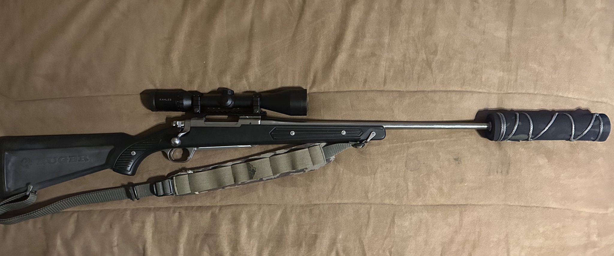

That’s a sweet rig! I’m thinking about cutting mine down to 18” so it’s not so long with a suppressor. I’m just not sure where to start with hand loads

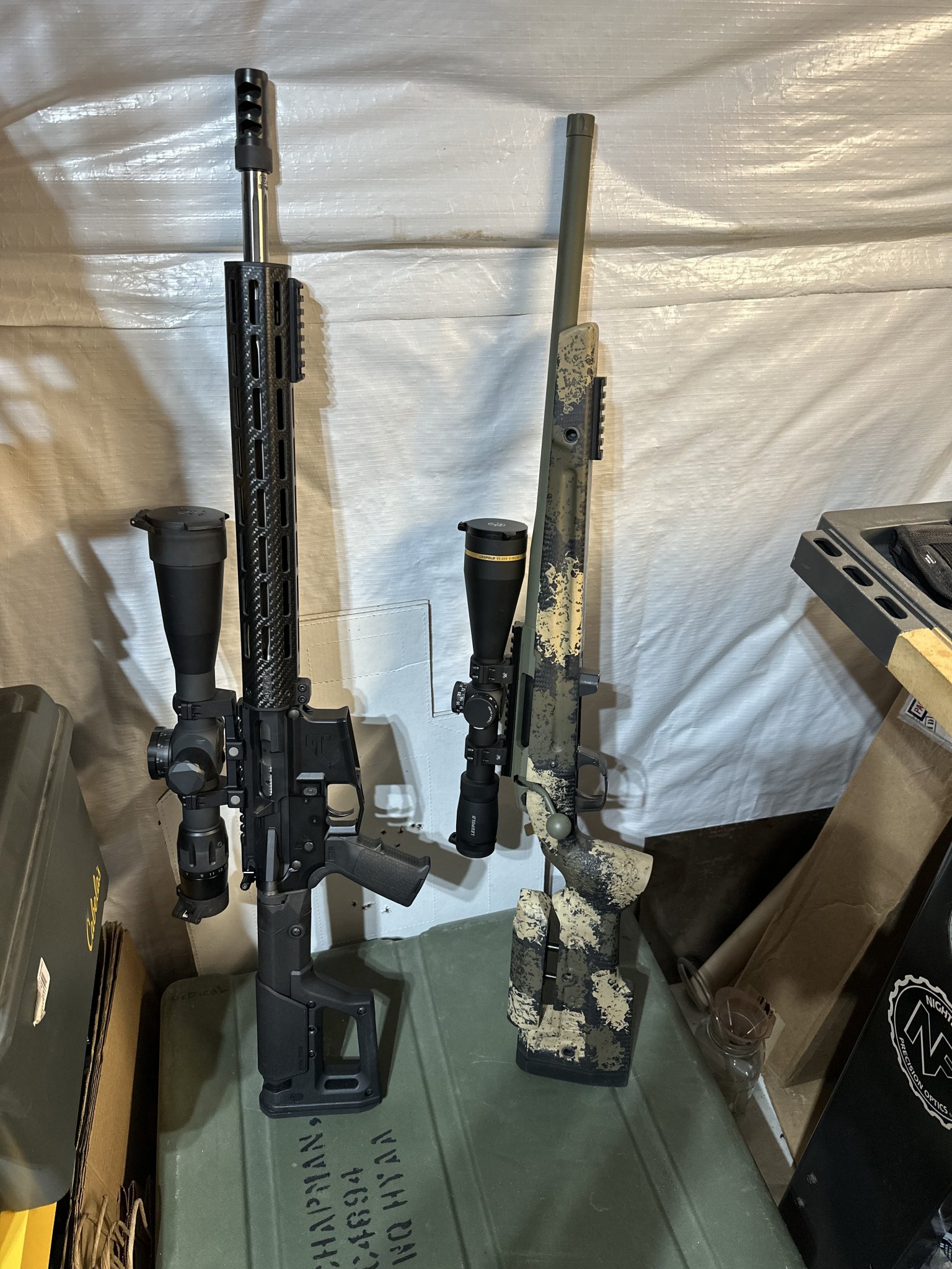

If you want hard-hitting, the Berger 175 Elites are stomping out of my 20" Ridgeline FFT 7mm-08 with StaBall 6.5 powder in Nosler brass with CCI 200 primers. I checked with my new Garmin XERO C1 chrono this past weekend, and they were leaving the muzzle at an average of 2,636 FPS (which is about 20 FPS faster than my Bulletseeker chrono was reading). Sadly, I feel more confident in the $600 Garmin's accruacy than I do the $1,100 Bulletseeker radar, just because of how finicky the BSm4 is, and the Garmin never missed a single shot and was extremely consistent from shot-to-shot.

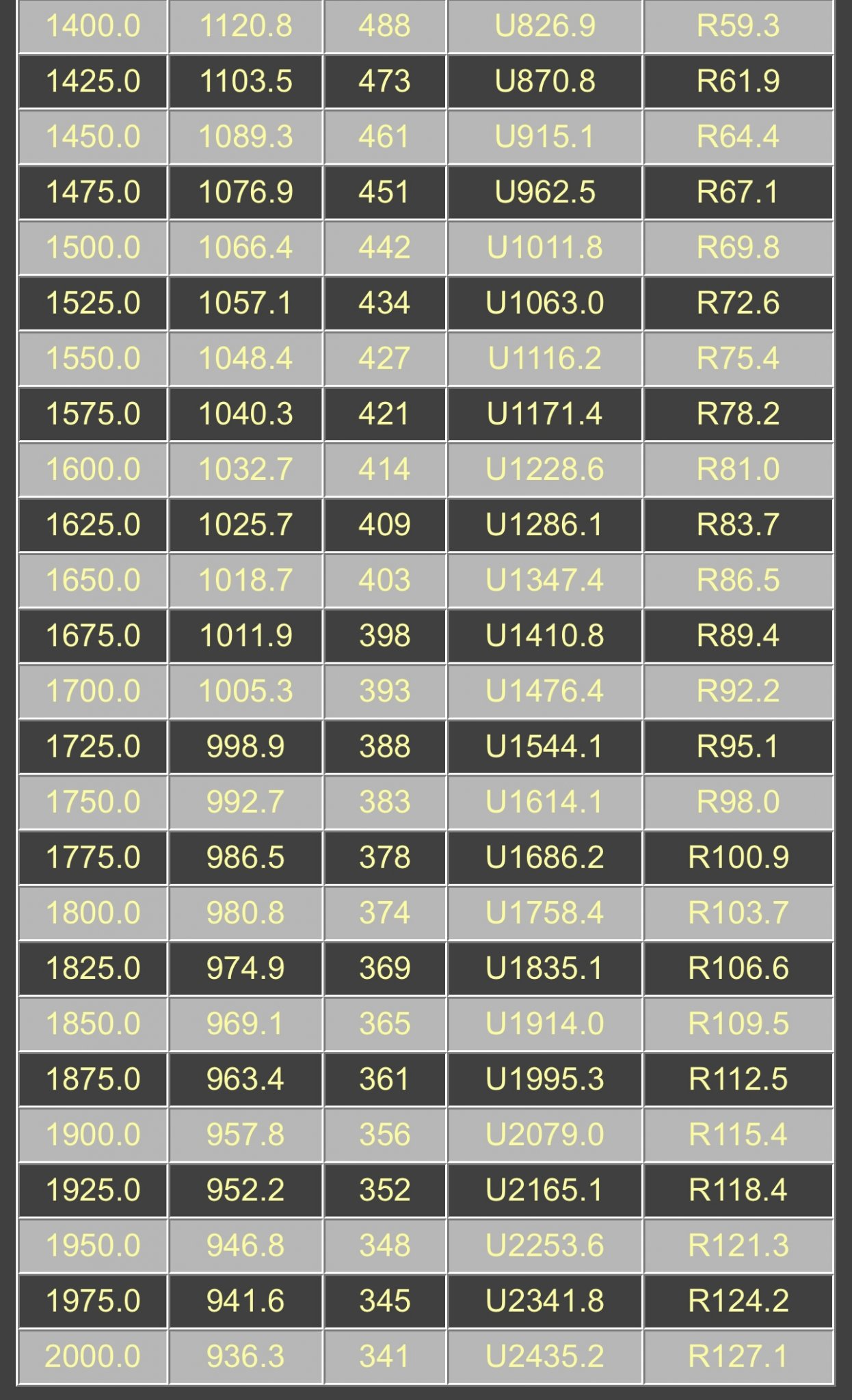

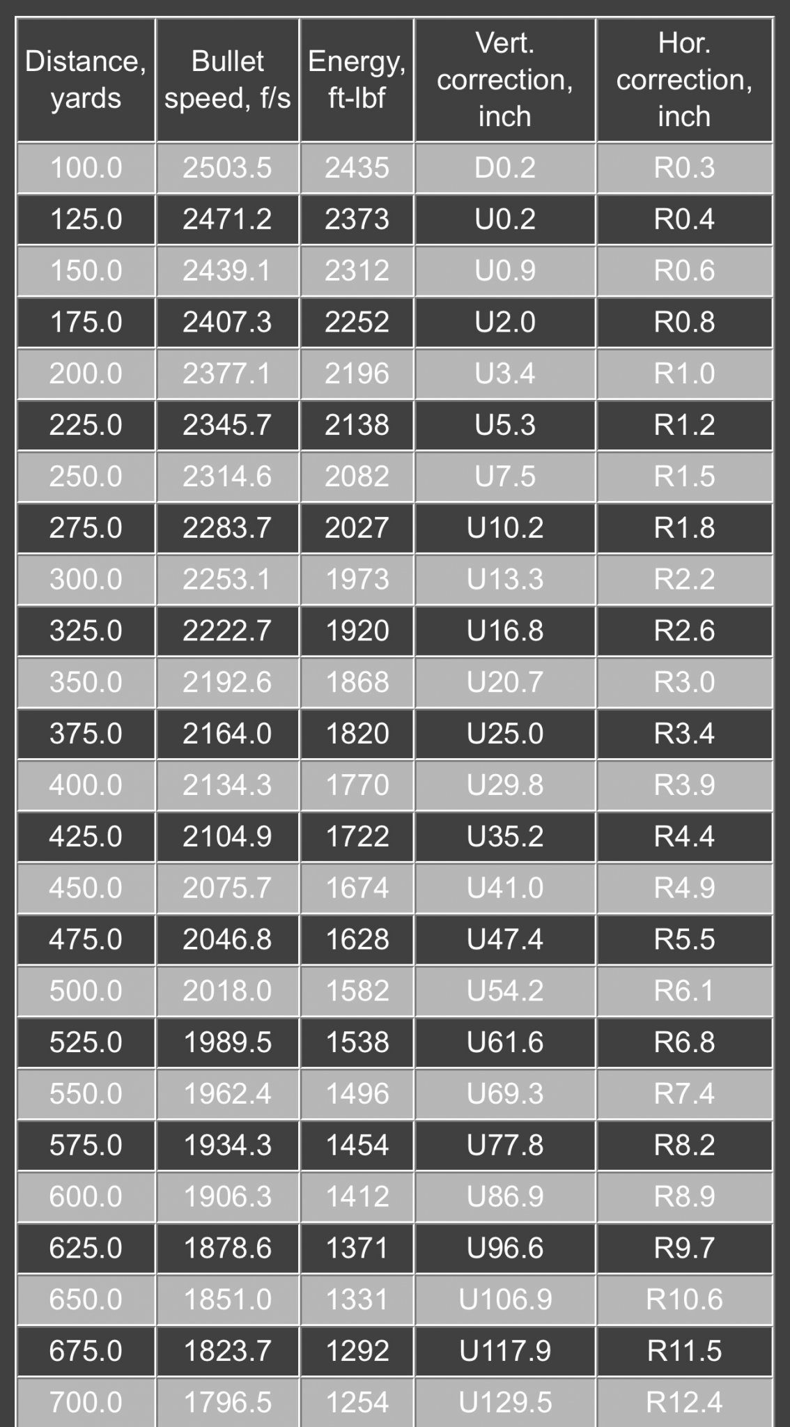

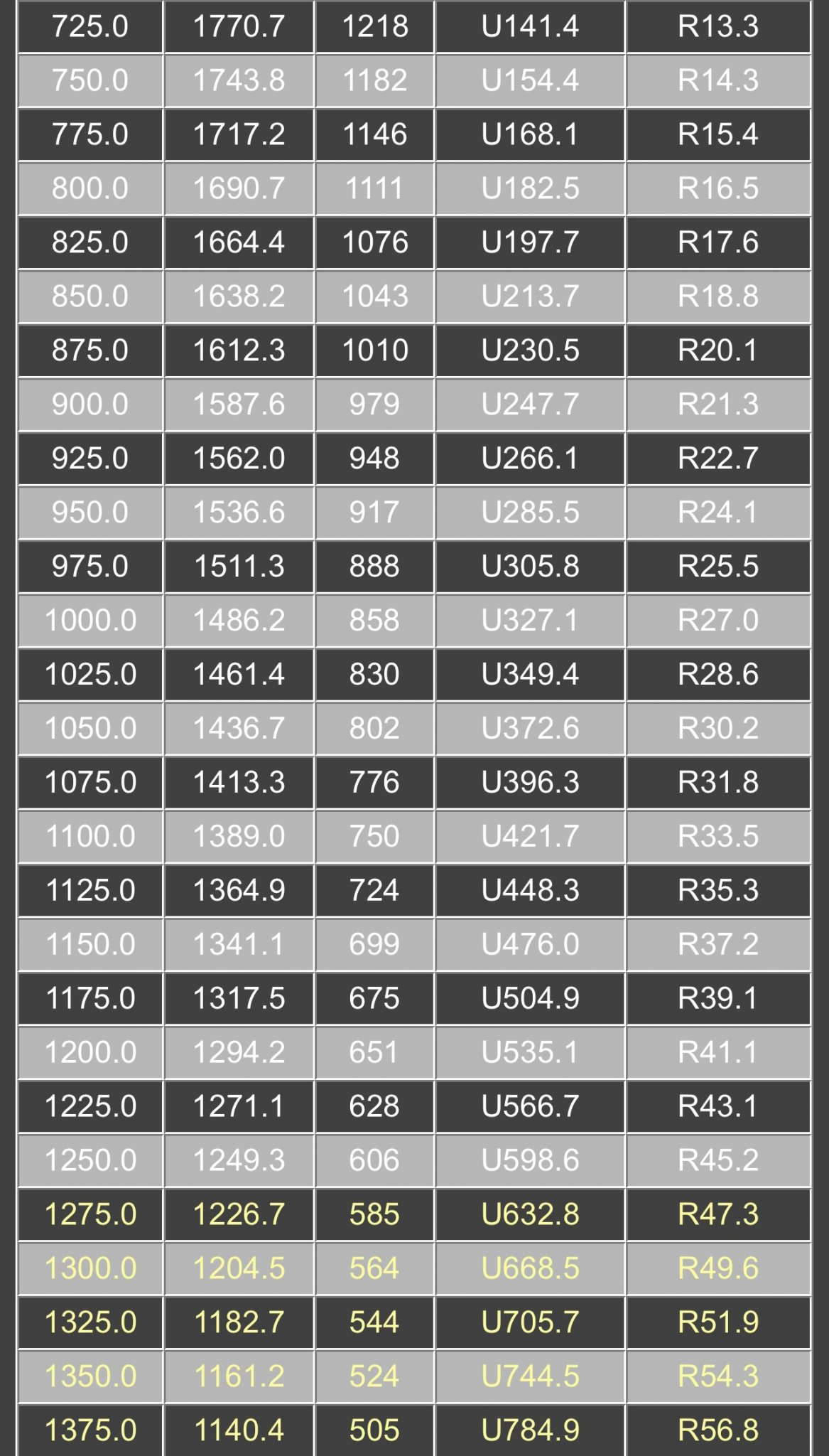

Here’s the ballistics on my rig…
If you ever re-barrel, it would be worth it to run a 1:8 twist to take advantage of the 180 eldms. With Staball 6.5, I’m running them a touch over 2600 out of a 22” barrel. Where I hunt, I keep 1500 ftlbs to around 750 yards, and an optimal impact velocity from basically muzzle to 900 yards.

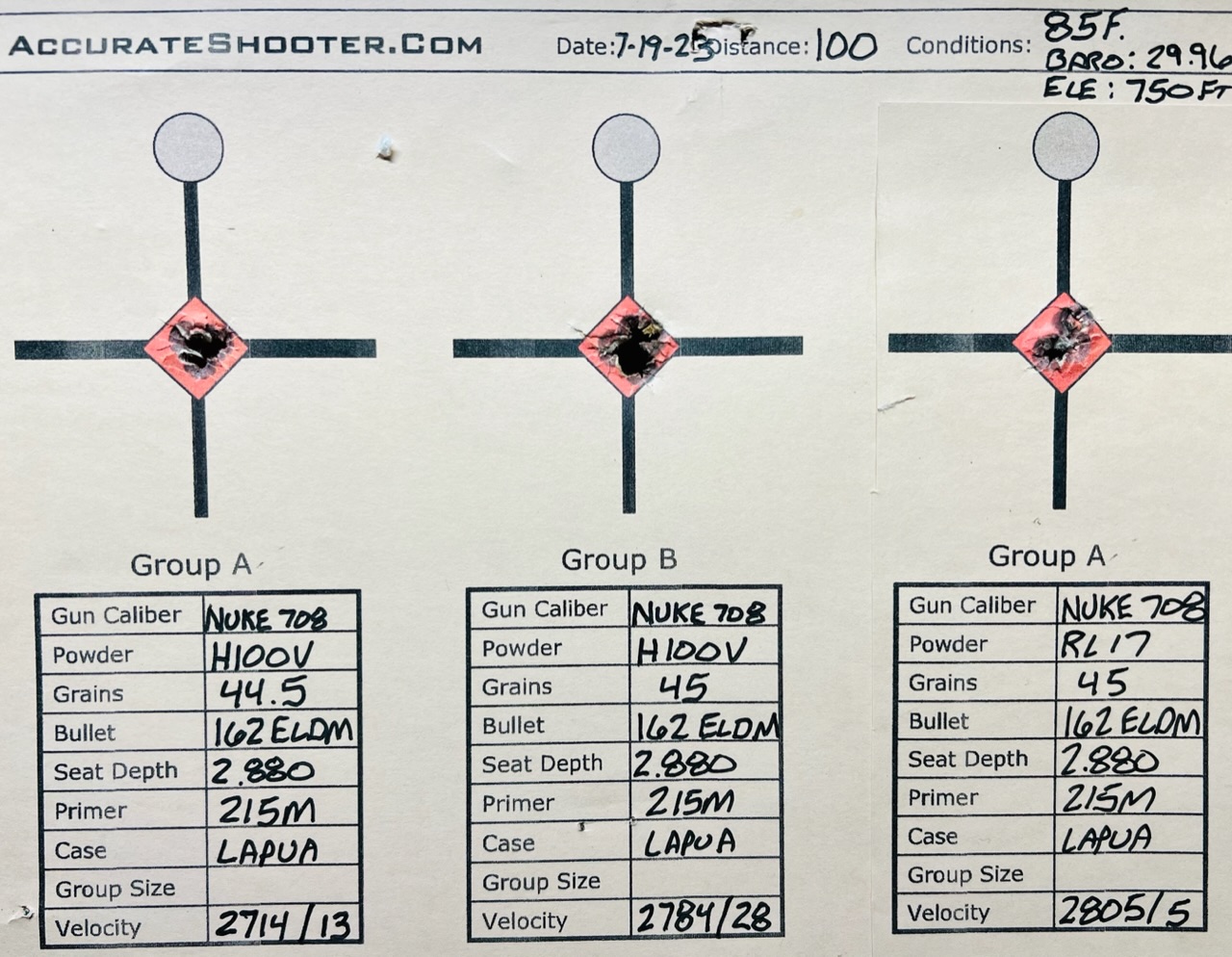

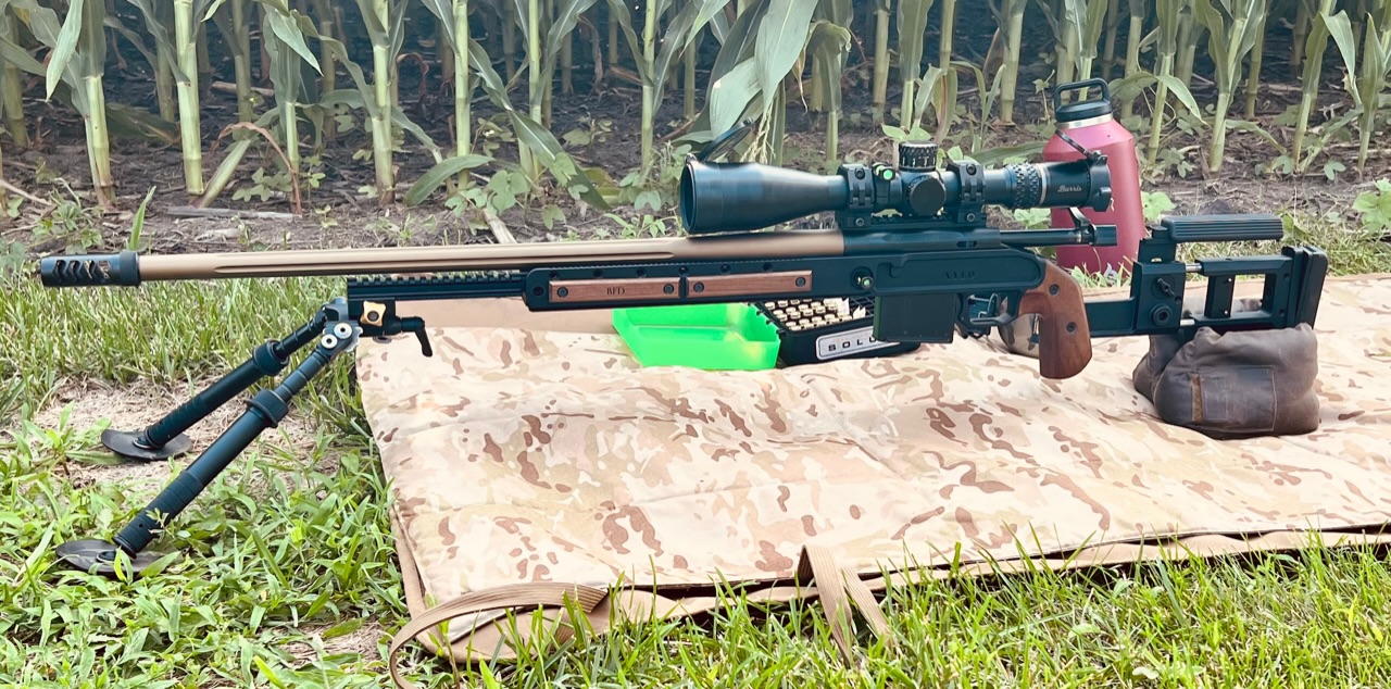

708-708AI chambered by PVA, self built
Benchmark 26" Sendero cut rifled 1/9T:
162gr ELDM 2.880" COAL
Lapua Brass
215M primer
708 version:
Reactions: spife7980
What‘s your velocity at 900 yards?
Looks like the load drops below 1800 fps at 800 yards.
But that’s at sea level.
P
P
It depends on where I’m shooting, in Phoenix the DA often 2-4k, so I hit 1800fps around 850ish. But I generally hunt at elevations anywhere from 5-9k real altitude, so in those instances I hit 1800 fps anywhere from 900-1000 yards depending on the weather

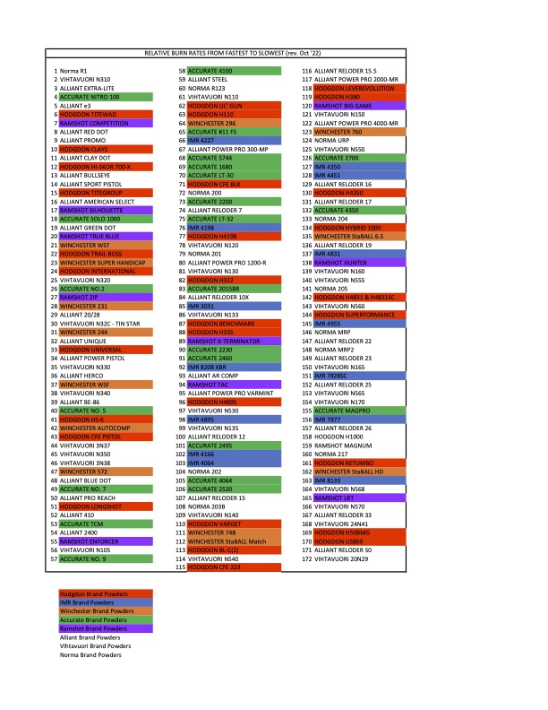

It's WAY slower than both Varget, and slower than H4350. It actually ranks right above Reloder 19 on the burn rate chart.
#110 - Varget
#130 - Hodgdon H4350
#135 - StaBall 6.5
#136 - Alliant Reloder 19
