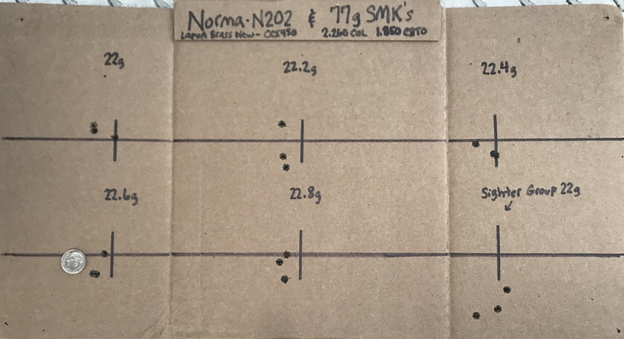

Has anyone tried Norma 202 with 69gSMKs? I tried 202 with 77gSMKs awhile back, and it was really promising. I have some 69gSMKs on order, & was curious if anyone has had any success with them over Norma 202 before I begin my testing.
The 77gSMKs I tested didn’t have blazing MVs, but the accuracy was good & the SDs were all below 10.
I will be running the 69gSMKs thru an AR15 with a 16” 1:8 twist. Using Lapua Brass, annealed each firing, .002” shoulder bump when resized, & using CCI450 primers, & intend to load them to Mag length.
My test with 77gSMKs were as follows:
