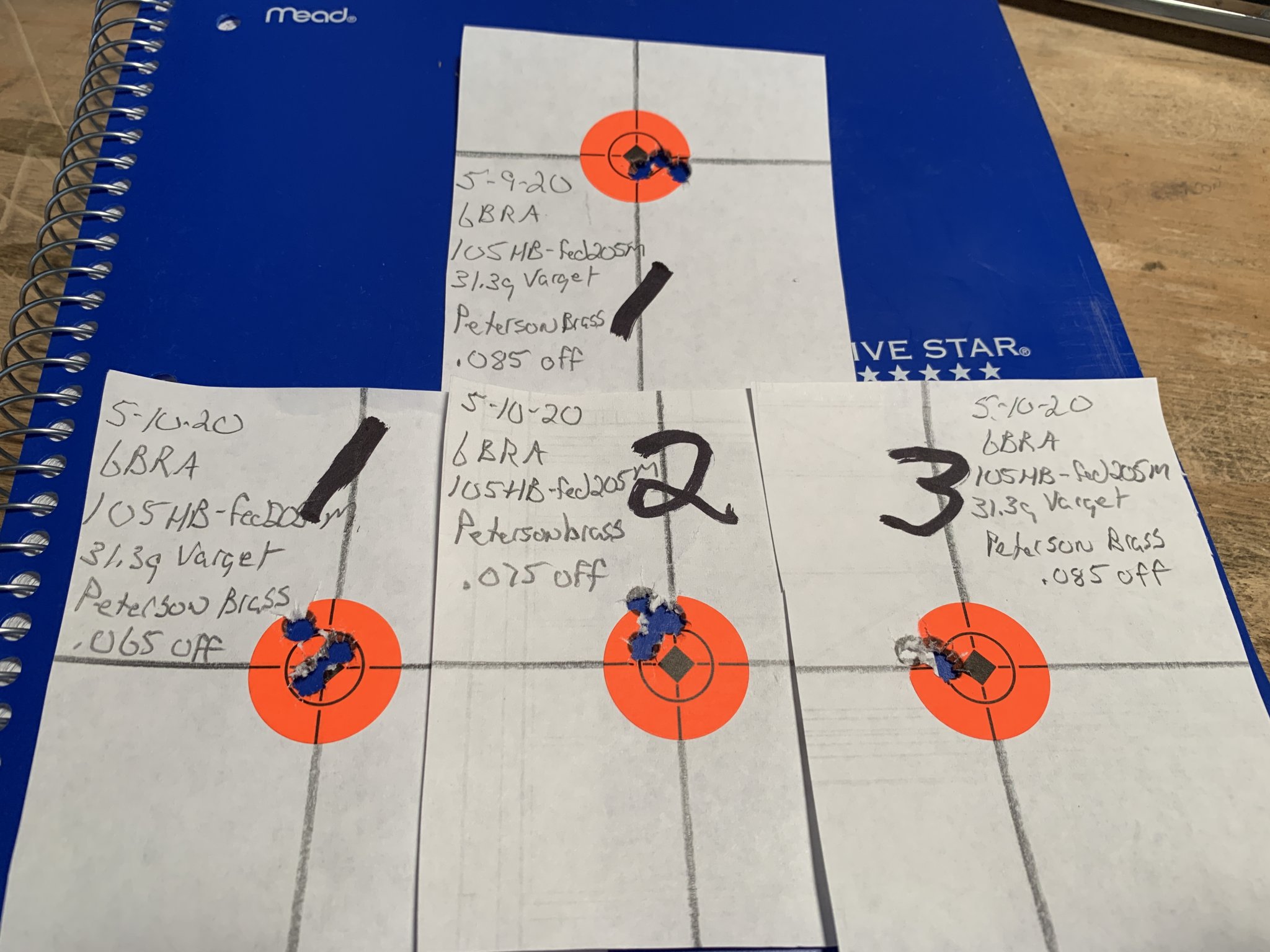

    I’ve been shooting 31.3.g varget 105 hybrid Peterson brass 205m primer for 1520 rounds was running 2975...I have not check velocity in awhile but my dopes have not changed...started at .005 off the lands now .017.
    might try .005 off or real far off like .050 to .080 both shot great in mine...I had my smith add .080 freebore in the next barrel because.085 off shot so well.
    this is 3 at 850yds with the same load I’ve shot for 1450 rounds
    this was testing long jumps...
    this was the .085 off load at 600yds 3 rounds

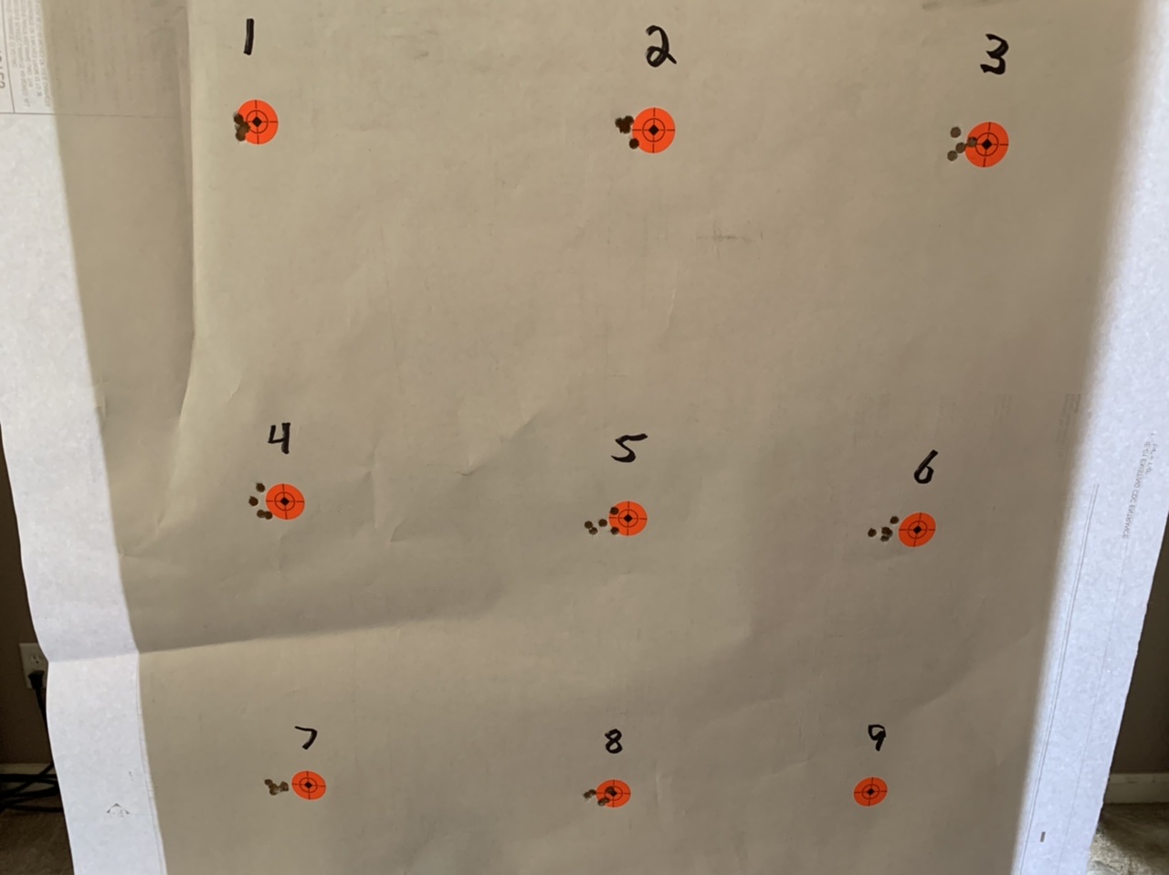

    31.1g varget..CCI450..105 hybrids at...
    .005 Shot good
    .015 Opened up
    .025 Worse
    Then jump to(we bring a hand press and seating die out once we find the charge weight and seat as we shoot)....
    .050 shot good
    .060 shot real good
    .070 shot better than .060
    .075 . This was .270 edge to edge...ida bet money these were not going to shoot well so I went and actually read the article instead of skimming over and it made sense so I tried it...I had my smith add .075 freebore to my next barrel so we’ll see how it works out.

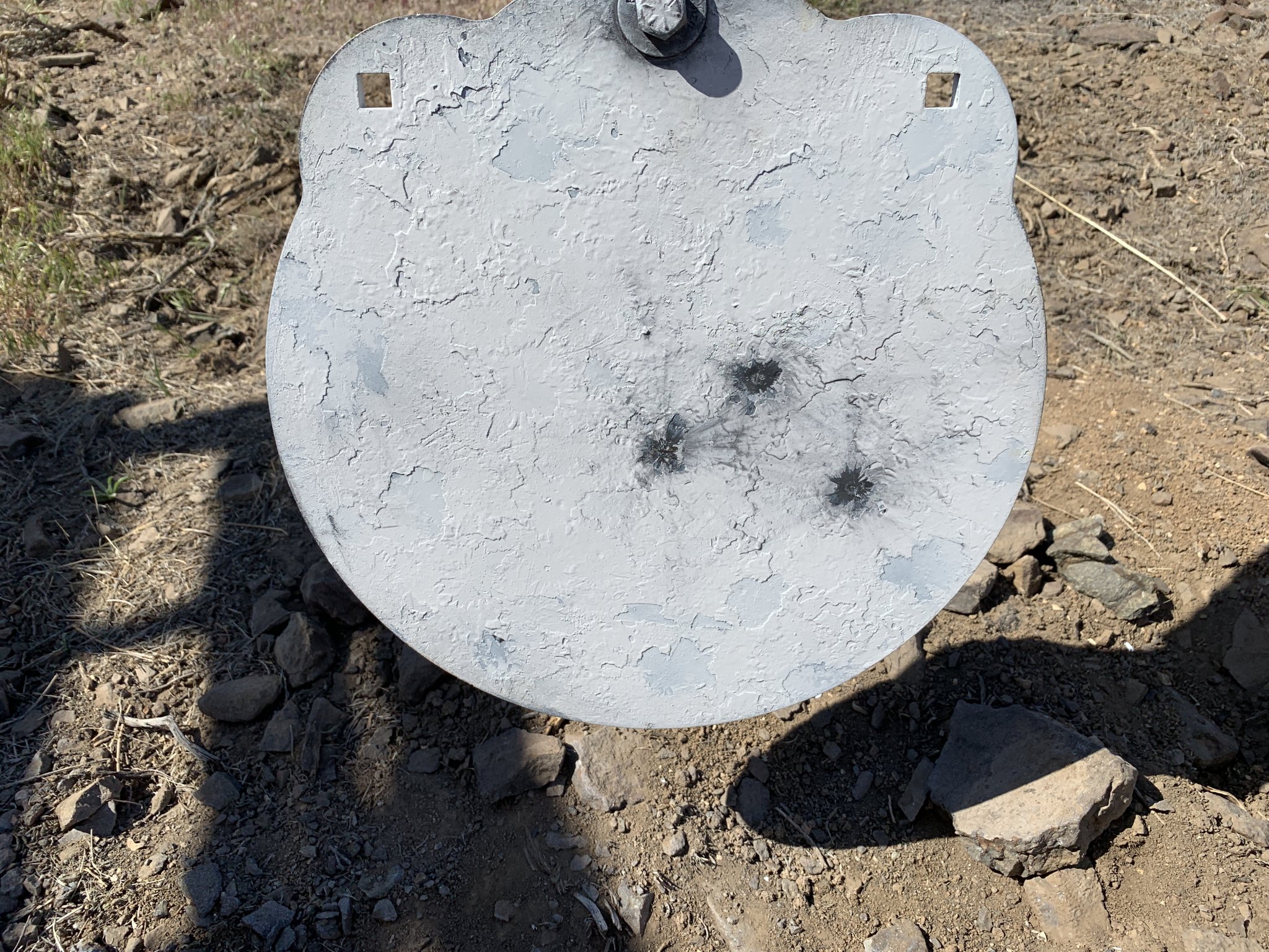

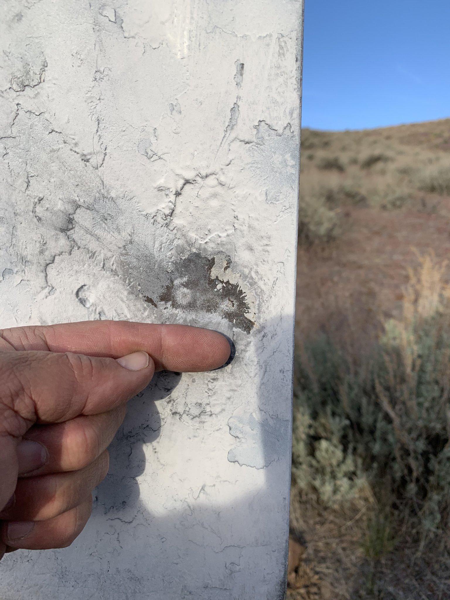

    Today I ran 15 rounds at 31.8 gr of Varget/109s. They did not group well and SDs were bad.
    I'm going to try dropping the charge weight to 31.0 to play with the other possible node, but as good as the 105s shoot, I'm wondering if it's worth screwing with.
    if the 105s are shooting good maybe just save the 109s for the next barrel and start fresh with them.
