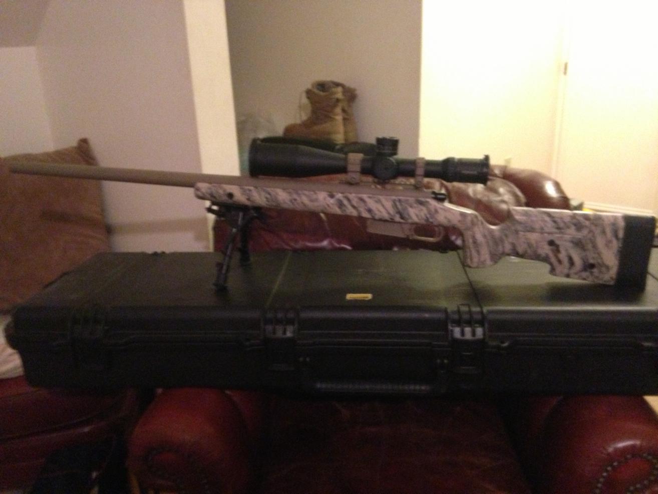

Approximately one year ago I started a .22-250 build. I kicked around the idea of a 7" twist for the 90 VLD's but then settled on an 8" twist and chambered for the 80 gr AMAX. Here are the specs:
-Blueprinted Rem 700 SA
-PT&G spiral fluted bolt with Badger knob
-Custom recoil lug by DPR (Rifle smith'd by Dixie Precision Rifles)
-Brux MTU 1-8" twist cut at 26"
-DPR Muzzle Break (no side ports)
-McMillan A5 Adj. FDE, Brown, Black Marble Swirl
-Surgeon Bottom Metal DBM
-Jewel HVR trigger
-all metal Cerakoted in FDE
-Badger USMC rings
-Premier 5-25x56 GenIIXR
I could not be happier with this rifle. Just wish I could find some damn 80 gr AMAX's. Current load is Nosler brass, 34.2 gr IMR 4350, 80 gr AMAX, Fed 210 primer. Less than 8 Mils to 1k. Accuracy is unbelievable. It shoots the 80 gr VLD as well as it does the AMAX.
