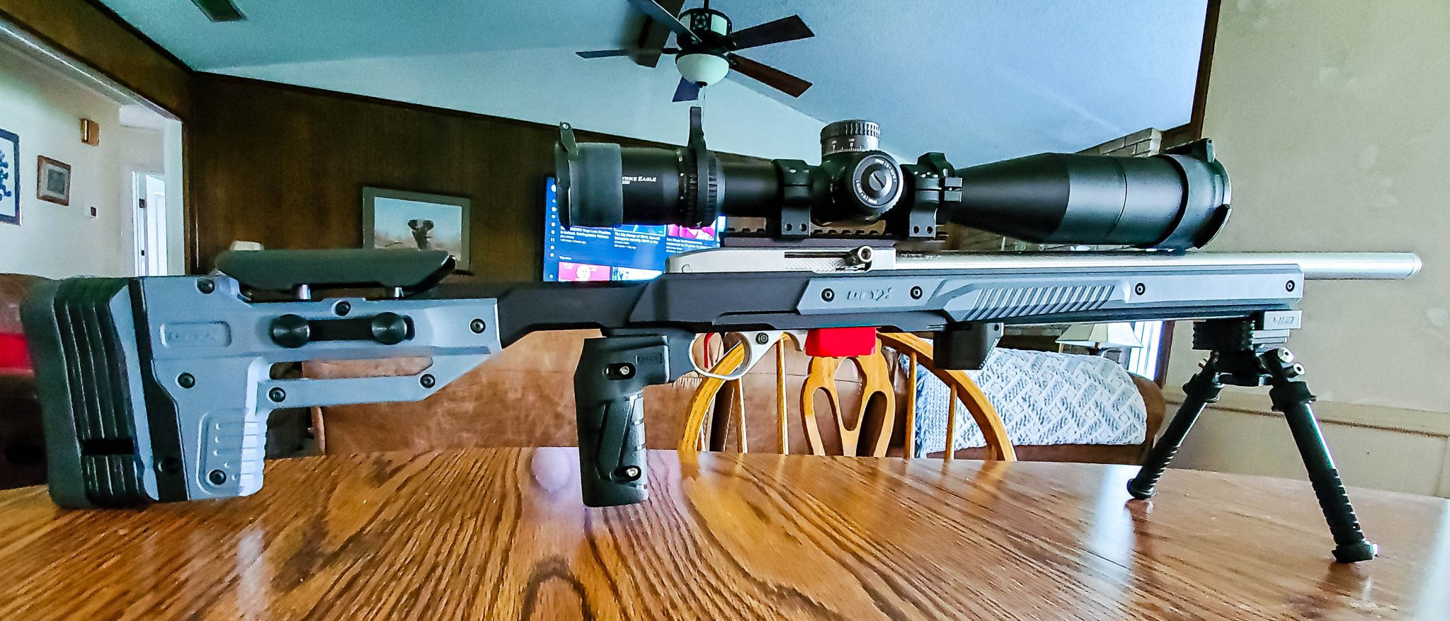

Thanks for reply Lonestar. What color are the plastic parts on yours? Did you paint it? I did purchase one and received it last week. I'm in the adjust and modify stage currently. When I get it all done I'll post some pics.
LS, thanks again for reply. I only asked about color due to panels looking bluish to me in your pic.

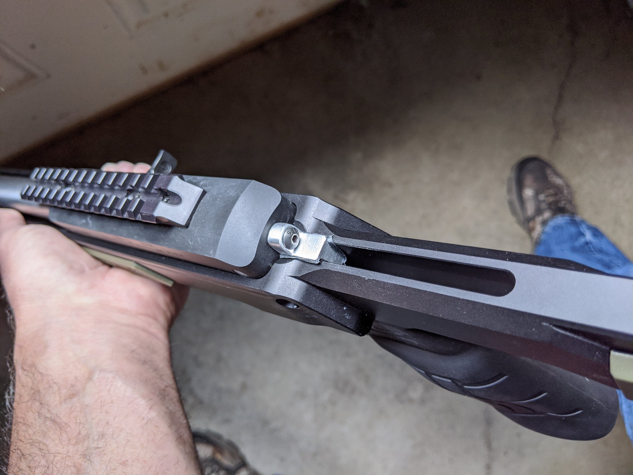

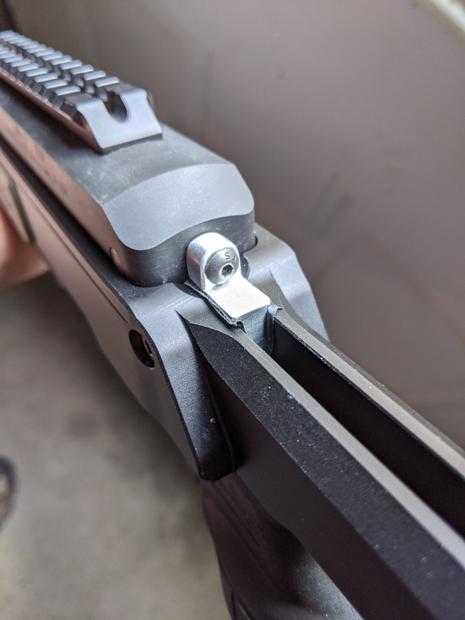

Have had my ORYX 10/22 chassis for about 2 weeks now. Did a couple of mods to satisfy myself including an mlok mount for a bipod.
One issue I did have was with the crossbolt torqued as specified, my action was moving. The rear of the action was rising up out of the chassis due to barrel weight, tipping forward. Tightened down to "gudentite" it still "appeared" to move some after extended shooting. So I fabricated a rear anchor incorporating the action cleaning rod hole and the the chassis crossbolt. It is solid now, and to my satisfaction that it will never move.
I also didn't like the add on bag riders available for one reason or another, so I fabricated my own version. Totally satisfied with my creation. Has all the benefits a bag rider requires without the loss of swivel pockets, with minimal added weight ( less than 2 oz.), and no changes to the chassis proper. Looks pretty decent too!
Pics included of rear anchor and bag rider.
Shooting this setup my accuracy has improved and and I am totally pleased with this product.

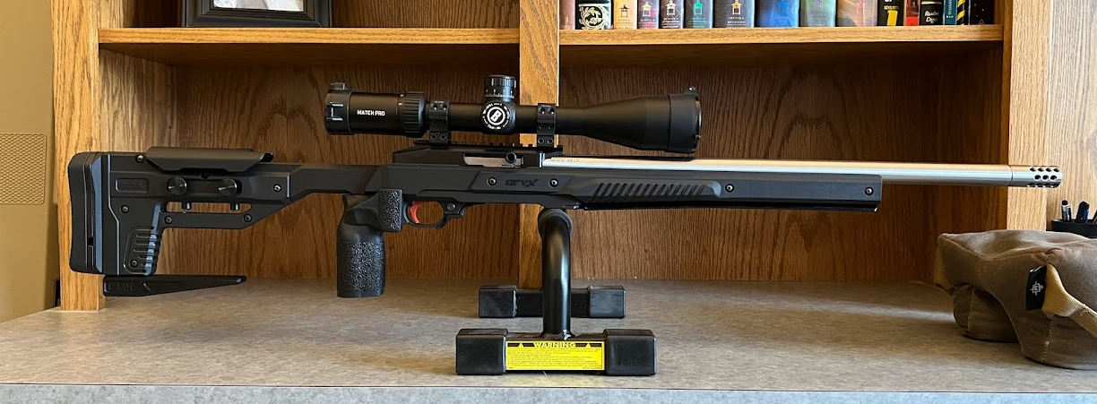

True, if you have a Kidd 18" .92 SS bull barrel you'll get the weight to balance it. With a standard Ruger / factory 10/22 option, it's definitely too light. As you can see in the picture, the balance point is right in front of the trigger. The KRG's have an aluminum backbone, and then a poly cover around it. The big downside is the grip isn't adjustable, so you can't replace it with say the MDT vert grip.

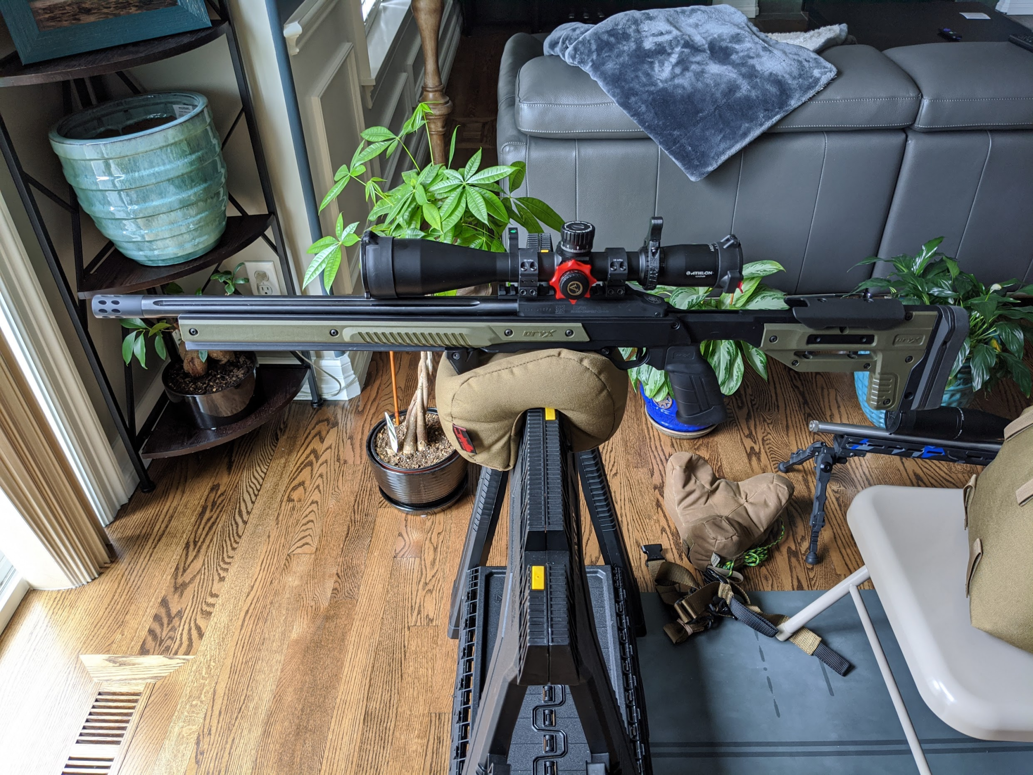

My preferred balance point would be about 2-3 inches further forward and there is just no practical way to get it to balance there. I did some weight testing and it would need an additional 2 lbs at the front of the forend to achieve that. If you don't might setting the mag well over a bag then it would be fine. However, in that case you are using the trigger guard as your stop, you are very close to the barricade/obsticle, and mag changes are much more challenging.

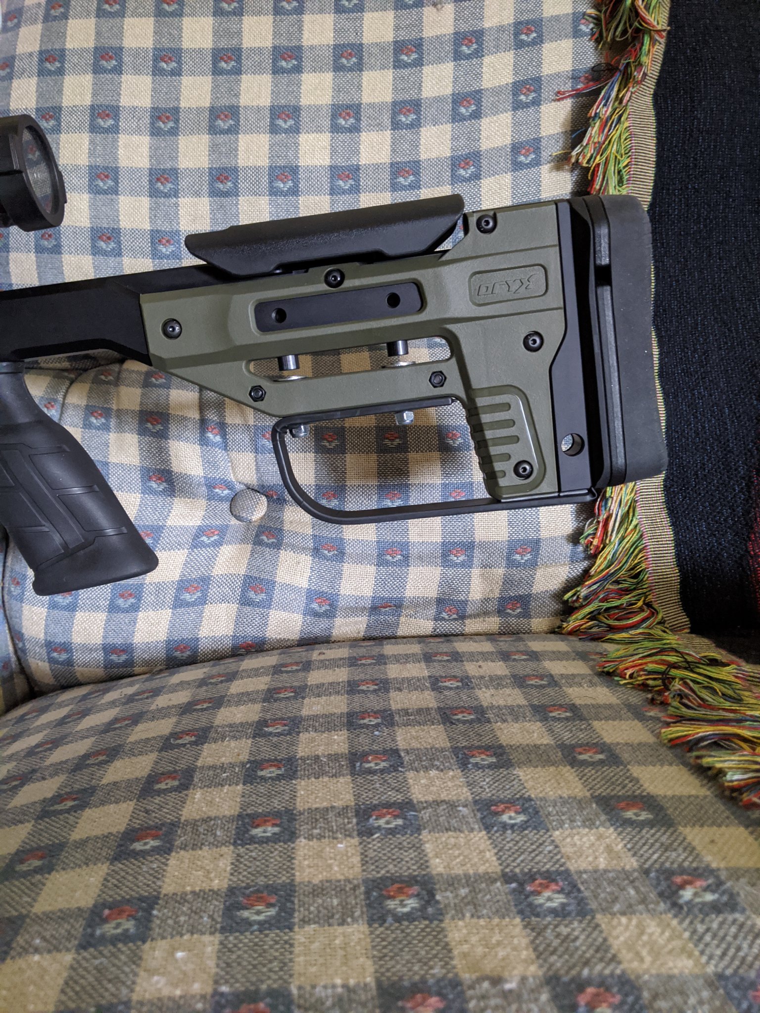

Balance point of my 10/22 with the Oryx:
For anyone wondering, the bag rider weighs ~4.9oz and the Muzzle Brake is ~3.7oz so they pretty much cancel out. This is with a Kidd 20" .920 Bull Barrel.

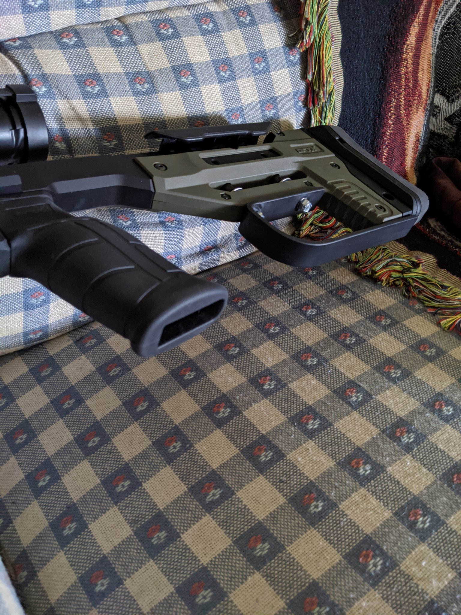

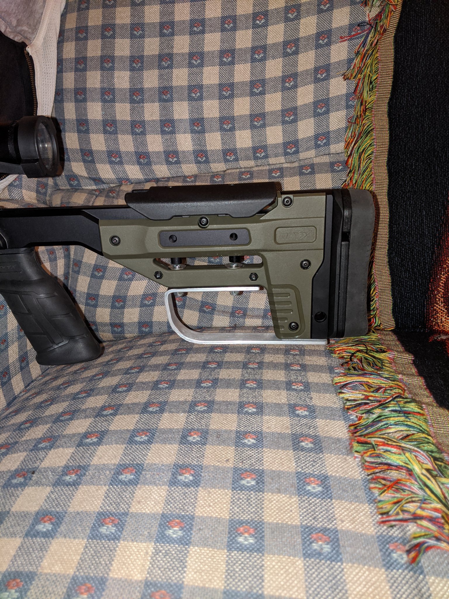

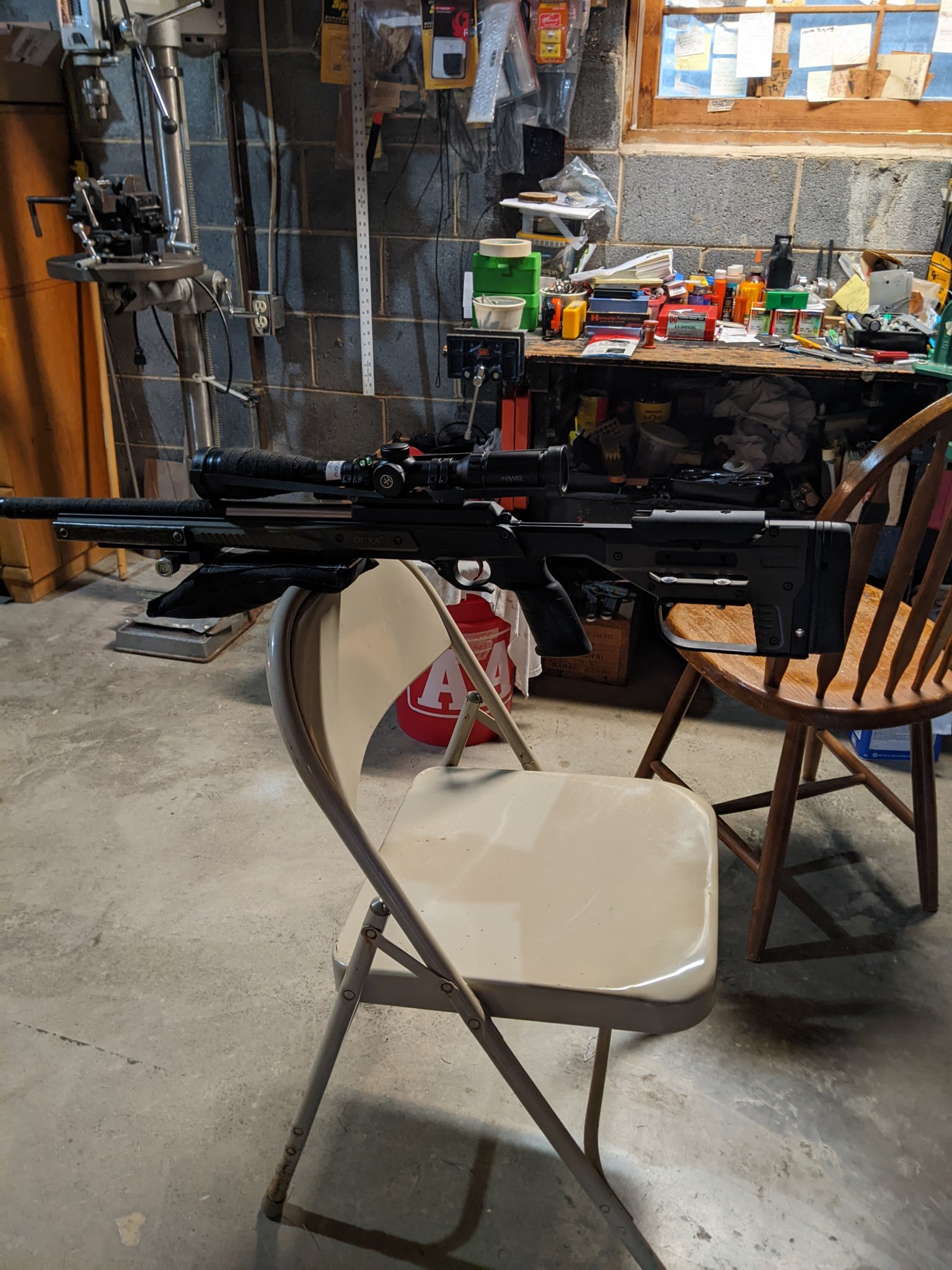

If you really want to balance that thing out, do what I did. I made a mold to fit the cut outs in the forenend of the chassis. There are 2 different machined "channels". I then cast lead into the molds and installed in the fore end channels. Rifle weighs 15 1/2 lbs, balances perfectly on a tripod with bag. For even more forward weight I also cast 2 short pieces using the smaller mold for the fore end and attached one to each side using the screw holes for the side panels. The 2 weights in the fore end weigh 2 lbs, the extra side weights ar 10 oz if I remember correctly. I held the channel weights in place using the front swivel stud hole, and one bolt through the rear mlok slot.I also made a bag rider out of 3/4" x 1/8" aluminum flat stock. It weighs less than 2 oz. Picture shows the bag rider before covering with black heat shrink, and after. And the balance point on a chair.

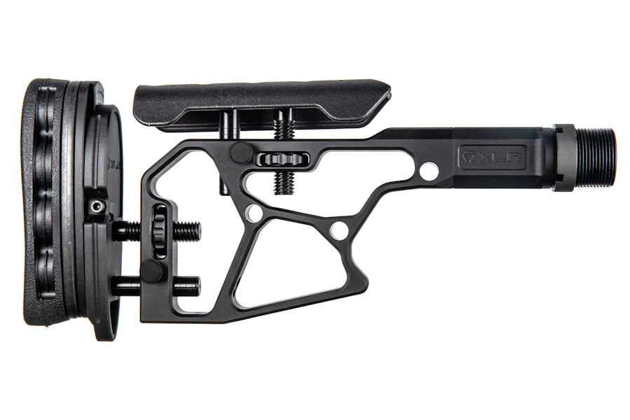

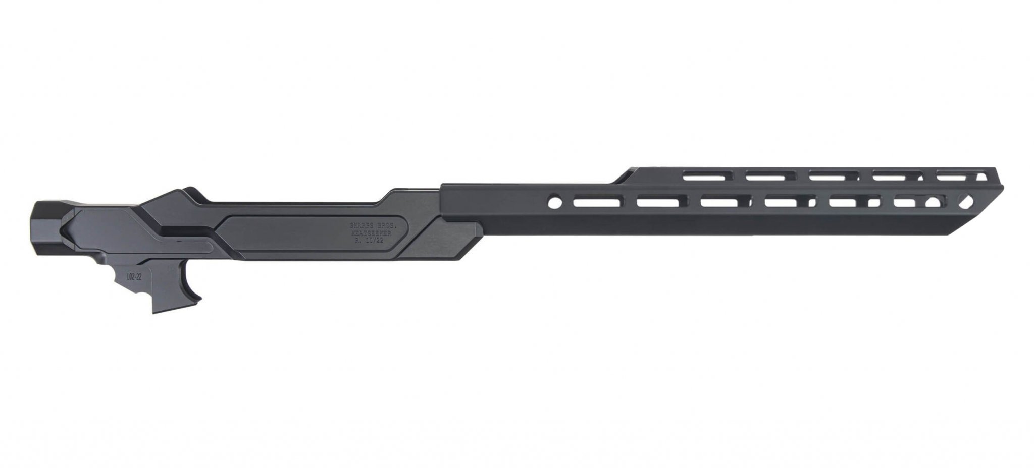

I've put the Sharps Bros Heatseeker chassis on my list to try next though. Normally it comes with a 9 inch handguard, but I spoke to them and they said they'd swap in the 14 inch for me at no charge. Checks all the boxes for things I'm looking for in a chassis and should be easier to balance out with simple M-Lok weights. I'm just waiting on the XLR C-6 Buttstocks to come back into stock as that's what I'd like to use with it.
Should look something like this with the 14 inch handguard.
XLR C-6 Buttstock
