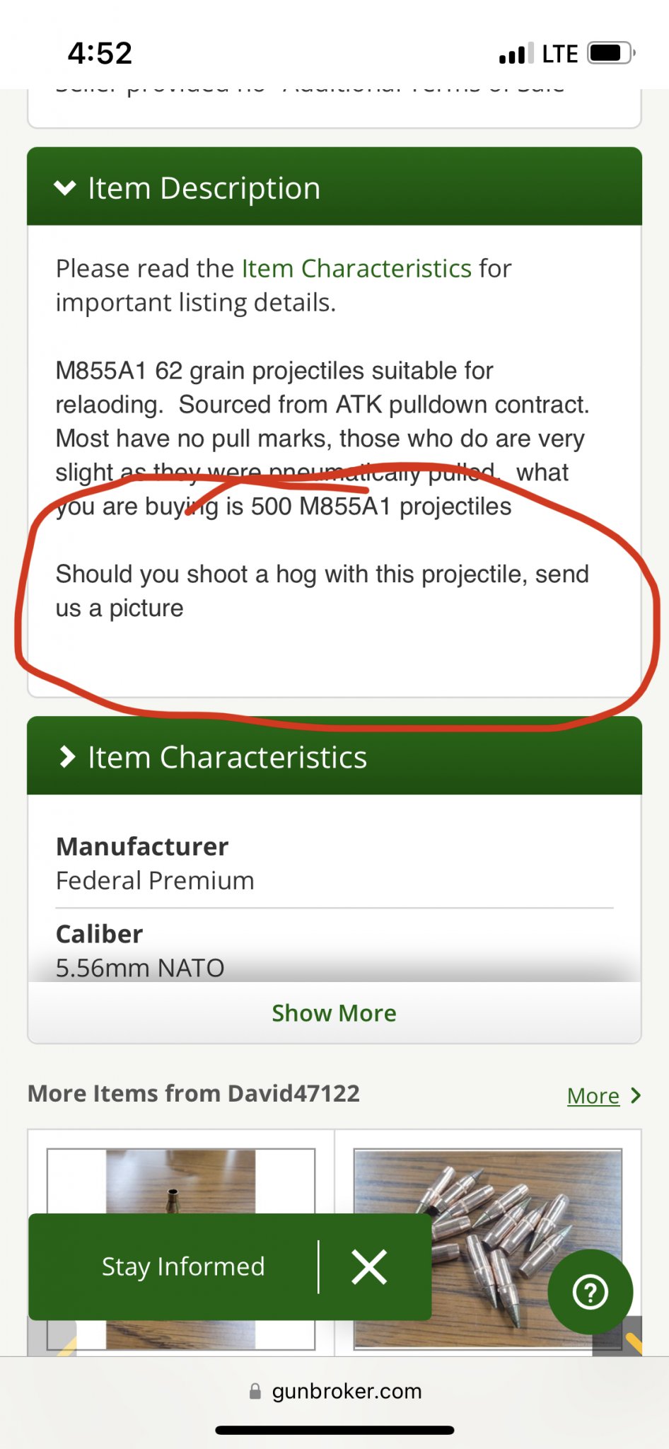

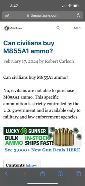

    Probably not many using it on hogs. I haven’t seen any available for purchase. Why?
