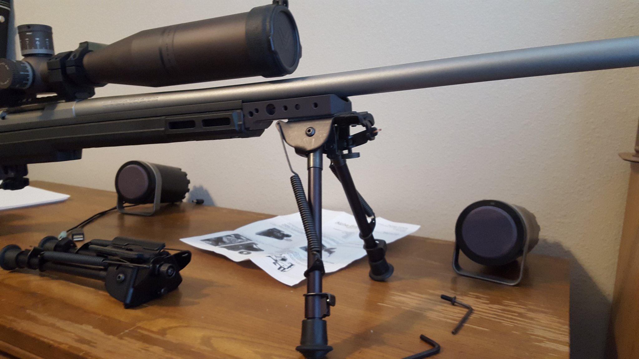

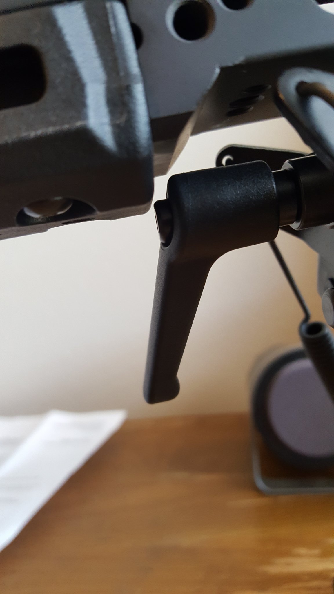

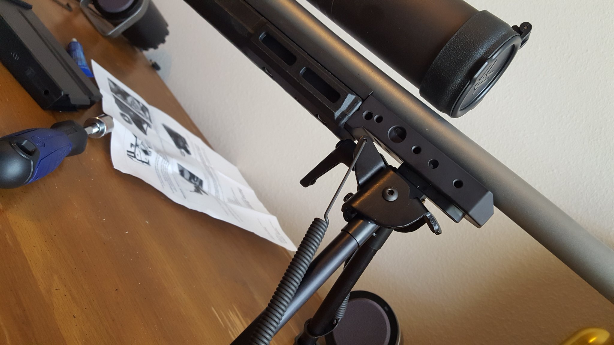

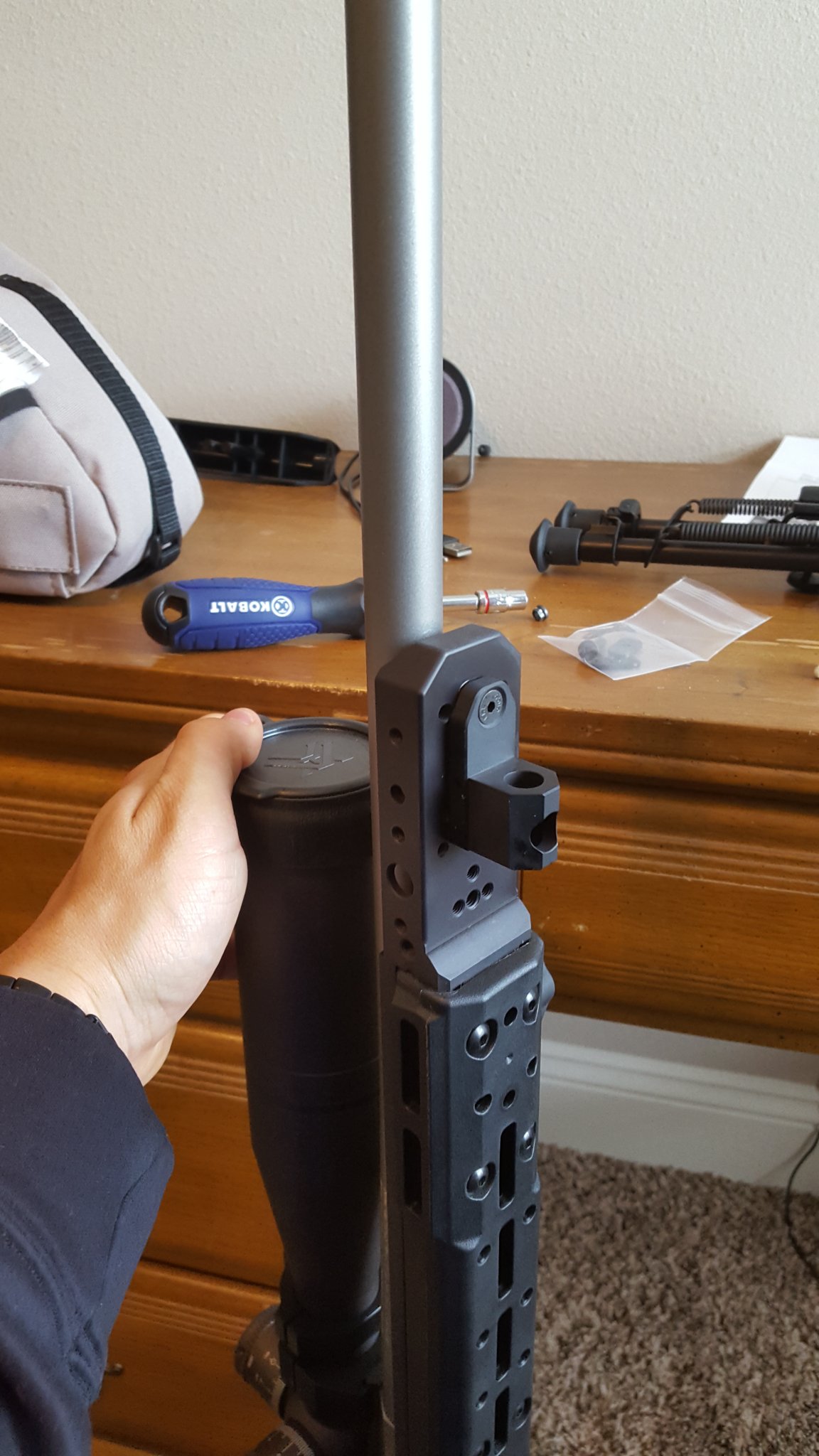

Mount arrived today from KRG so I got it installed along with the Pod-loc. Only hitch was that the forend skin on my chassis was just low enough to prevent the bipod from sliding into the mount so I had to remove the forend to get it installed. I also took the opportunity to dremel down the forend skin where it attaches to the rear stock in order to tighten up magazine fit. You can see that there is just enough clearance between the pod-loc and the forend for it to work. I thought I may have to mount the adapter the other way around but the swivel carriage would not fit with the second screw mount overhanging it. Before, during, and after pics:

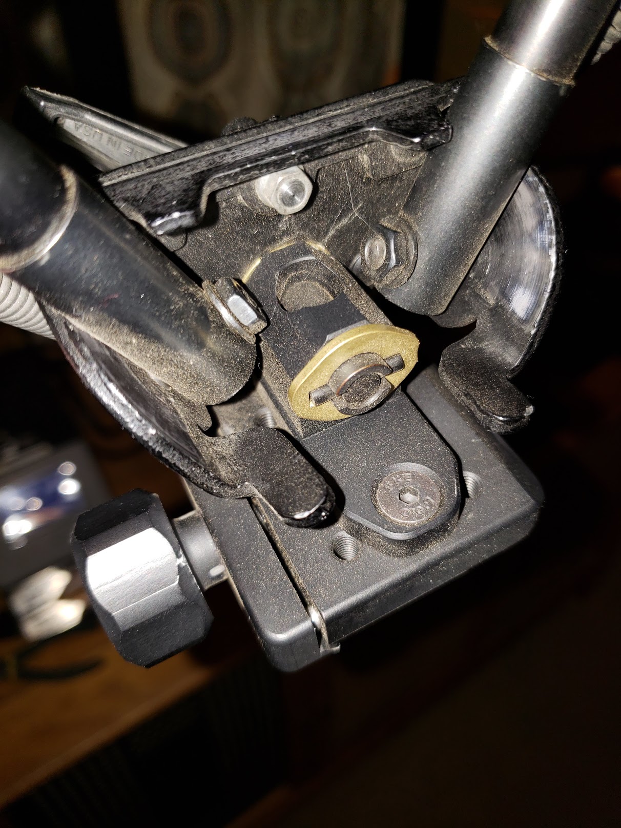

@Thunderhorse I've actually used both the wide and the narrow. I took pics of one of each for you. I thought with the wide I might be able to remove the clamp from the mount without dismantling the Harris, and you might be able to if you had more patience than I do. I find it faster to just dismantle the Harris. And, I've never found myself wanting to remove the clamp besides the one time I was testing to see if I could get it off without tearing down the Harris.
