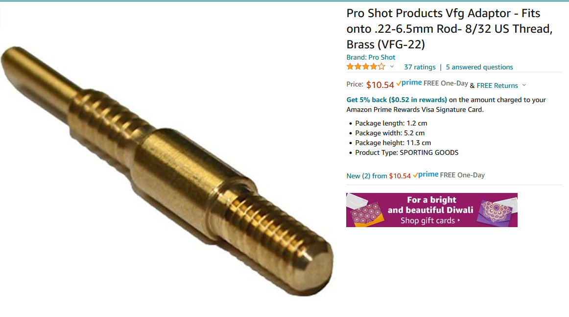

I just spent about $50 on 500 pellets and a .22 adapter. The pellets have a hole that looks about the size of a ball point pen ball, the adapter measures .160 about the same diameter as the 8-32 thread that screws into your rod. The pellets won't go on and if I can force them on they won't go down the barrel. Any help? Thanks in advance.

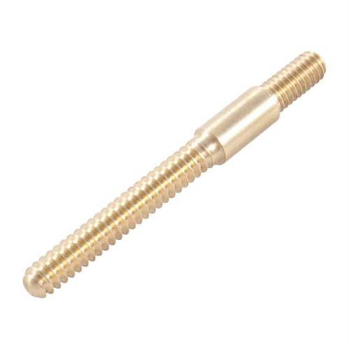

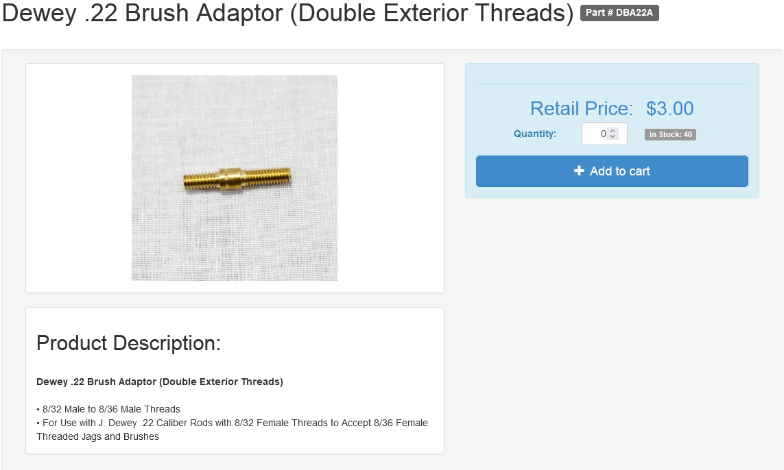

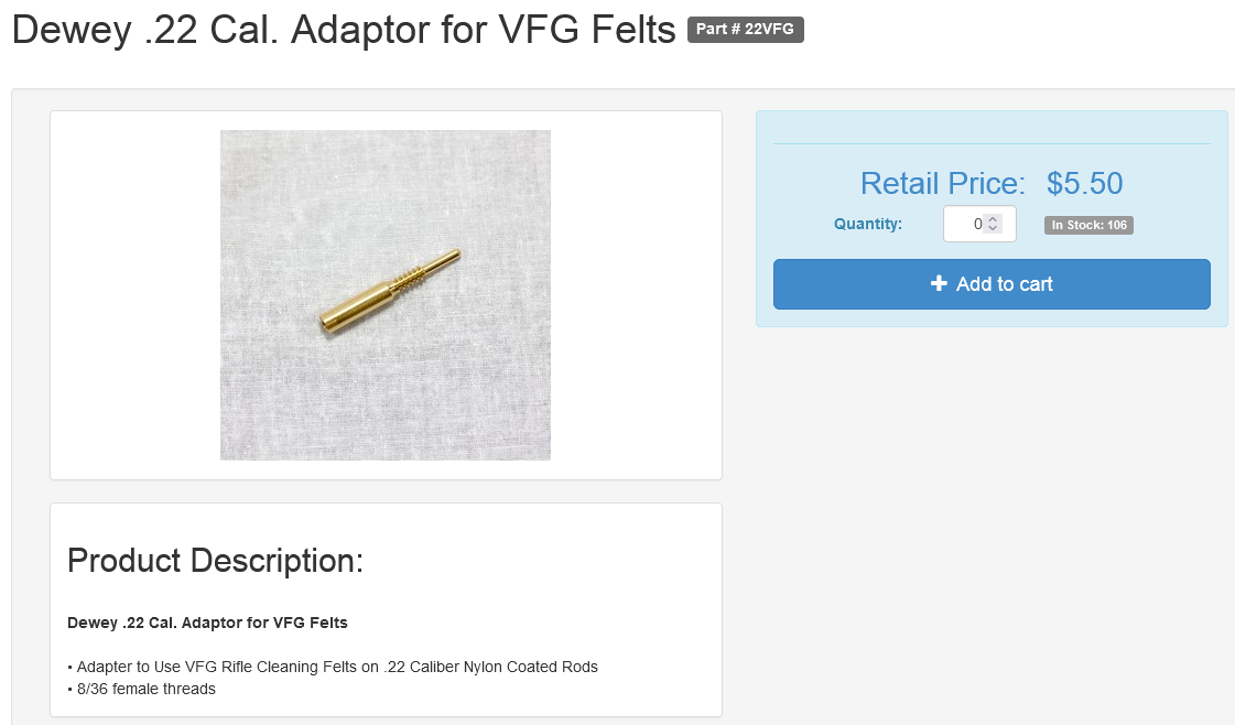

I use the Pro Shot Products VFG Adaptor, if you use the actual VGF made one you have to get a different rod because the threads are 8/36 instead of 8/32
