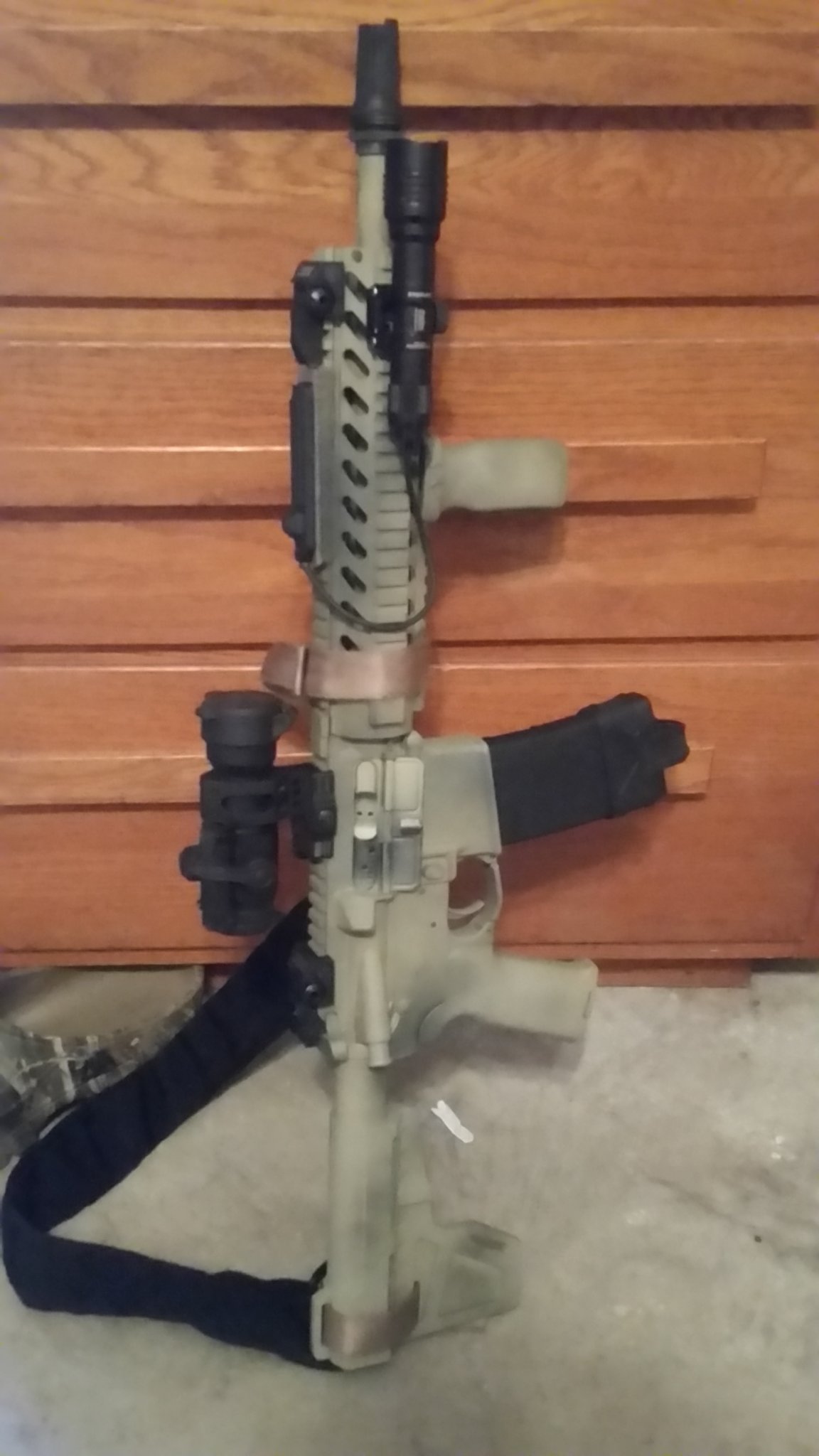

I run a 12.5 in pistol configuration. Shockwave blade, vfg, and oal of 27.5 make it a firearm. In essence, a pistol with no stock (brace is a brace), meant to be fired with 2 hands (vfg) with a length over 26" means it is not a pistol or a rifle. It is a firearm.

Yeah. ATF finally got back to me. They said end of bare muzzle or P&W device to the end of buffer tube. I figured SBA3 with law folder and a 11.5" I should be good for a vfg.
