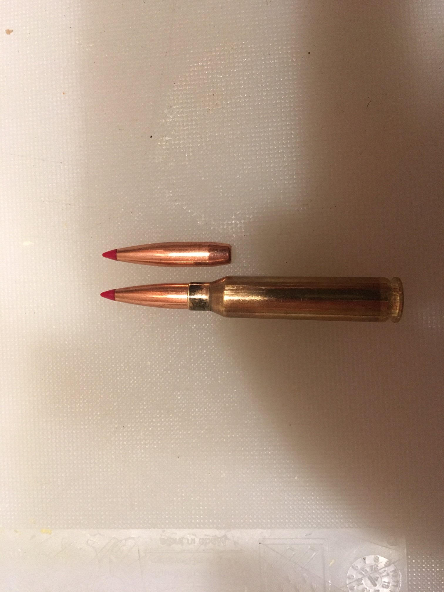

Overall projectile length between the Amax and the ELD-M bullets measured pretty much the same for me. By using the Hornady overall length gauge with the two bullets in our Savage 12, the ELD-Ms were touching lands about at a .050" longer overall cartridge length than the Amax. This pretty much verifies a more slender shape for the front half of the ELD-Ms vs the Amax. I was really hoping to get these 80gr ELD-Ms to shoot since the advertised BC is better than anything else on the market. Even the older 80gr Amax has a better BC than any other 80gr on the market.
I measured base to ojive of a dozen A-max and a dozen ELD-M and they only varied by about .005 average. I see more variation than that in a box of A-Max's.
