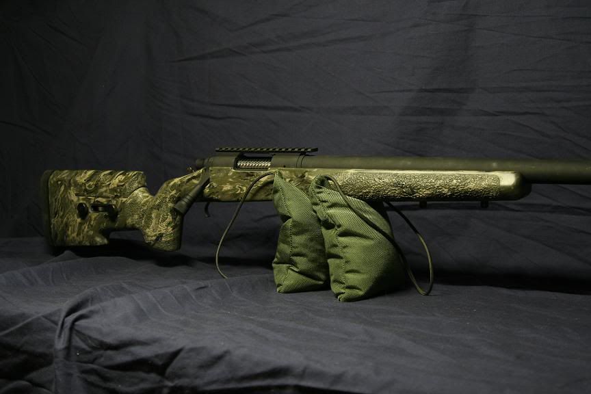

nothing wrong with using a 700 for a basis for a build, whatsoever. only receiver differences between models is action length and bolt face size. an ADL .308 has the same action as a CDL .243, although finishes may be different. if you're doing a ground-up build, though, finish is unimportant.
After a goodly bit of shooting, my 5r's throat got too long to use the magazine for 168 TSX's, so off came the barrel, and eventually I got a big box of awesome from Controlled Chaos Arms:

I like the color scheme on that stock. What is the color mix percentages>

That is a sharp rifle. If you dont mind, how much do you have invested?

Is that a DD Ross knob?
Re: Anything wrong with using a 700 for a starter?
yes, it's a DD ross knob, and while i'll discuss my salary online (i'm an e-5, it ain't too hard to figure out lol) what i spend on the toys is between me and mrs. ferret.
i will say that michael (CCA) gave me a fantastic deal and is an incredible machinist. hoping next sunday's range trip goes as planned; i'll be able to get to 300.
