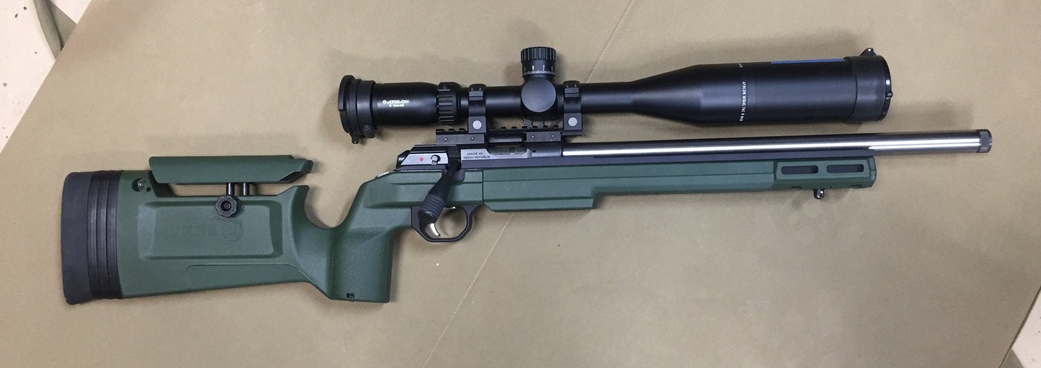

Current cz457 with athlon 6-26 tac and kidd 10/22 swfa 3-15set ups for Appleseed Note how far forward scopes are
View attachment 7532145View attachment 7532147View attachment 7532151
Good advice from Tiger S. on the scope mounting position when shooting from other than a bench. When I buy a rifle, I get an extended Piccatiny rail that protrudes in front of the receiver ring, giving me the option of getting the scope far enough forward. Factory "drilled and tapped" bases usually work only with the smaller 3x9 type scopes. YMMV

Wow, I got a closer look at the cz picture...you weren't kidding. That is super far forward! And its funny bc, I have actually been moving my scope further and further back. Good info to know.

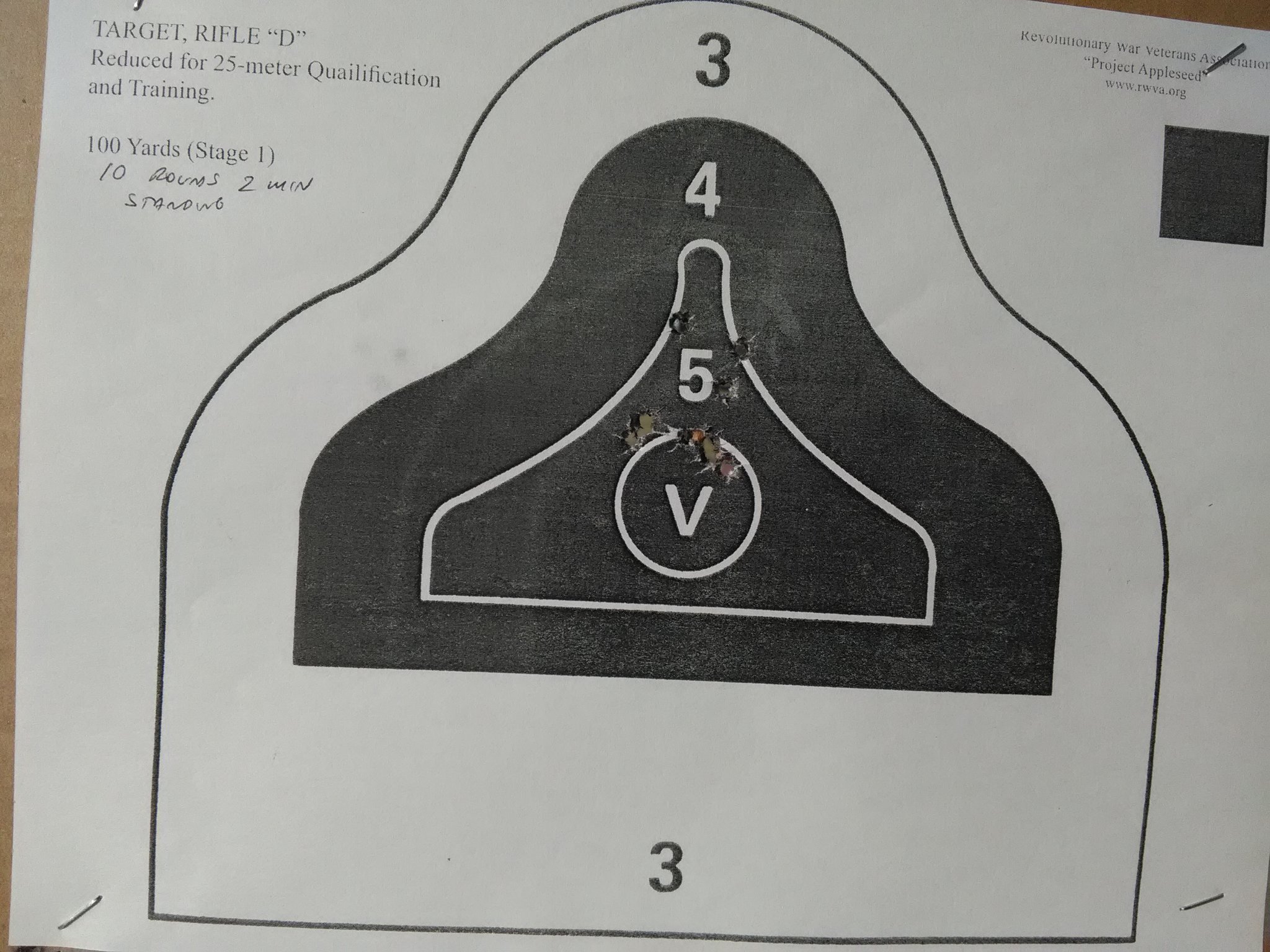

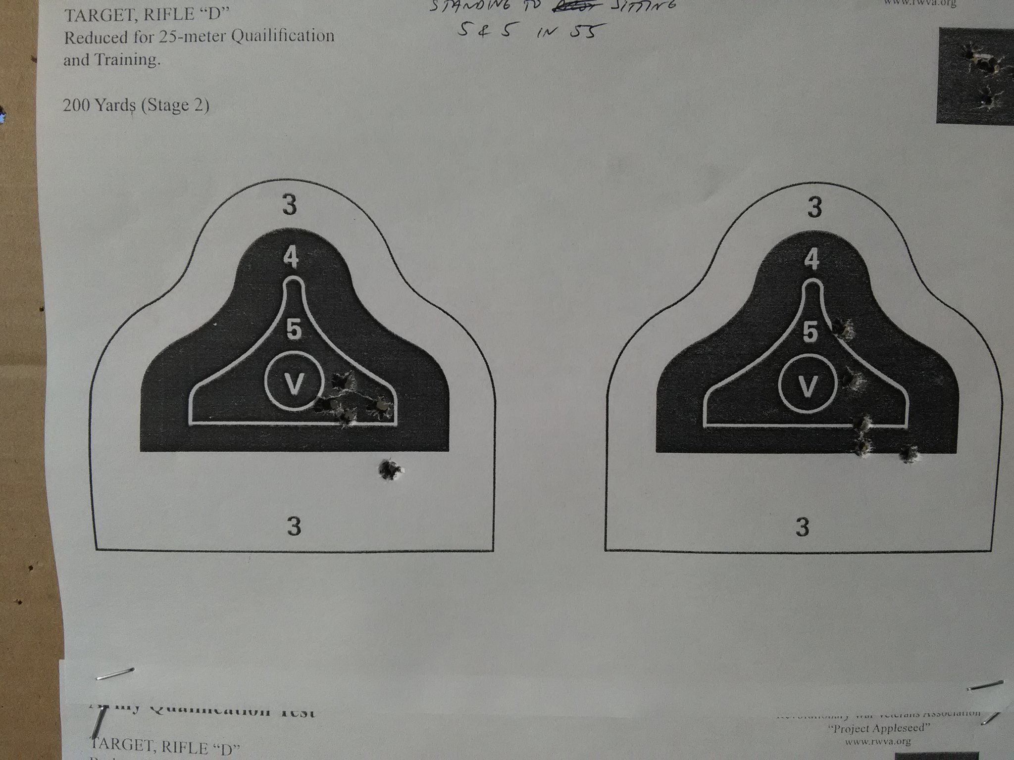

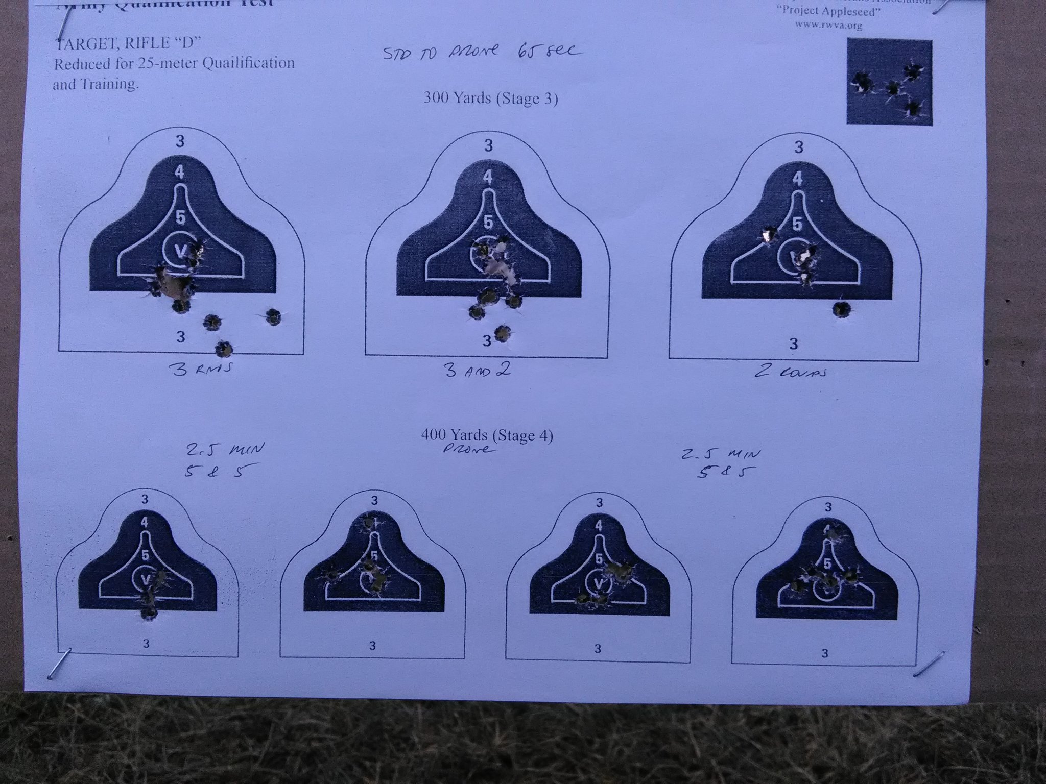

Sometimes I run the applseed CoF to stay sharp on sling shooting. Last time I did it back in Nov of 2019 I had a pretty good result.
All of these are at 25 meters on properly scaled targets and under the appleseed par times
Standing
Sitting rapid fire. I cant the shit out of my rifles to the right in sitting and forgot to offset NPA for it.
Prone rapid fire (upper row) and prone slow fire (bottom row). I ran the prone rapid fire strings multiple times.
All done with a 452 with a SIG Romeo5 reflex sight and a US M1 sling

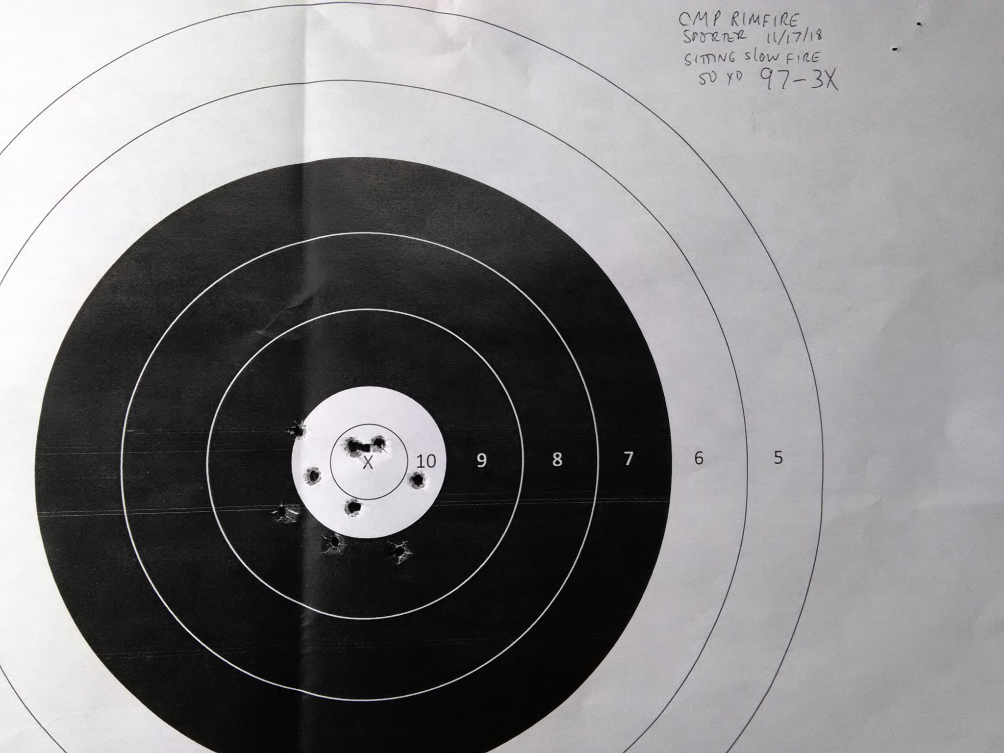

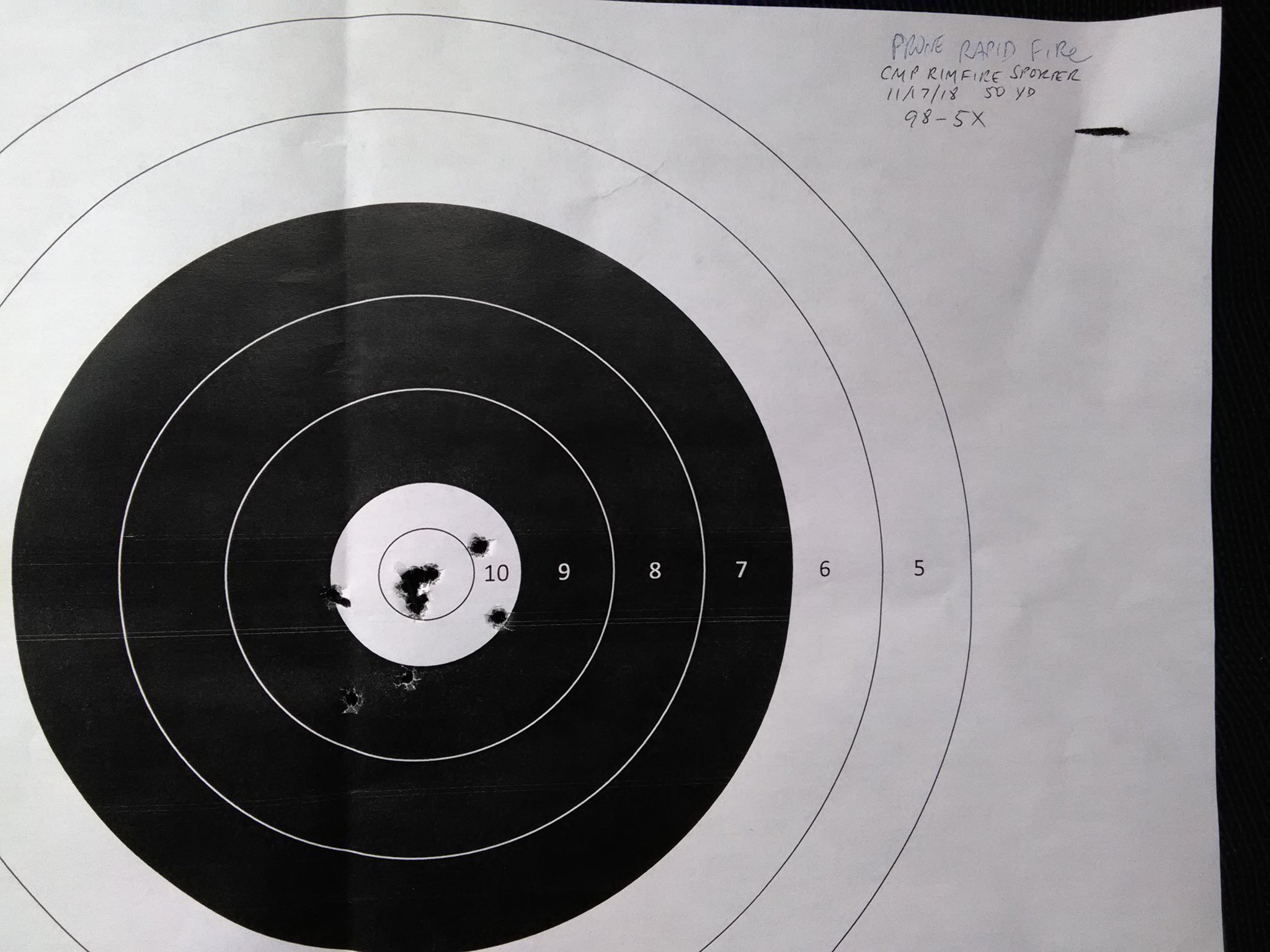

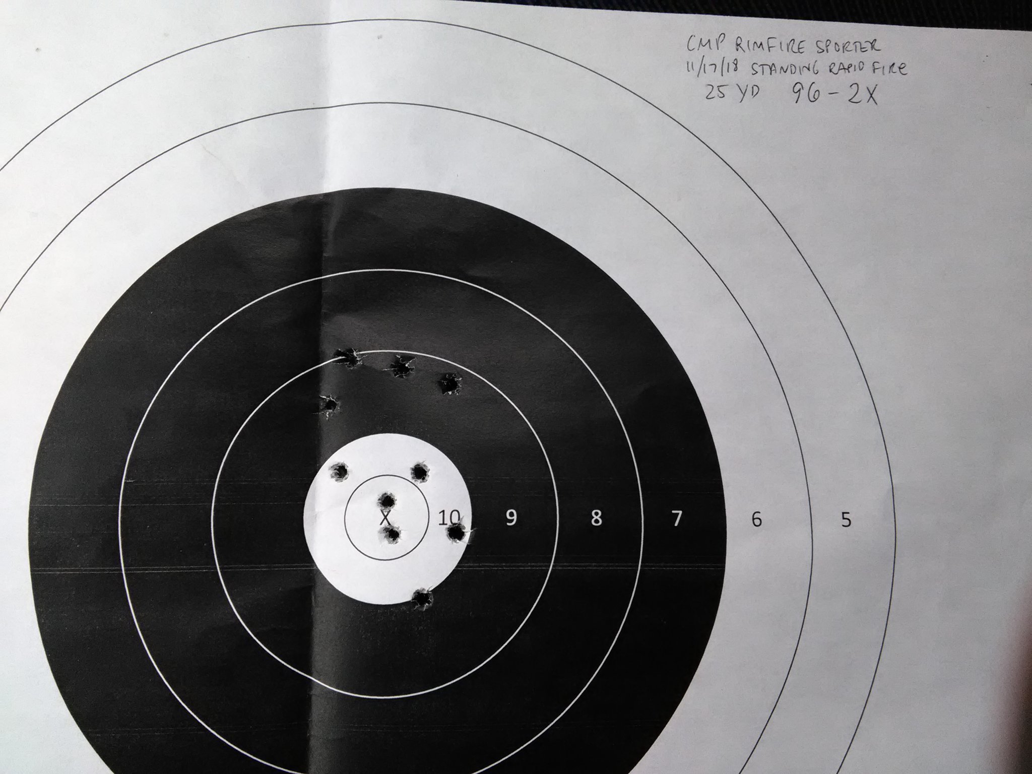

Another fun course of fire is the CMP's Rimfire Sporter match

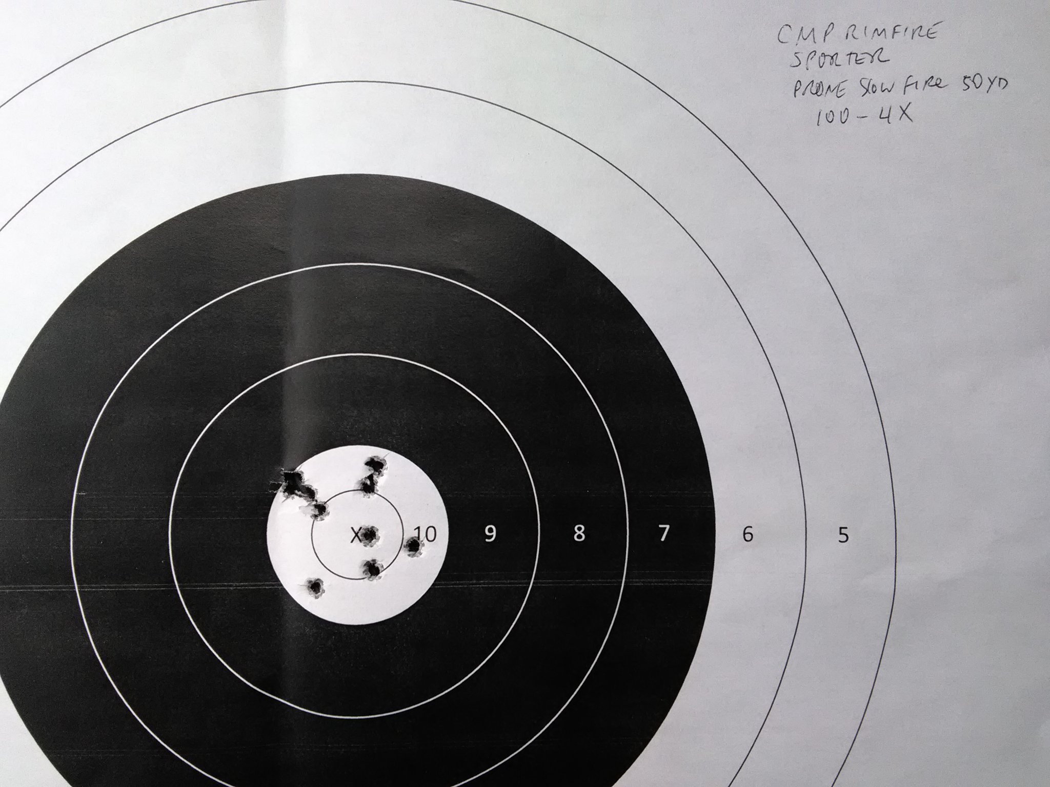

Prone slow fire, 50 yds
Prone rapid fire, 50 yd
Sitting slow fire, 50 yd

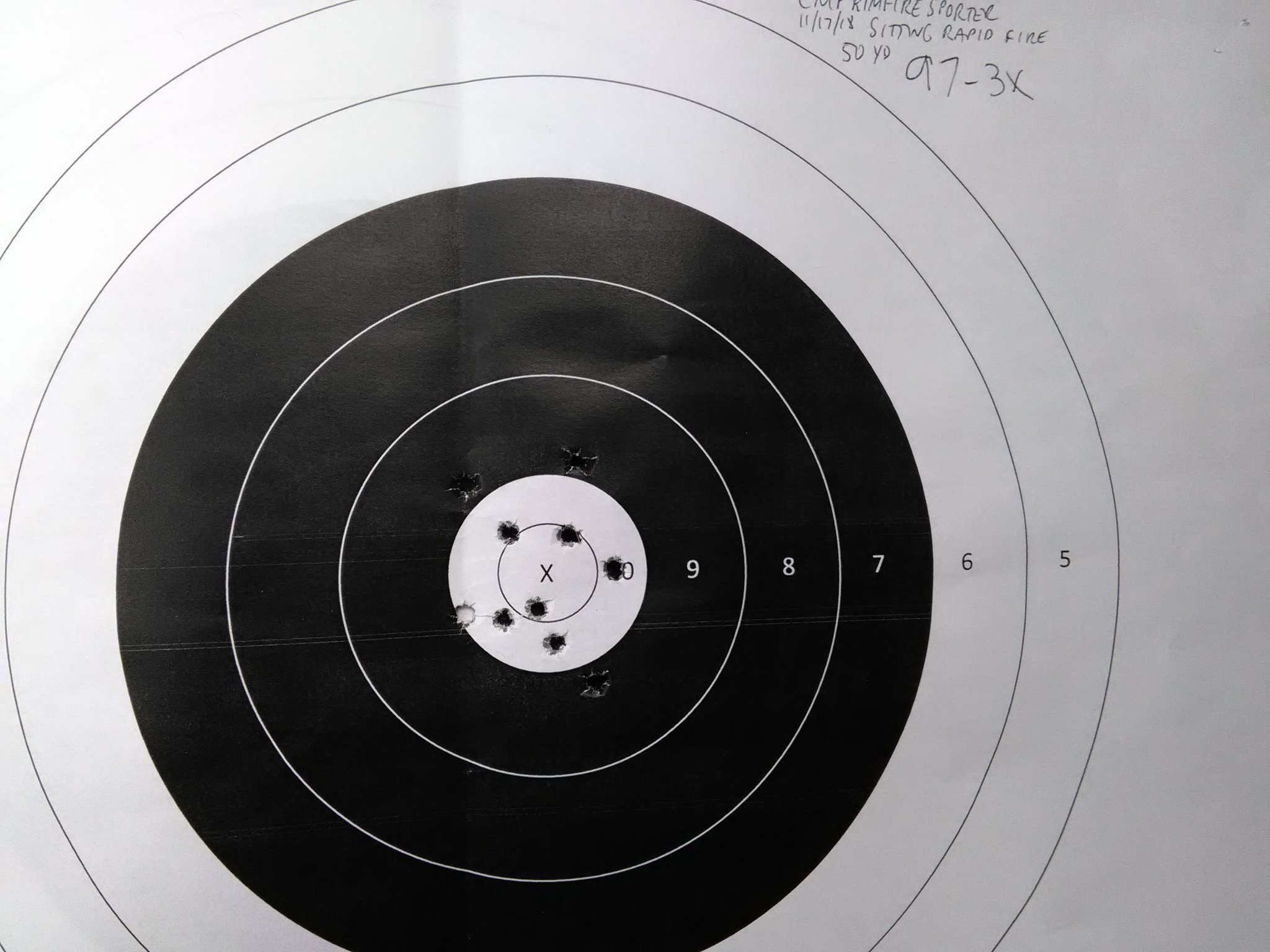

Sitting rapid fire, 50 yds

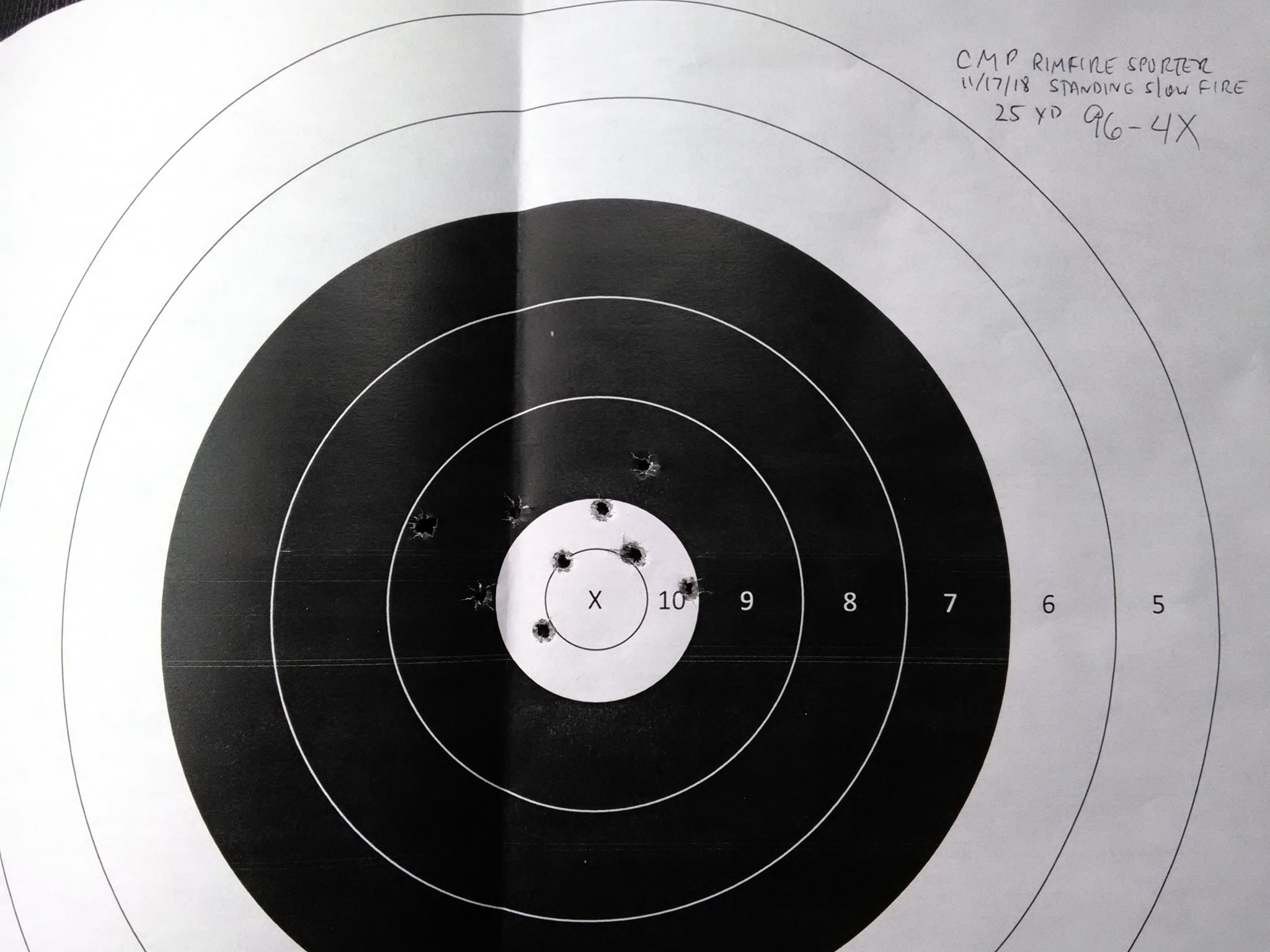

Standing slow fire, 25 yds
Standing rapid fire, 25 yd

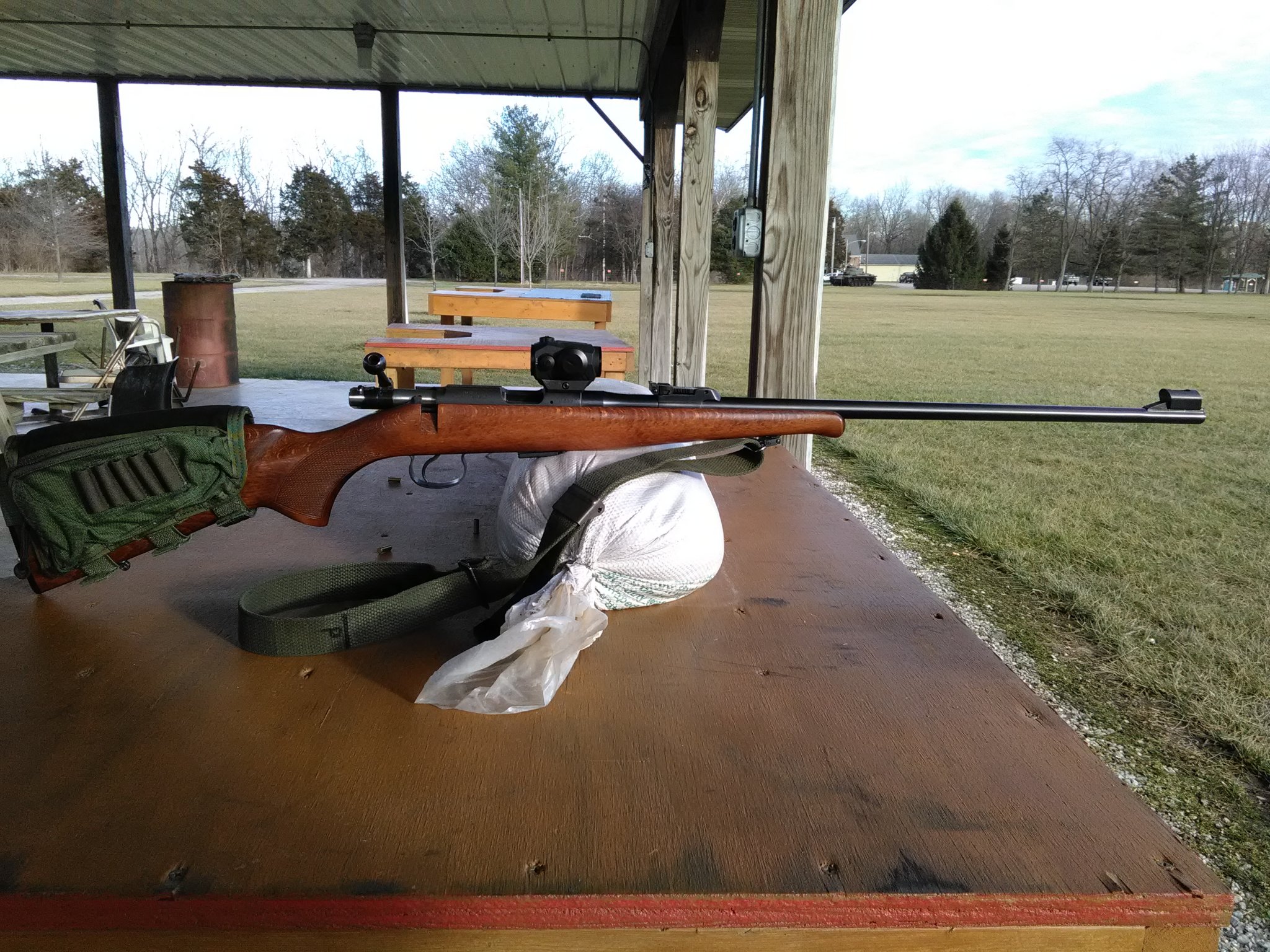

Same 452 with a red dot sight and a sling

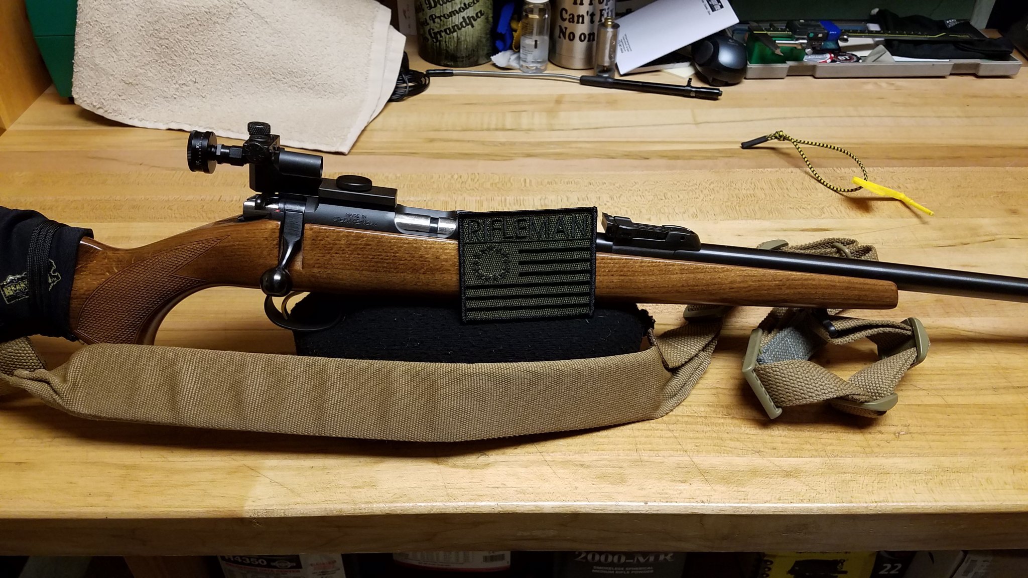

The event is most suited for 22lr semi auto if you like to get good score. I think any magnification higher than 4x will slow you down.

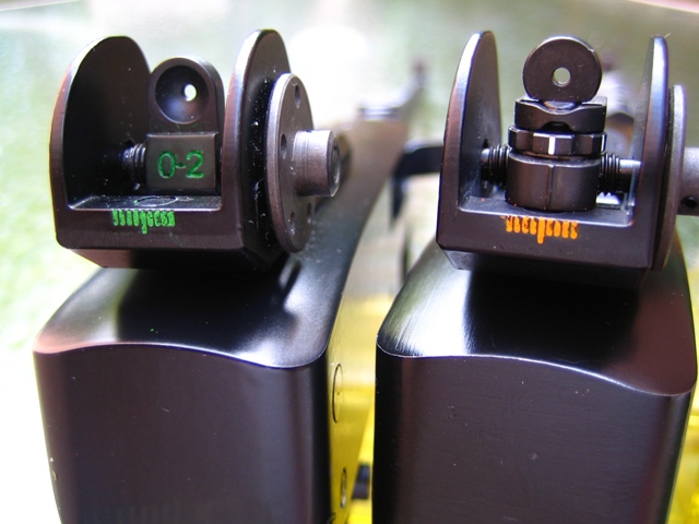

What sight is that? Does yours have the 10mm dovetail with the crowned top? I'd like to do something similar to my Zastava MP22.
The UL has the 11mm dovetail that CZ uses and that is a BRNO sight set that I was able to get from a fellow on Rimfire Central that has unfortunately passed. The sight has a larger dovetail and requires an adapter which he included.

I forgot to say, EXCELLENT shooting! Especially the standing and sitting/kneeling, 1st and 2nd stages. Those two stages kick my ass.

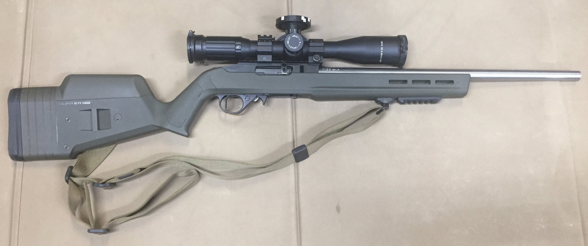

I just realized I didn't update this thread. I was able to obtain the rifleman patch on my 2nd Appleseed clinic. It was an awesome feeling, I got it on the first day...and Thank God. It was so hot that weekend, I even had three coolers with me.
For my second clinic I wanted everything as light as possible, so the bull barreled CZ with chassis stayed in the bag. I used a 10/22 and used the following gear:
-bought the Ruger modular stock, so I could get correct length of pull and cheek height. Its a neat stock, that I still use.
-I had to add an additional cheek rest to get appropriate height: Beartooth cheek raising kit. It was neoprene with interchangeable padding. It worked well.
-Kidd two stage trigger 8oz/8oz. What an amazing trigger. The extended mag release was nice. Probably my favorite trigger in my small stable of rifles.
-Kidd scope base. This was simple. On my cz 457, I literally bought every scope base out there and still needed more forward rail.
-I threw on a homeless TA33 Acog I had laying around. Despite the wonky AR height, it was the right call. 3x power was perfect. I learned the hard way about muscling around a heavy gun last time. The ACOG was my first choice for lightening up the weight of the gun. I had to nearly tape off the whole fiber optic because it was too bright in the summer sun. I know ACOGs are outdated, but damn the glass is good. I was worried about parallax, but it was a non issue for me.
-I bought a bunch of the clear 10/22 magazines on the advice of others on various forums. The clear magazines were helpful for getting the prescribed number of rounds loaded.
-Maglula 10/22 speed loader...wow, a lifesaver. I am buying another bc I recently lost it and I realized how helpful those things are.
Not a "perfect" appleseed setup, but good enough to earn rifleman!

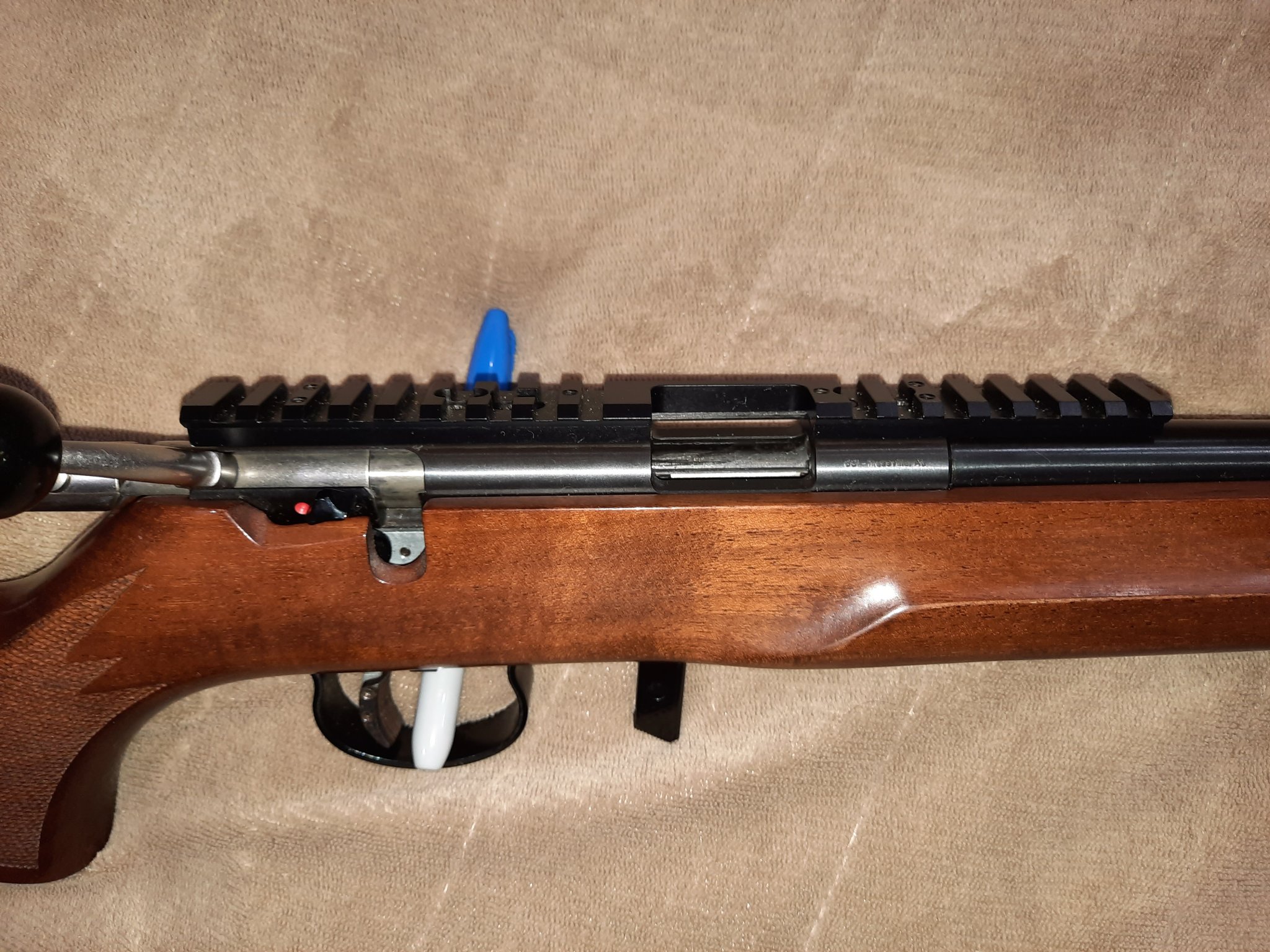

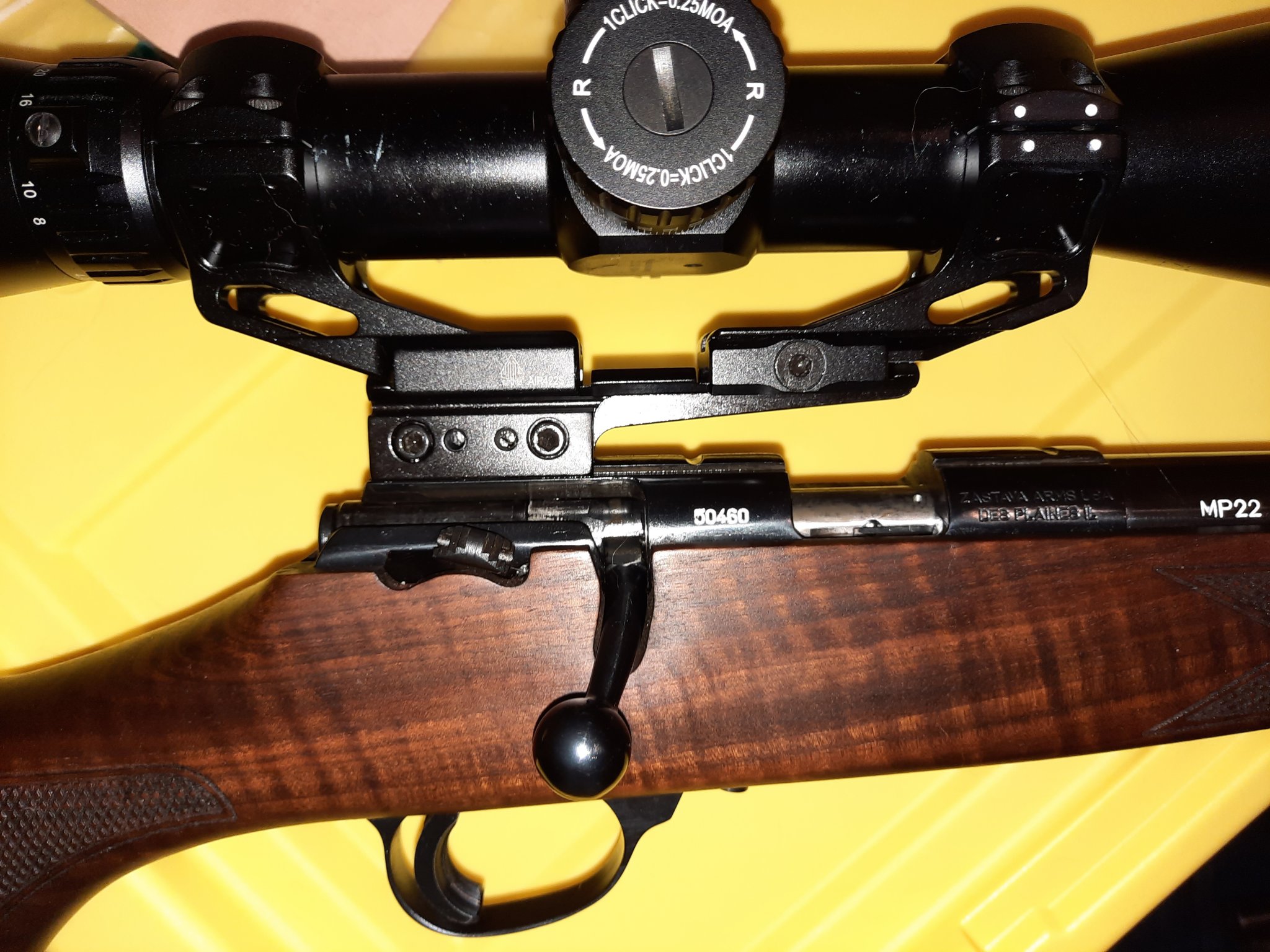

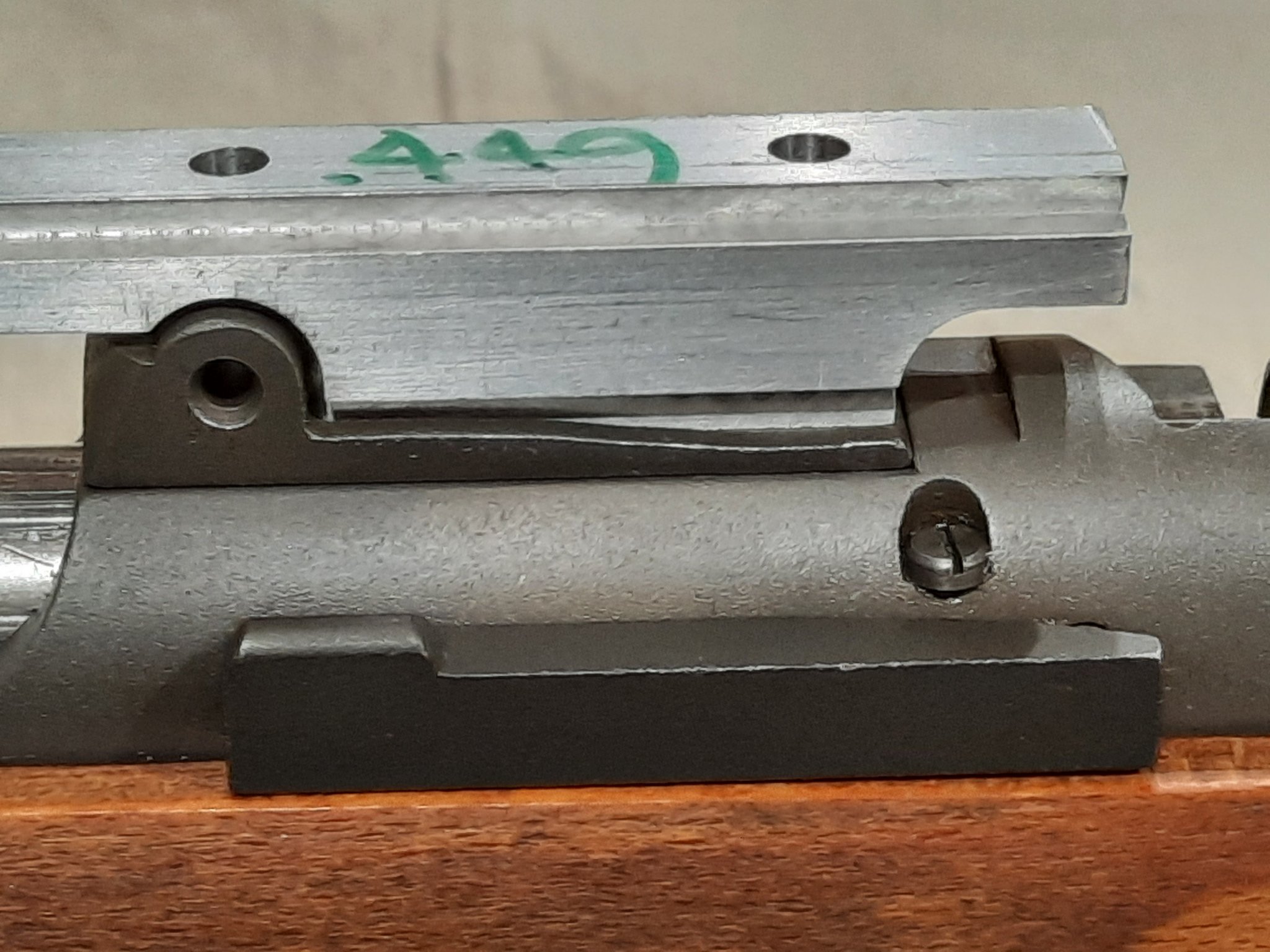

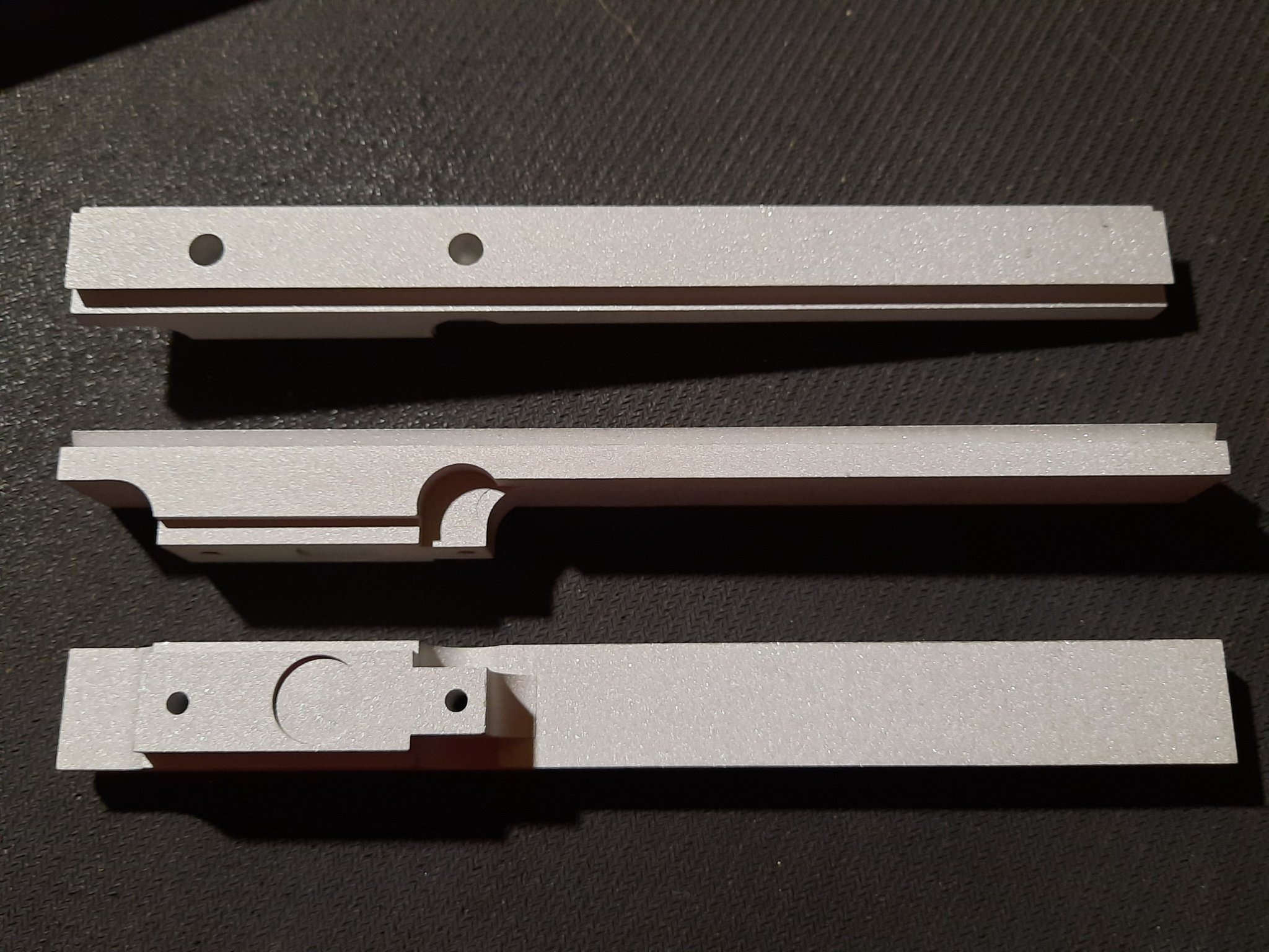

Keep in mind that they make all sorts of scope mounts and bases. I needed one for my 1945 MAS45 so I designed them
and had them made for me. I could have drilled and tapped the gun but I have never had to do that yet.

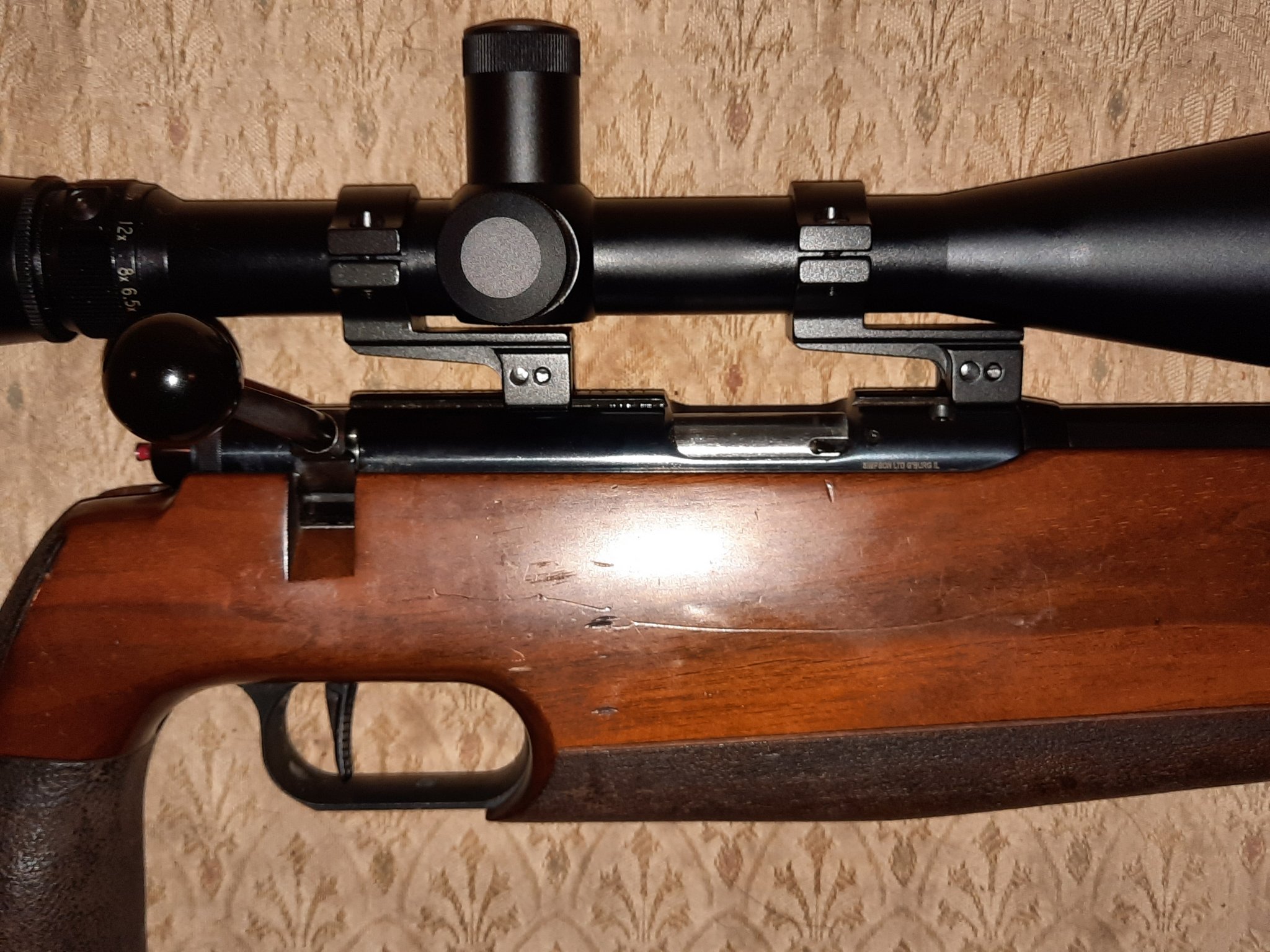

A couple of years ago, I wanted an Anschutz rail and Bob at DIP made me a longer rail and they added it to their standard
lineup. It's called the Scout.... It's longer out the back and the front. I tend to run my scope a bit farther back than most people
seem to.

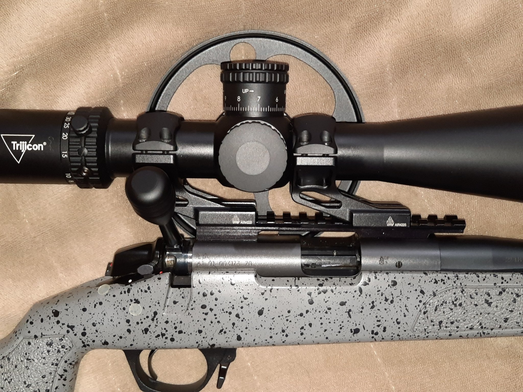

And the turret box on my Trijicon 5-50s take up a lot of space.

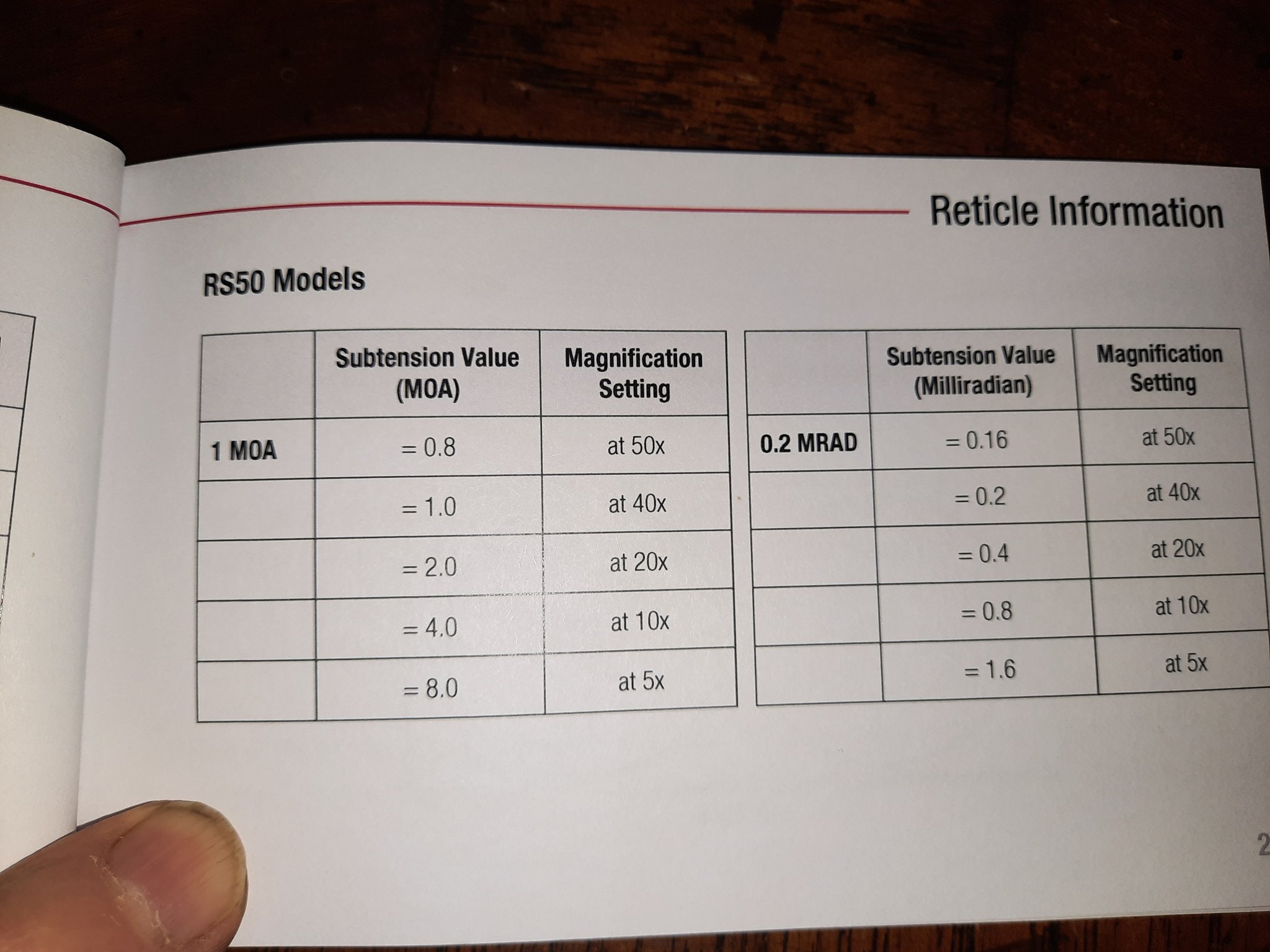

You can get over the magnification "paralysis" with practice. I have 50 power but use 40 almost always because of the reticle.
At 40 power, it reads at a 1:1 ratio internally. At different powers, you need to do a little math in your head. It is also labeled
inside of the scope so you need not remember it. It's odd to me that none of my other scopes mention the subtension value
changes with change in magnification. It's a regular SFP scope.
